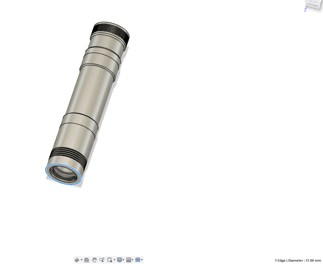

I’m making this light for myself, parts are currently otw to test my custom driver. Any thoughts on the design?
It looks nice, though the size isn’t too clear. What are the dimensions? Also, what are you planning on putting inside it?
Also, those edges look like they could be sharp off the lathe, I’m guessing you plan to smooth them manually?
Its about 80mm tall with 17mm outer diameter. I am going to call out fillets on the sharp edges so it is not too sharp.

Will it be a 1x14500 flashlight?
no im doing a 10440 although now that I am thinking about it a 14500 would probably fit pretty nice if i adjust a couple dimensions

Any plans for a pocket clip?

May I ask why the “gap” between the 2 elevated parts in the tail? Will it serve to put a “large” clip there?
Also, why the elevated “ring” with vertical lines in the tail?

The gap is the spot where i will mount the pocket clip once I have one designed. As for the ring with vertical lines I just like how it looks and imo makes it a bit nicer to handle.
