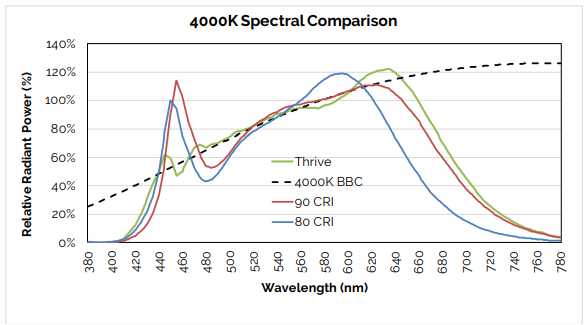

This is maybe the reason why no high power LED with completely filled cyan gap is available. There are some emitters around which has a partially filled gap (Bridgelux Thrive, I have some of these so I will test them in the next weeks) but they also have some sort of cyan gap.

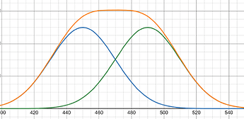

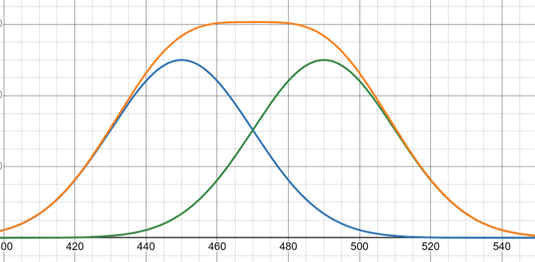

I think this might not be a huge problem:
  1. Having an additional 490nm peak is already a very substantial improvement over the existing phosphor mixes. I don’t know what component phosphors are used in emitters like 519A (do you have this info for some blue-pumped high CRI LED?), but it looks like a secondary peak (after the 450nm blue) doesn’t occur until 510nm or after.
  2. One might not need emission centered at the dip in order to fill the dip. Both the 450nm pump and 490nm phosphor will have heavy tails surrounding the peak wavelength, and there is a chance that the overlap of the 450nm’s right tail and 490nm’s left tail might suffice to fill the gap. Here’s a cartoonish, exaggerated illustration of what could happen when you add the two spectra:

For all visual purposes, I would consider the Thrive to have a completely filled cyan region–the difference is astronomical compared to other blue-pumped LEDs!

We will see how they perform, especially since they use a classic blue pump instead of a violet one.
I saw an interesting difference between the phosphor layer of Sunlike 3030 and Thrive LEDs:
The phosphor of the Thrive emits way more red light under 365 nm UV than the Sunlike, even in the warm CCTs. This is really interesting and raises the question on how much phosphor Bridgelux had to use to achieve this spectrum in comparison to the violet-pumped Sunlike.

Thanks for running the test! Since adding blue drops duv and adding green increases duv, I expected adding cyan to more or less leave duv unchanged, but of course that is a vague and unquantified heuristic, and 490nm is probably too close to green.
