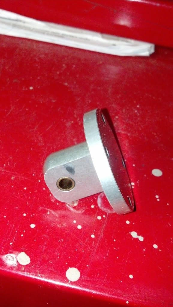

Here is my new mag headed work light. It was a harbor freight incandescent before. But it broke. The head rotates and pivots. It has an MC-E wired parallel driven by a 1amp cell phone charger. I used a Bimba cylinder mount for a pill. I cut 2 pieces of magazine bodies threaded end and used them to locate and lock the pill into place.

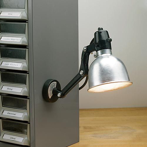

I took a foot long section of brass flexible gas line and mounted a harbor freight magnet on one end and a spring loaded clamp (for holding a flashlight) on the other.
while it works, people look at it and go, WTH is that?
yours looks like a manufactured product! nice job
oh yea!
Only tools needed for this one was soldering iron and a hack saw. It turned out nicer than I was hoping for. If I did it again I ghoul I could use snap rings instead often cut off mag pieces I used to locate the pill.

I have a spare pice that I made the pill out of if someone would like to do something similar. If I had more heads I thought about making a pair and hang them like manly pendant lights.

Very nice millerman. I hope the bimba cylinder was an old one. We use lots of these little pneumatic cylinders at work but i never thought of a light mount.
