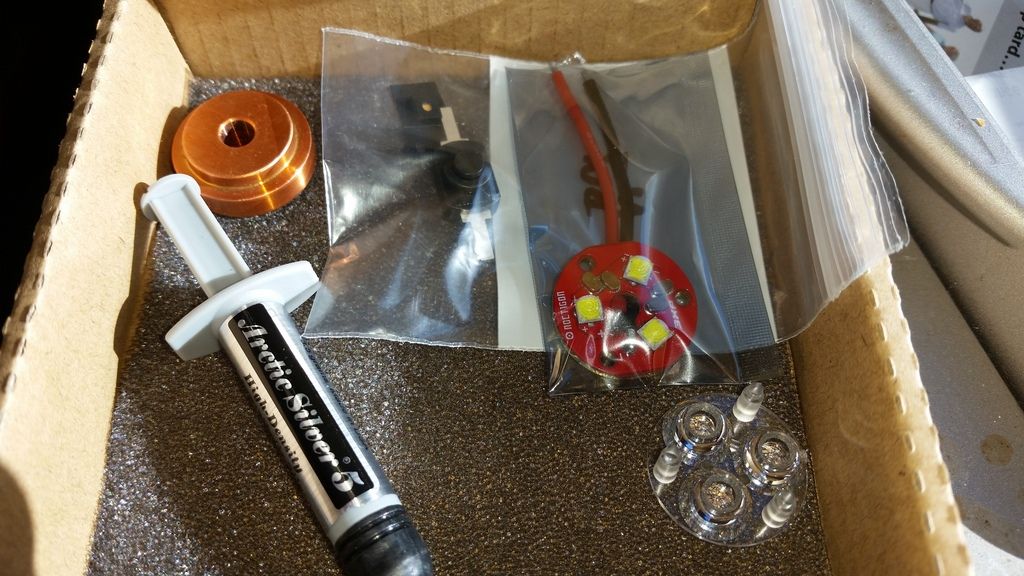

I got a package from Mountain Electronics today.
Copper Triple Spacer for Convoy S2+ Hosts - XP-L / XP-G2 / Nichia 219
3 CREE XP-L V5 2A LEDs on NOCTIGON 3XP COPPER MCPCB + JUMPERS
10507 Lens - 3-UP Narrow Spot Optic with Carclo XP-L Mod
And some other stuff for another project.

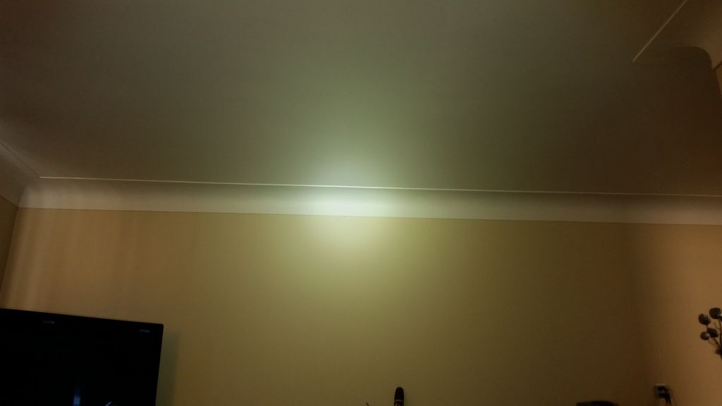

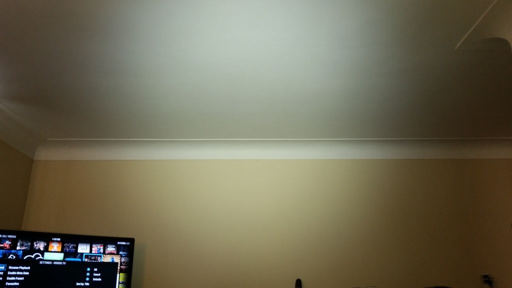

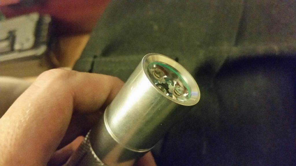

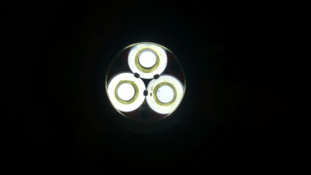

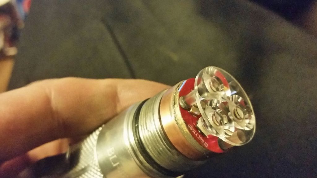

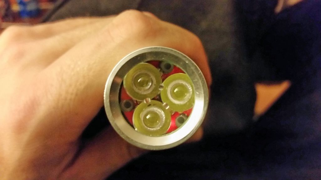

I thought I should add before and after pics
Before:
After:

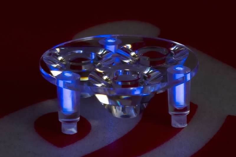

And once my tritium shows up I plan to do this
Nice idea with the trits. It ads another dimension to the looks. So the package you got from RMM was a complete kit to do this mod? It looks like it went together really well.
Well I already had the A6. So I wouldn’t call it a kit. But it did go together like Lego. I’ll be honest though, I was expecting it to be brighter. I’ve bypassed both springs but I’ll have to wait until my higher drain cells come in to see if that makes a difference.
Yes, awesome idea for the Trits in the optic.
