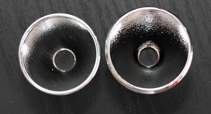

Comfychair, I got the FT 37mm SST50 reflector in today.
Here it is side my side with the T10 reflector.
The SST-50 on the left. Total height is slightly taller due to the outer edge, but to the emitter, I would say its the same.
Sorry, SST50 is now on the right. So it slightly wider, but not by much.
Outer diameter on the T10 34,5mm
36,7mm on the FT SST50, but I would say it has got slightly more edge.
All in all, these reflectors are very similar.
