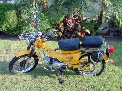

I’ll show you mine if you show me yours.
… Trusty 1978 Honda CT90 …
That is ONE Sweet ride weklund. Friend of mine has a red one, he won’t let it go.
Whats the black round box on the rear?
That is the original spare gas tank …
Swaaaeeet! Bike
