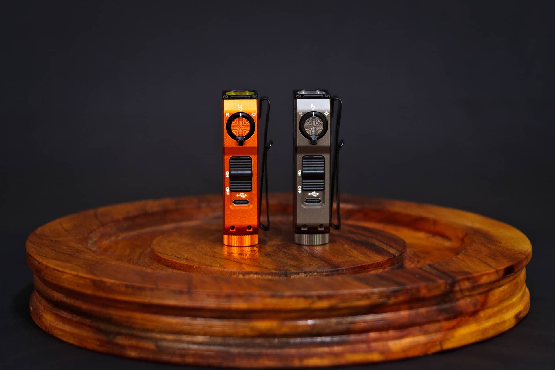

This is the Wurkkos HD02 Mini, a brand new release featuring 4 lighting modes: Cool white spotlight, 4000K Flood light, Deep red light and a 5000K High CRI wing light, all this powered by a single 14500 or AA battery, with a 3 color battery indicator.

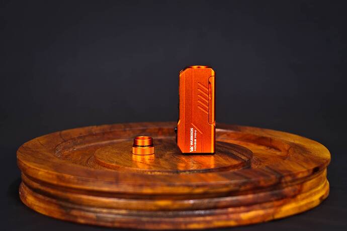

• Body and build quality
Anodizing Colors/Material Options: The HD02 Mini is only available in 6061-T6 Aluminum alloy with 3 anodizing colors: Orange (featured on this review), Blue and Silver Gray (featured on this review).

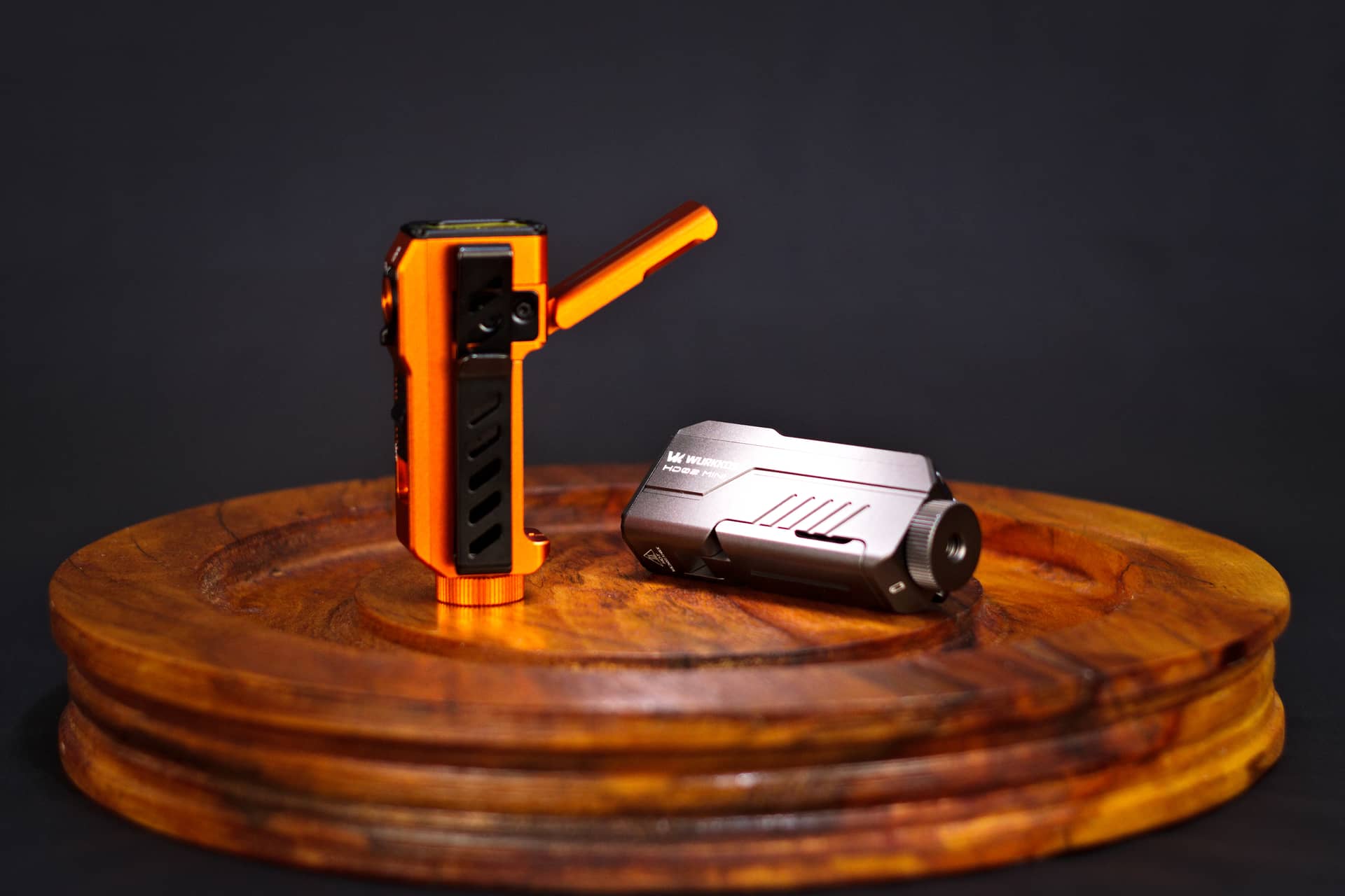

Main body/Grip: The main body is kind of bulky for a 14500 light, but I guess the amount of features it have compensate this. It has grooves on the main body and knurling on the tail cap, but it can be slippery, especially if it’s wet.
Material: Though not stated specifically, the main body consists of “aerospace” grade aluminum, which probably is 6061-T6 as seen on other Wurkkos flashlights.

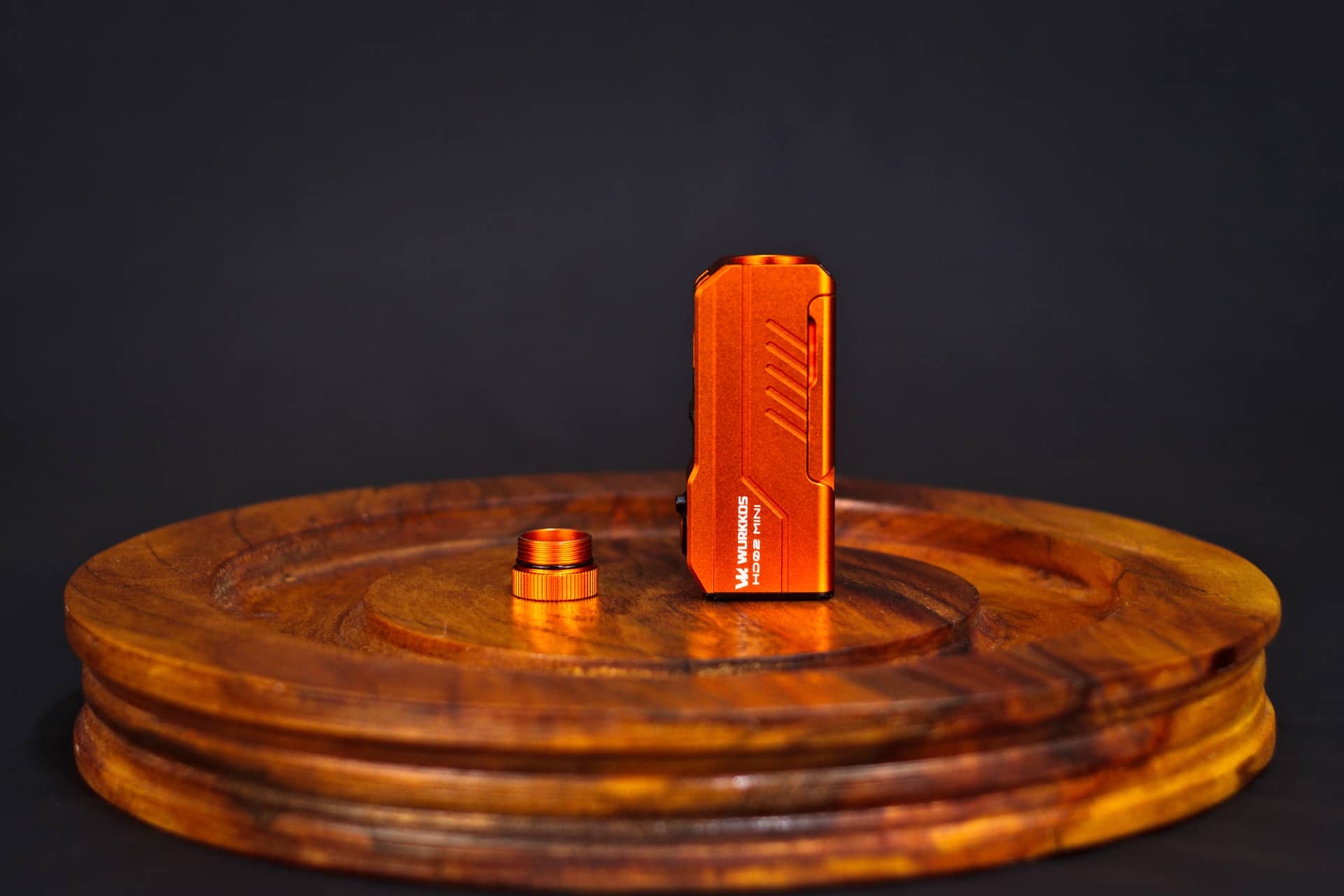

Threads: Only the tail cap has threads, they are trapezoidal and anodized, so it has mechanical lockout by unscrewing a little the tail cap. The head/bezel are held by 4x Torx screws.

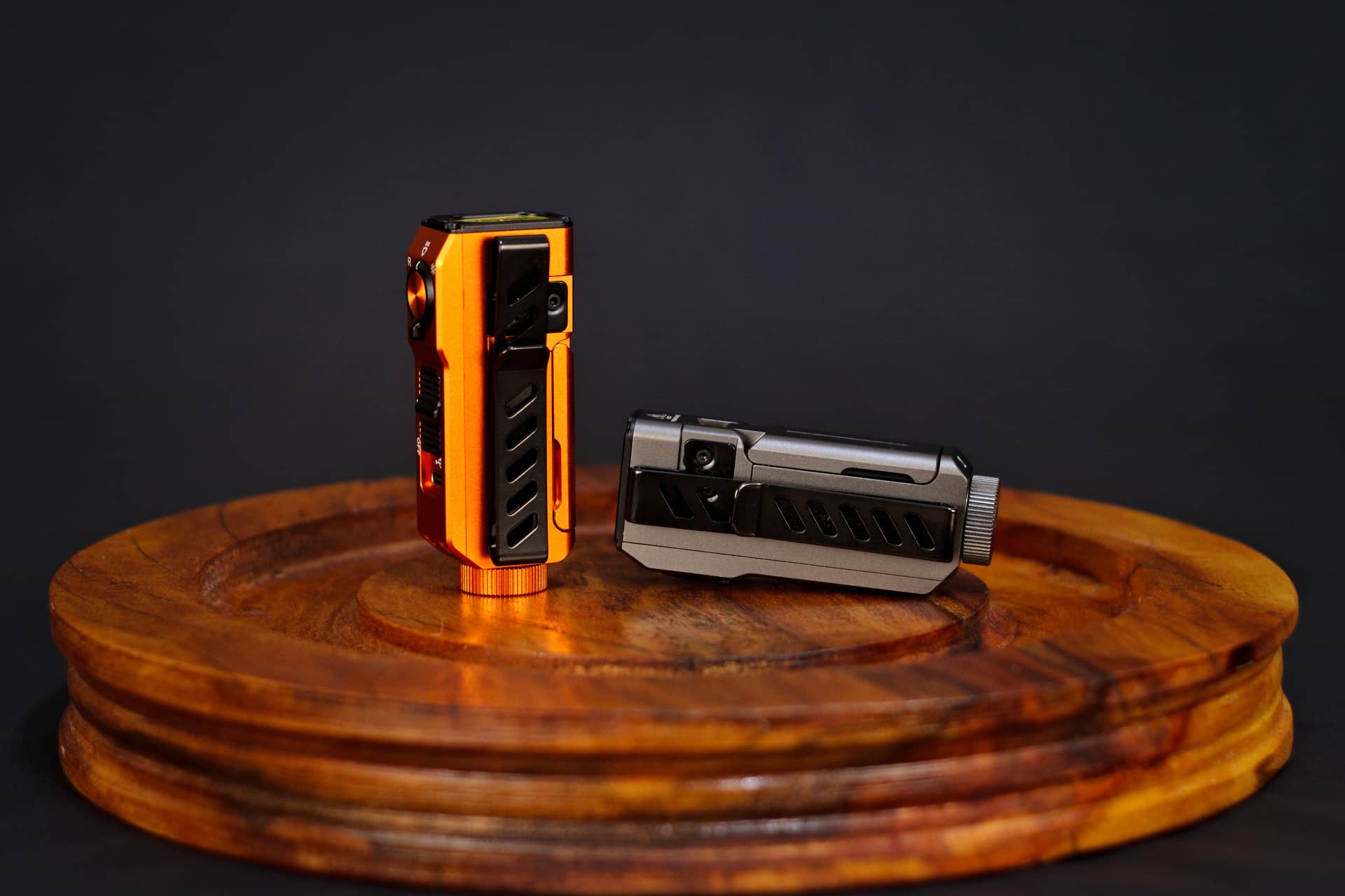

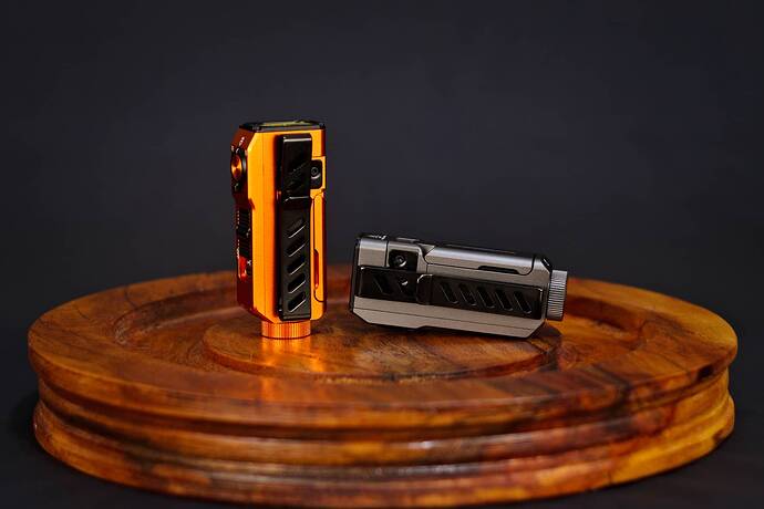

Clip: It has a dual side clip that is made of stainless steel and coated with a PVD/DLC-similar coating to improve resistance and scratch resistance. The clip is pretty big for a 14500 light, but this makes it able to be used as a deep carry clip. The clip is also held by Torx screws.

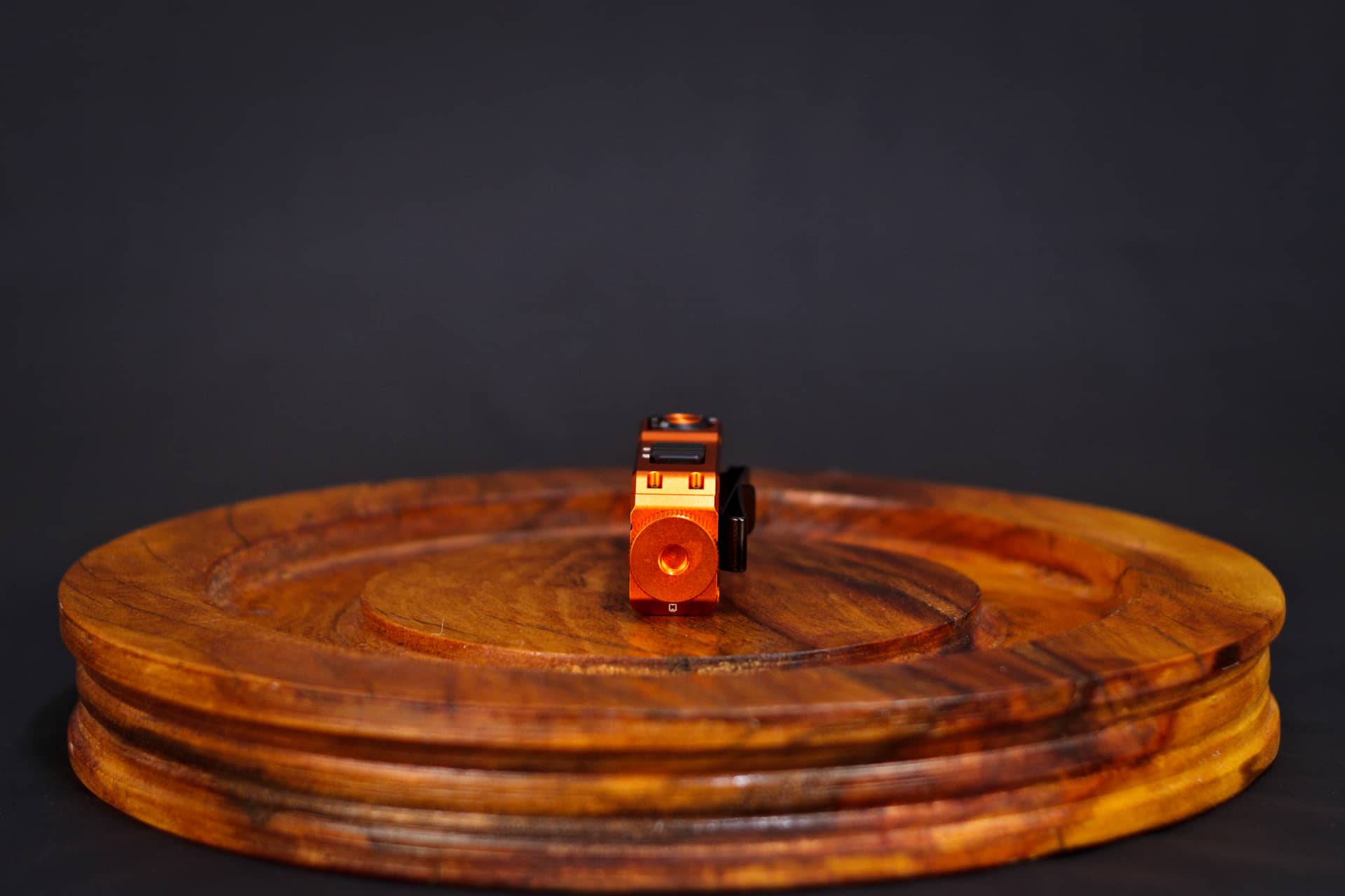

Tail stand and rolling: As the flashlight has a rectangular box shape, it doesn’t roll. It can tail/head stand with stability.
Magnet: The flashlight has a N52 magnet on the tail cap, it’s pretty strong and holds the flashlight weight on metal surfaces pretty well, just be careful when sticking it horizontally, as it can be knocked easily as the main body is a little heavy.
AUX lights: This flashlight doesn’t feature traditional Anduril-like AUX, so no RGB locator or fun RGB modes, but it features 4x main light types, one of them being deep red. Also, it has a 3 color bar battery indicator that is pretty useful.
Buttons: The HD02 mini has a single e-switch for turning it ON/OFF and cycling brightness levels, for changing the light mode is uses a magnetic rotary ring, which makes changing illumination mode pretty easy. The button is made of anodized aluminum as the main body and has grooves so your finger doesn’t slip from it easily. It also features a lock selector with the positions ON and OFF, ON means the flashlight will work normally, and OFF means it’s locked with only momentarily moonlight being available. Sadly, the main button doesn’t feature a raised ring to prevent accidental activation, but the main button is kind of protected by the magnetic selector.

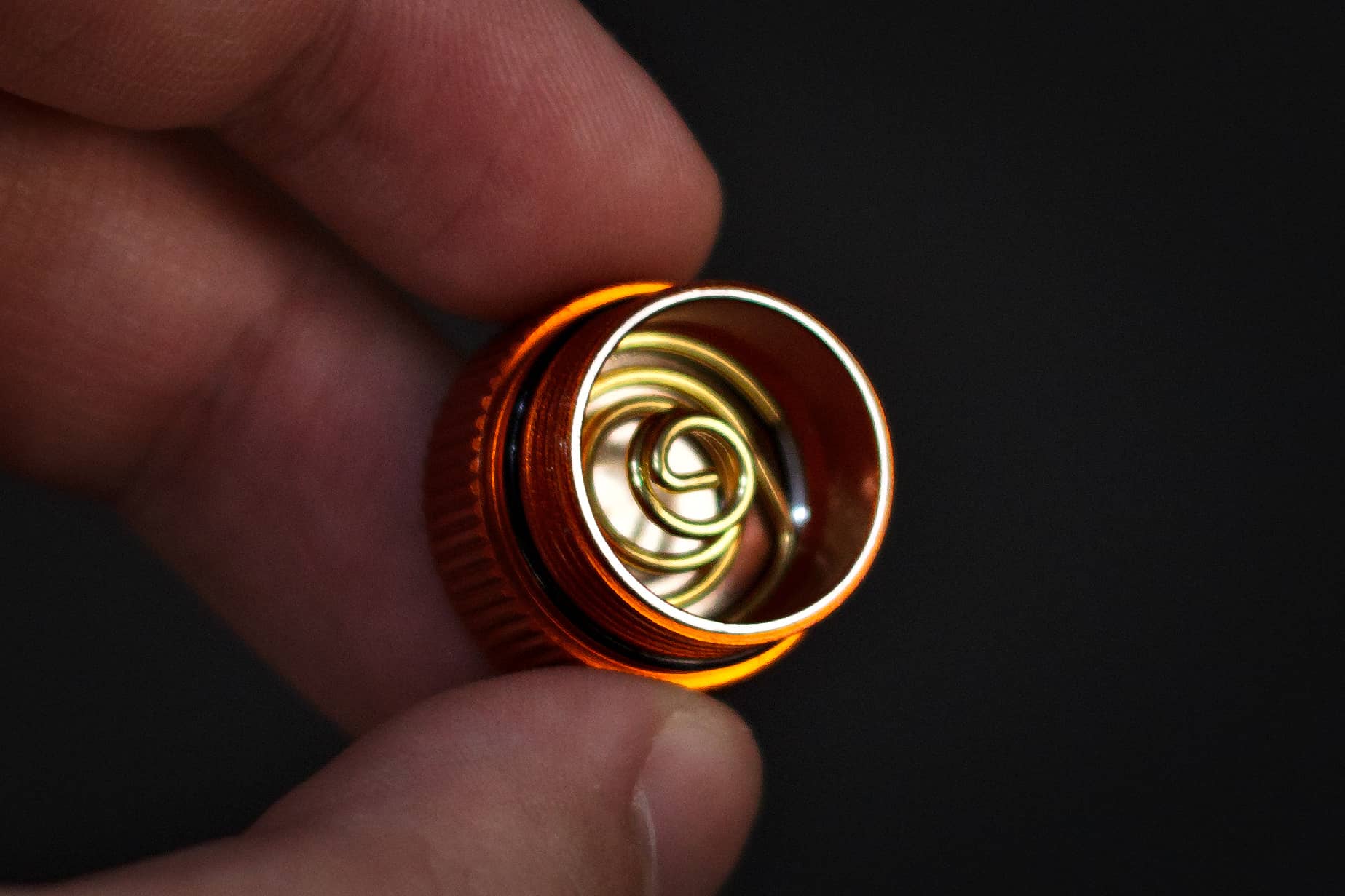

Battery contact: Contact is made with the battery by a gold-plated spring on the tail cap, and by a gold-plated button contact on the driver.
Bezel: A standard smooth EDC-like bezel is present on this flashlight, it’s made of matte coated stainless steel and held in place by 4x Torx screws.
Water Resistance: Sadly, it only has IP66 rating, this means it can’t be submerged, it can only withstand pressured jets of water, rain and similar things. Now one of things I dilsked most with this flashlight: The USB-C is totally exposed when in use, as the lock selector must stay on the “ON” positon for the flashlight to work, totally exposing the USB-C. The USB-C port itself is sealed/potted, but lacking a proper cover for it when the flashlight is being used is not good.

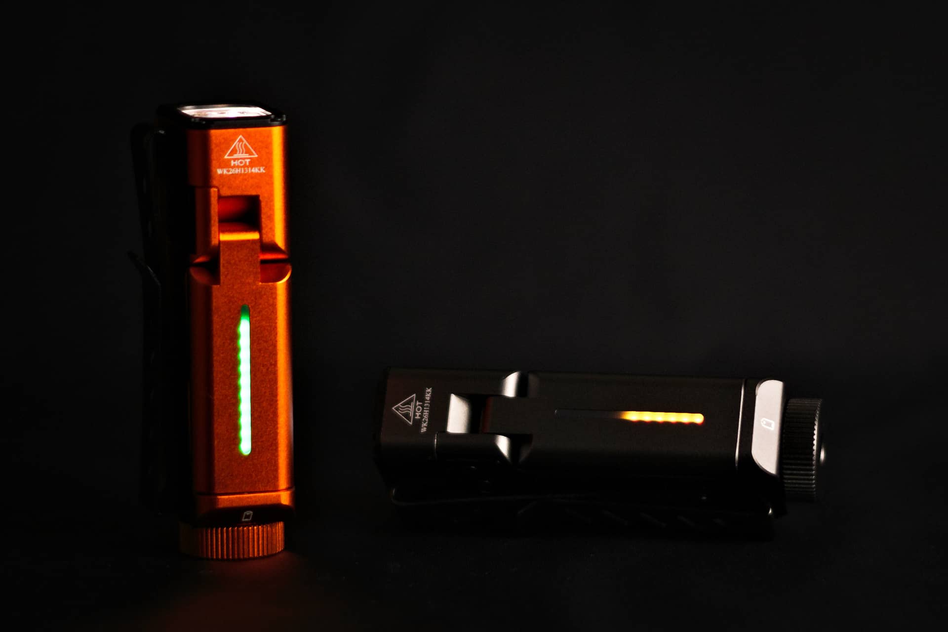

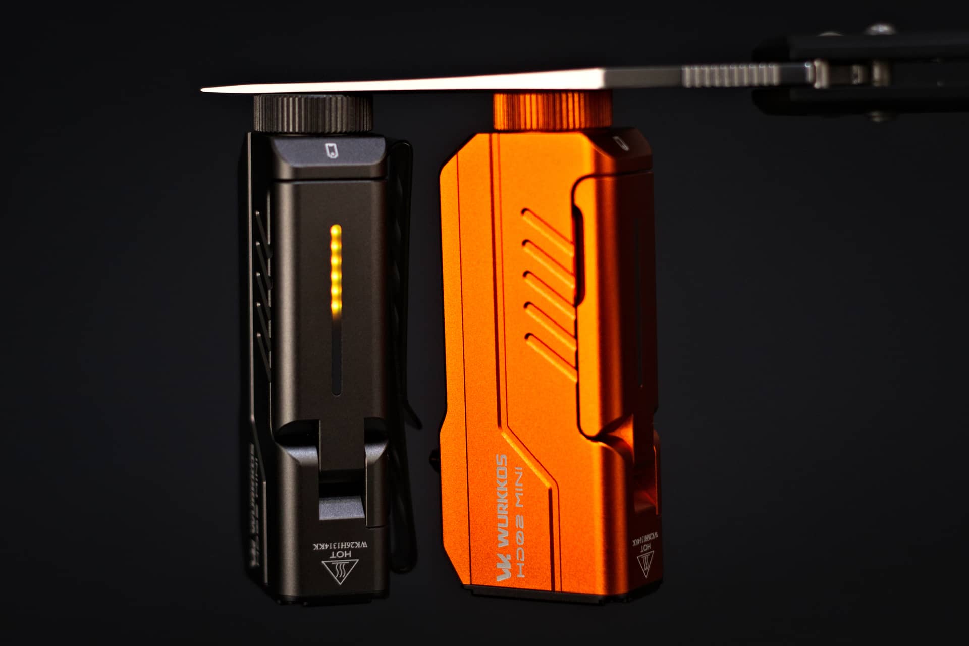

Battery Indicator: The battery indicator is one of the best features of this flashlight in my opinion, it’s a 3 color line battery indicator (Green, Orange and Red), the indicator consists of 11 LEDs lined up, when the battery voltage drops by a determined amount, one LED of the top will turn OFF, indicating the level by turning OFF the LEDs and changing their color when the voltage drops. I noticed it isn’t super accurate if you use the flashlight on high levels and try to read the indicator right after, as the battery voltage will have dropped due to current rising, so you need to give some minutes for it to read it again correctly - or just disconnect the battery by untwisting the tail cap and it will read right.
The color changes as it follows:
| Color | Battery level |
| Green | > 50% |
| Orange | 50% - 20% |
| Red | < 20% |

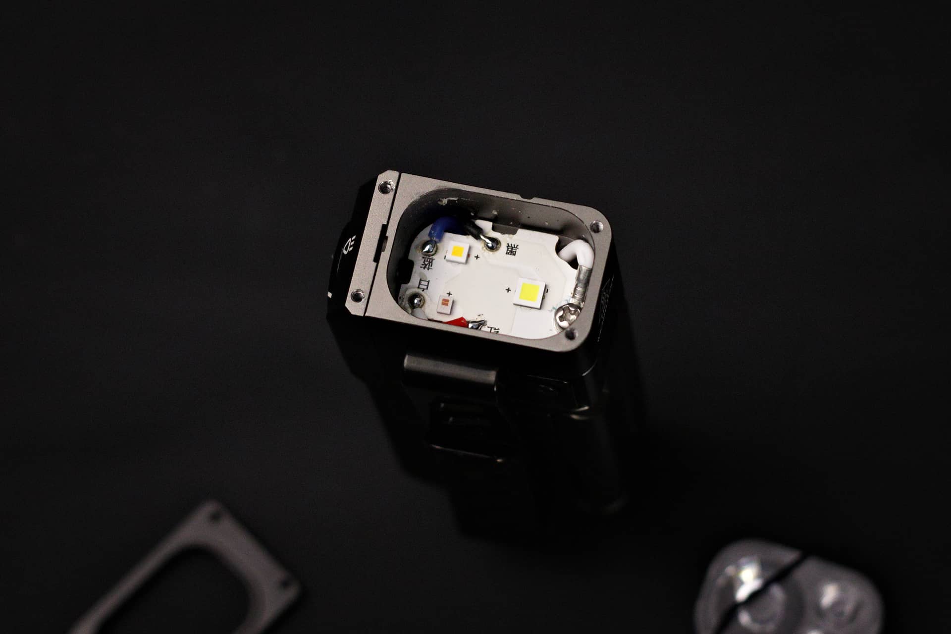

Emitter: Sadly, any of the emitters is stated by Wurkkos. It has 3 main LEDs, them being a 6500K “Spotlight” emitter, a 4000K “Floody” emitter and a Deep Red LED - the wavelength was not specified, but I measured the predominant wavelength to be around 640nm to 650nm on the Opple LM4, and a totally floody 5000K High CRI side light.
Lens: There isn’t any glass lens in front of the TIR, so the plastic is fully exposed and prone to scratches.
Reflector/TIR: It uses a 3 emitter plastic TIR lens with the 4000K and Red emitters having a floody TIR and the 6500K a more throwy one.
Beam profile: The beams are mostly clean and without artifacts, only the 6500K “Spotlight” has a little bit of artifacts, but nothing too bad.

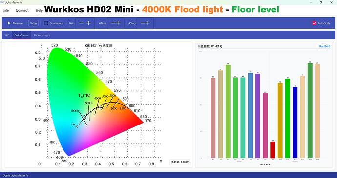

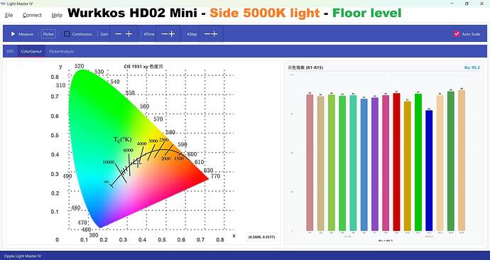

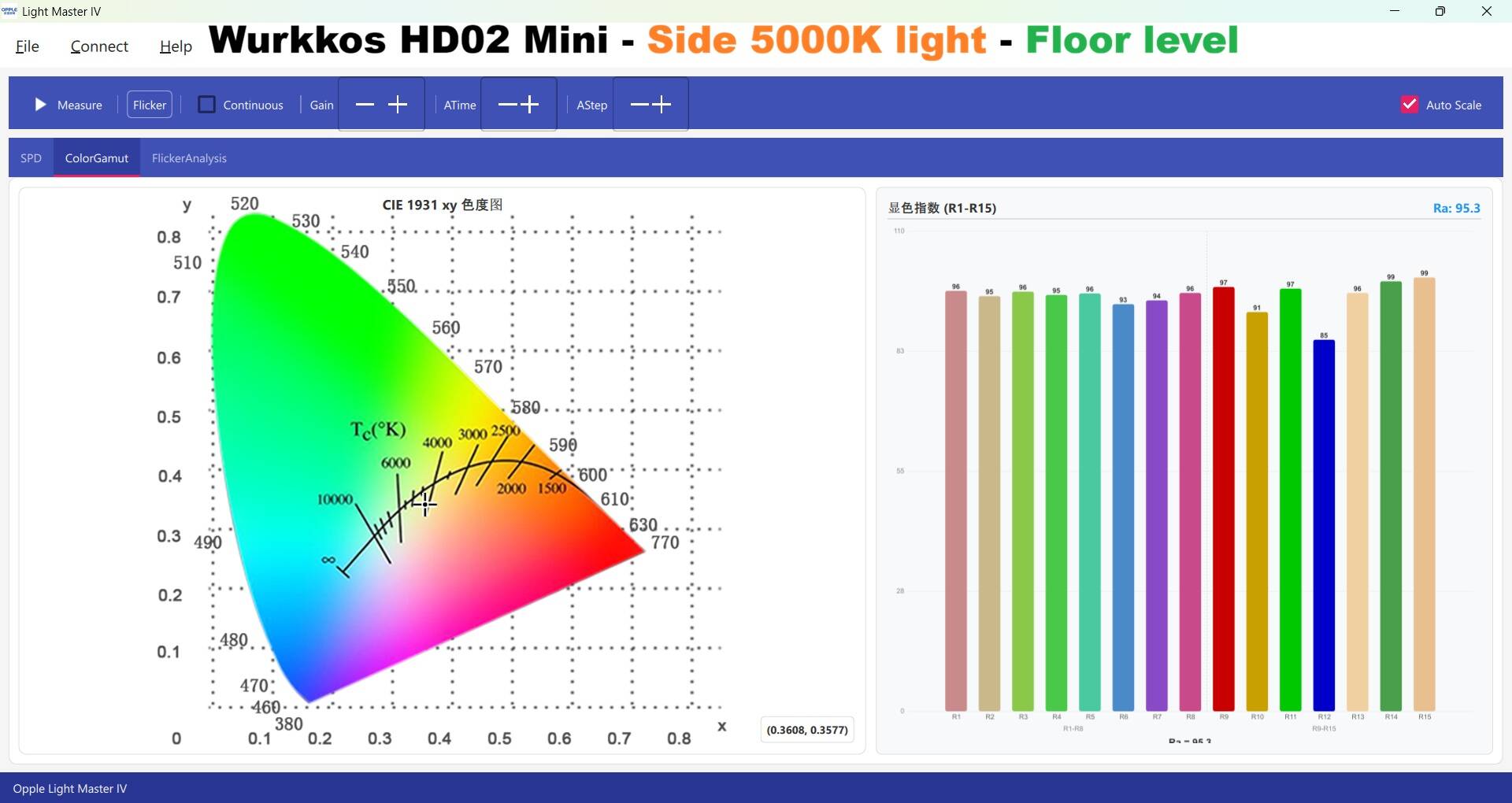

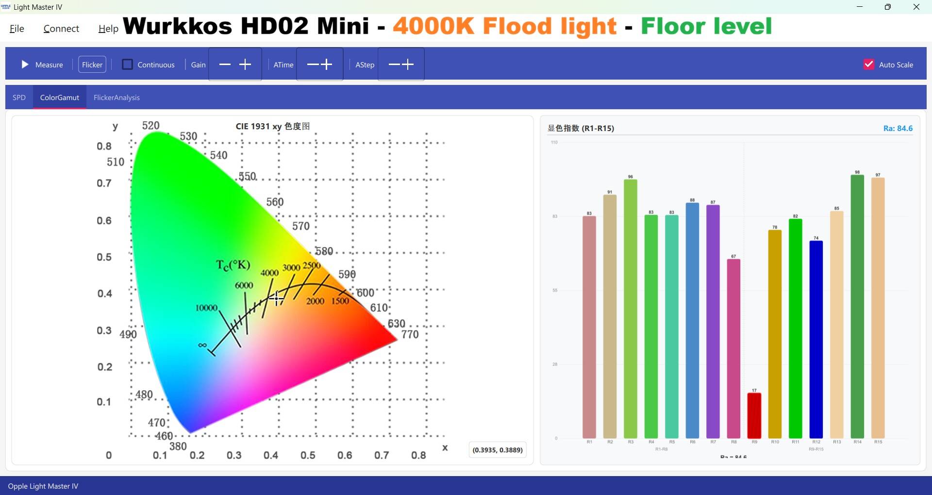

CRI: The 6500K light has standard, around 70 CRI; while the 4000K light has around 85 CRI with low R9, around 10; and the 5000K side light has very high CRI, around 95 with very good around 97 R9.
