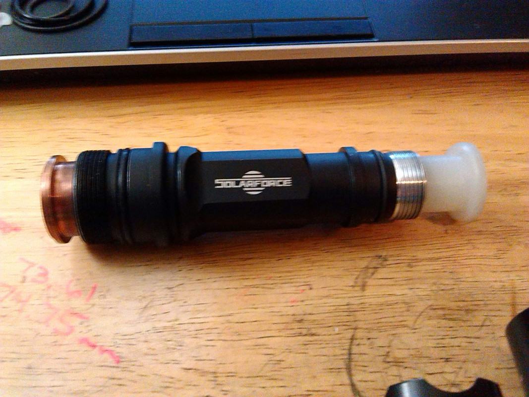

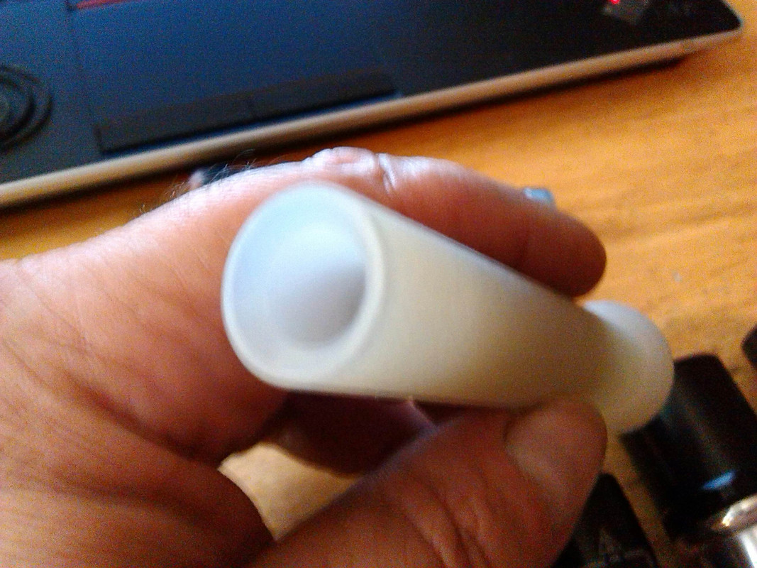

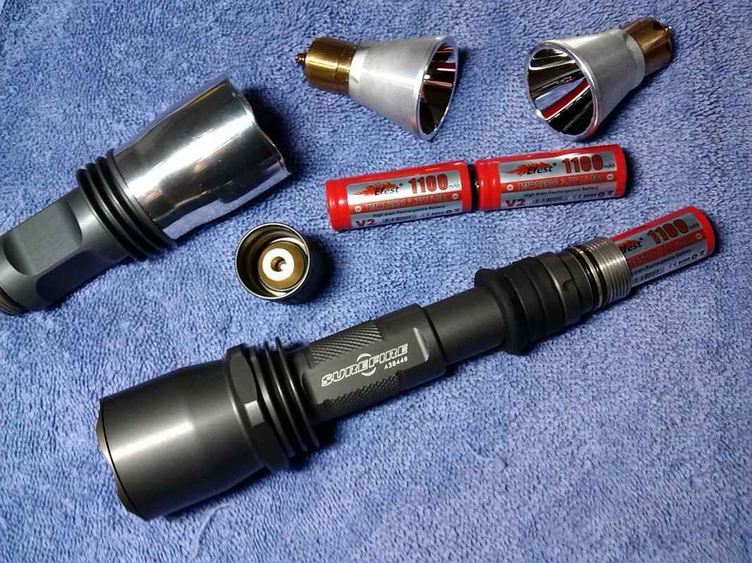

I have a few Surefire D26 (P60) Quad/Triples and D36 lights, bored out for 18mm batteries. Member kiriba-ru made me some over size Quad/Triple pills for my P60 builds. I hand fit them to a Heavy Press fit for heat transfer, got tired of copper wrapping them. Made a punch out of nylon to press them back out if need be…
D36
D36 thermal potted XHP70.2 @ 14+amps 2xAspires.

so if the dropin is a copper pill and really, really tight there are no/fewer thermal issues? Your solution with the nylon part looks great.

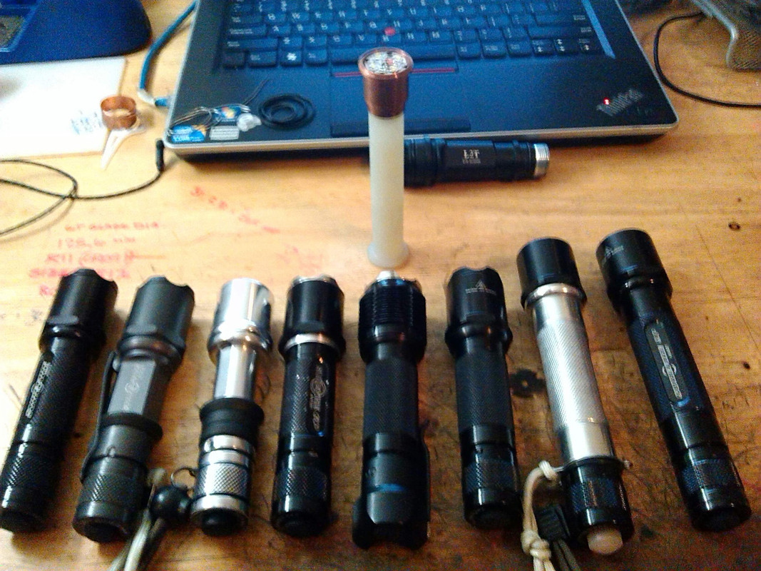

Typical P60 drop in measures 21.66-21.8mm by my examples I have on hand, the Solar Force L2T host diameter is 22.6mm, so quite an air gap, it may touch the host at the brass base or hanging up on the reflector itself, this will vary naturally from manufacture to manufacture of the P60 drop in and host.
Of course the more contact the better….and there will always be thermal issues with over driving LED’s, the P60 by design just needs much more help thermally.

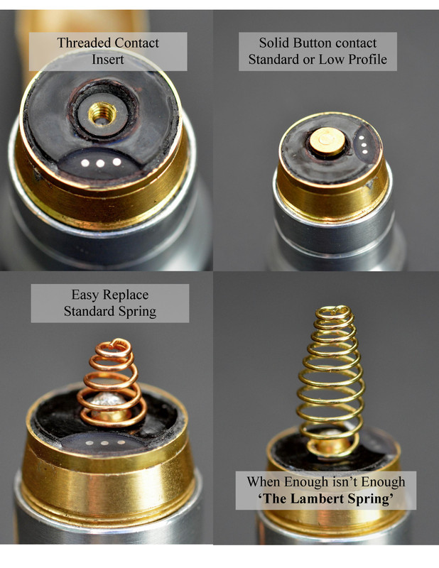

Randy Brogden, PFlexPro met back when he had only a E-Bay listing. He worked with me putting together some drop in’s for Surefire lights I was boring out for 18650’s. We had great fun, he even named a spring after me…he’s a funny guy…
He is the P60 Guru! :+1:
