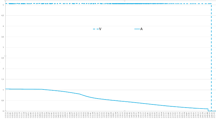

The battery capacity is 1800mah (ie 6.6Wh). A third more flows in, according to tester. So, with losses in charging, the capacity can be considered real. Well, the declared runtime of work converges too.
But it takes a long time to charge. 3 hours for 1800mah is too much.

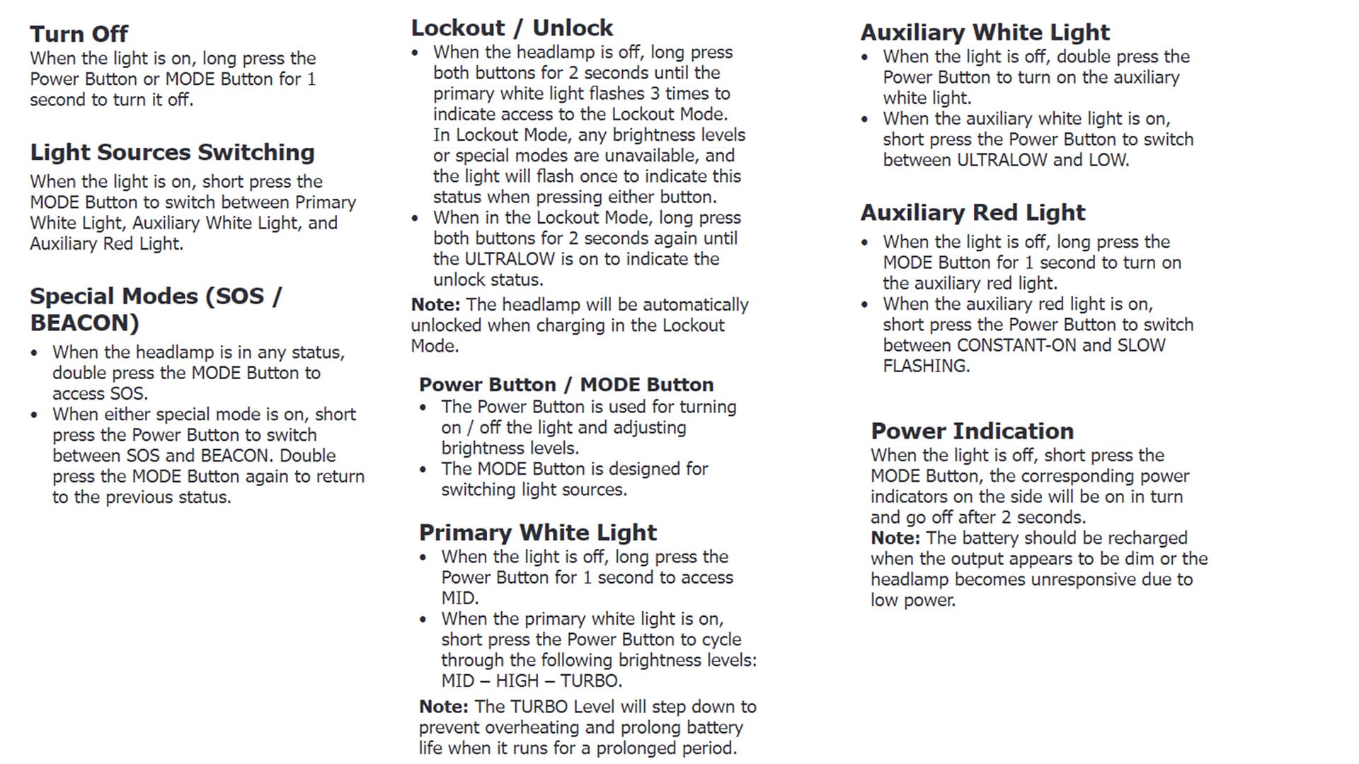

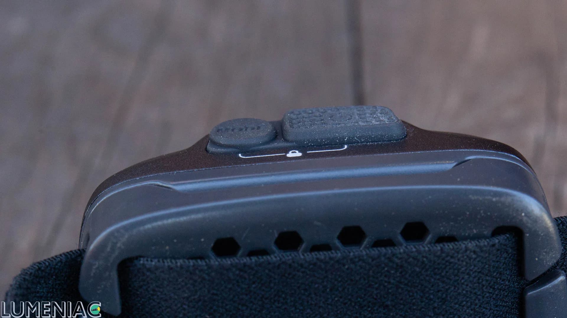

As far as I remember, all NU headlamps are controlled by two buttons and NU31 is no exception.
The only possible optic for this kind of headlamps is a plastic lens.
Behind it are: one main SST12-w LED in the center and additional middle and red LEDs on the sides of it. Nitecore does not report the names of the flood light LEDs.
UI
Good, easy UI.
The main thing here is: you can get from OFF to both red and additional flood light. This will be very useful in cases where you turn on the flashlight in complete darkness without going blind.

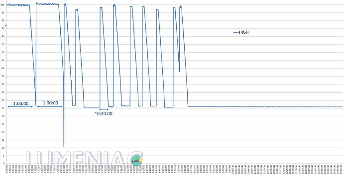

Runtime…heh…no even close to stated 8 hours. However, I think that if you turn it on again every time, then in total you can dial about 4 hours, no less. And quite enough for one evening, taking into account the actually good brightness of this mode. That 35% of the high lasts more than 15 hours after the fall.
Turbo starts to fall from the first second. But there are some PROs too:
a) the fall lasts 8 minutes from a cold start and 5 minutes from a hot start
b) the turbo can be started over and over again, it looks like there is a cutoff on the timer. However, you should not abuse it - overheating is possible.
What do they promise, 8 hours High? Well, yes, 7 of them, however, will be at half brightness. However, few manufacturers pay attention to such trifles …
