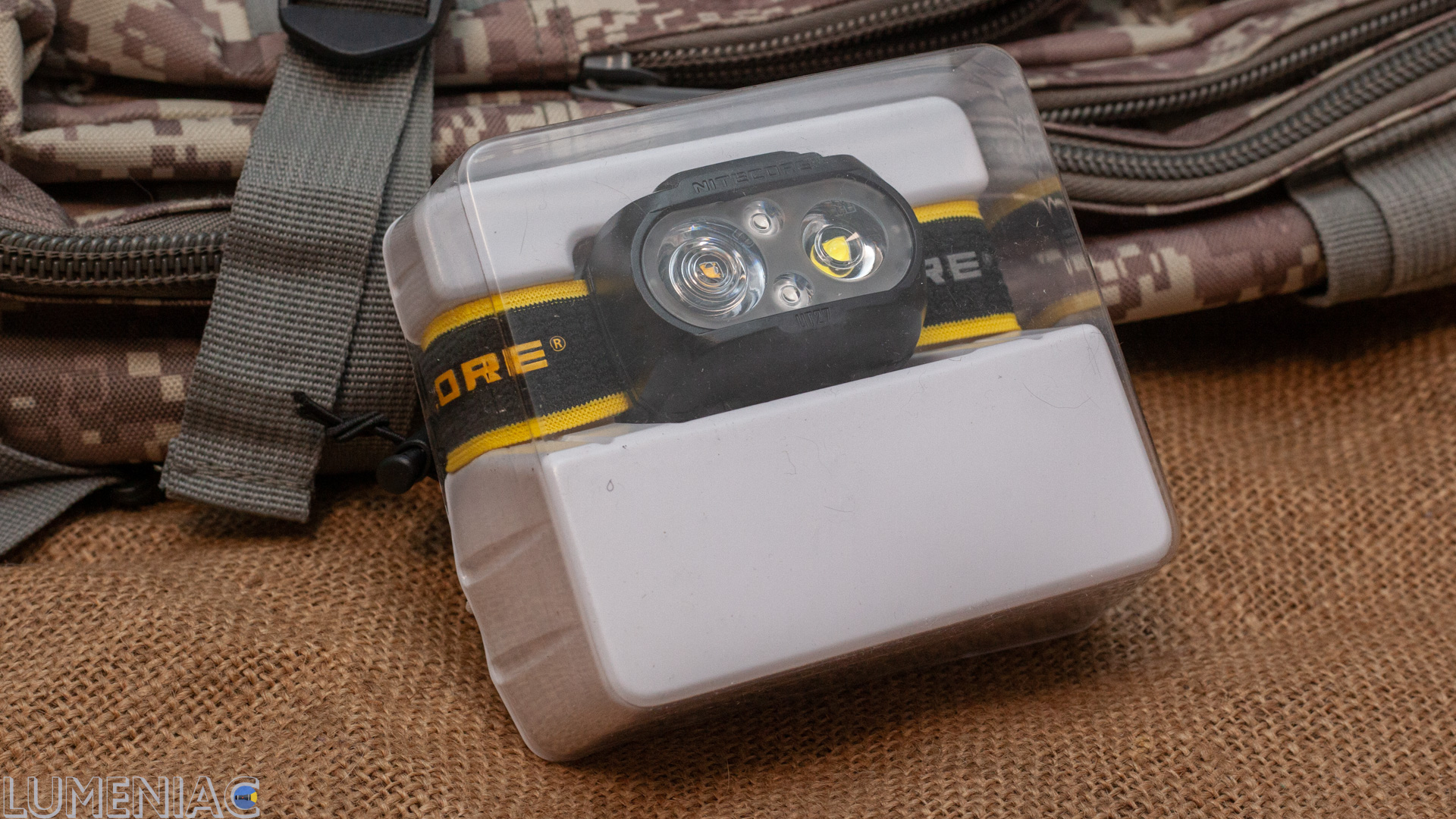

Kit includes flashlight itself , battery (2 of them in PRO version), a Type-C charging cable, a manual and a translucent pouch that Nitecore suggest to use not only to store and carry a headlamp, but also as a diffuser for camping needs.

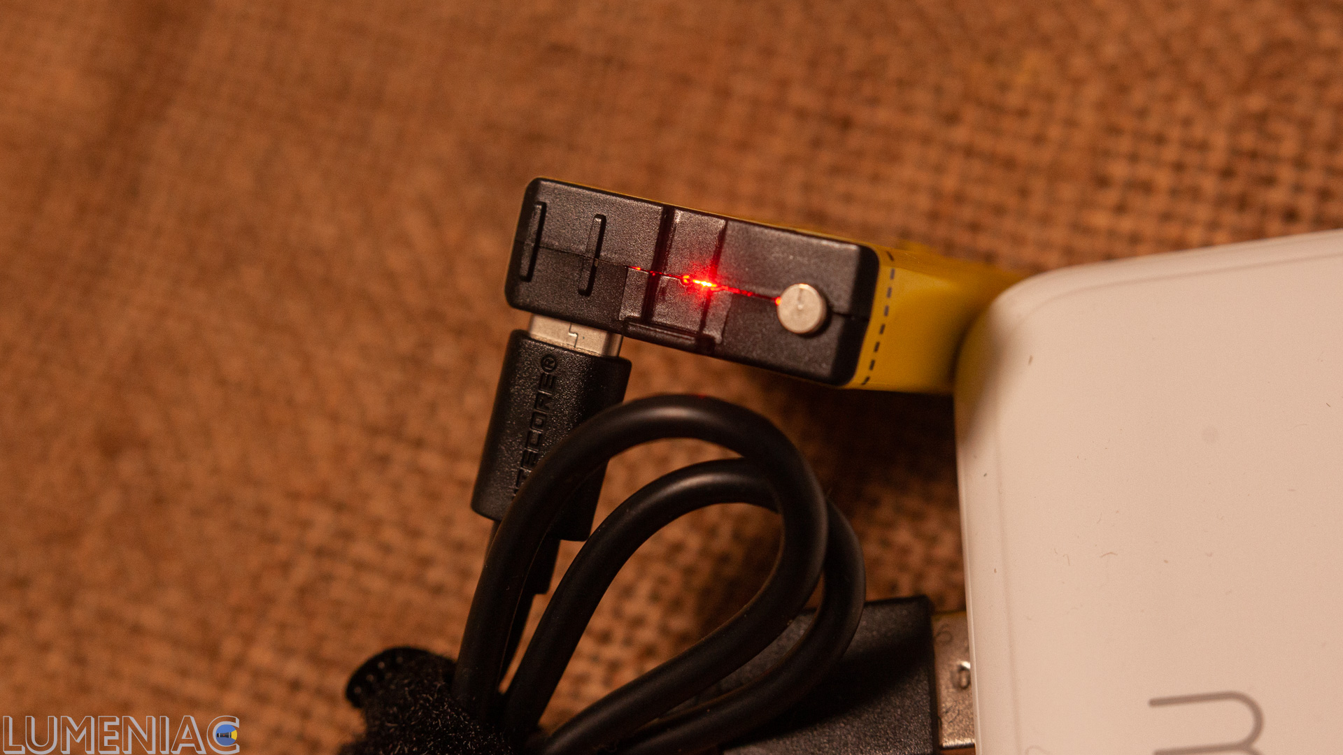

Charging is fast, takes about an hour. There is the usual red-green indication.

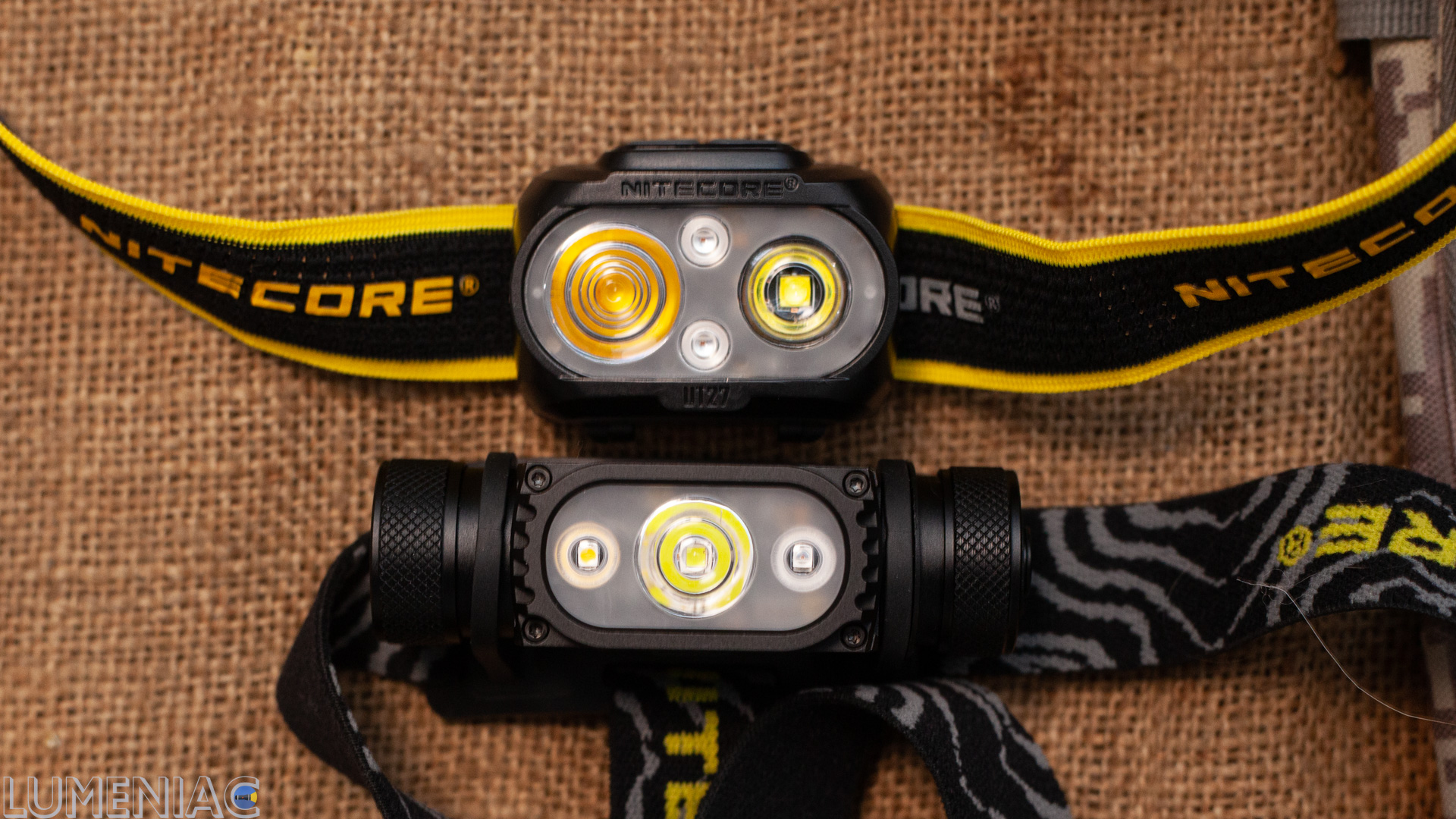

And here is the headlamp itself. It’s quite compact, and definetely lightweight with its 74g, which is quite logical as Nitecore position this is as running headlamp. Of course, there are smaller models, but there have significantly less brightness and battery capacity (non-replaceable, by the way).
For comparison - the classic T-shaped Nitecore HC65 v2, new headlamp by Nitecore

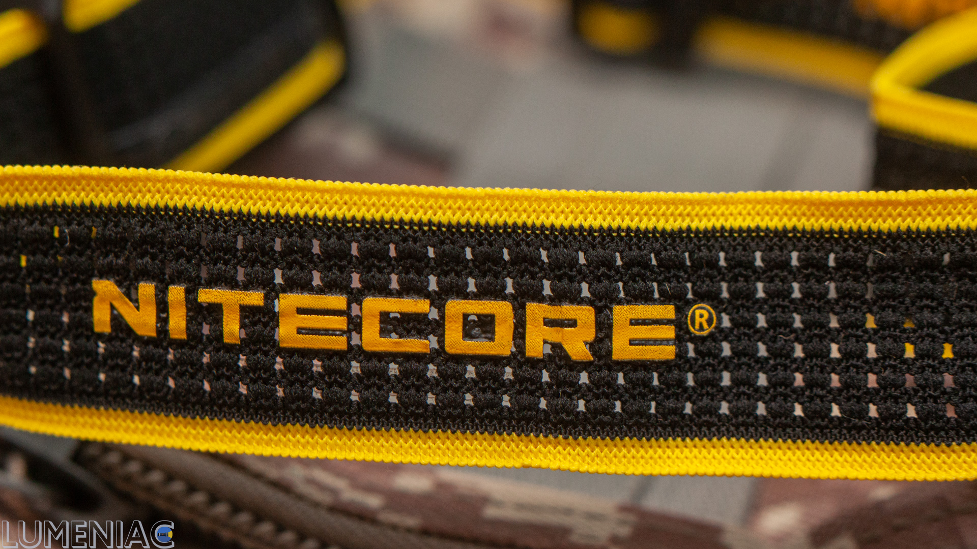

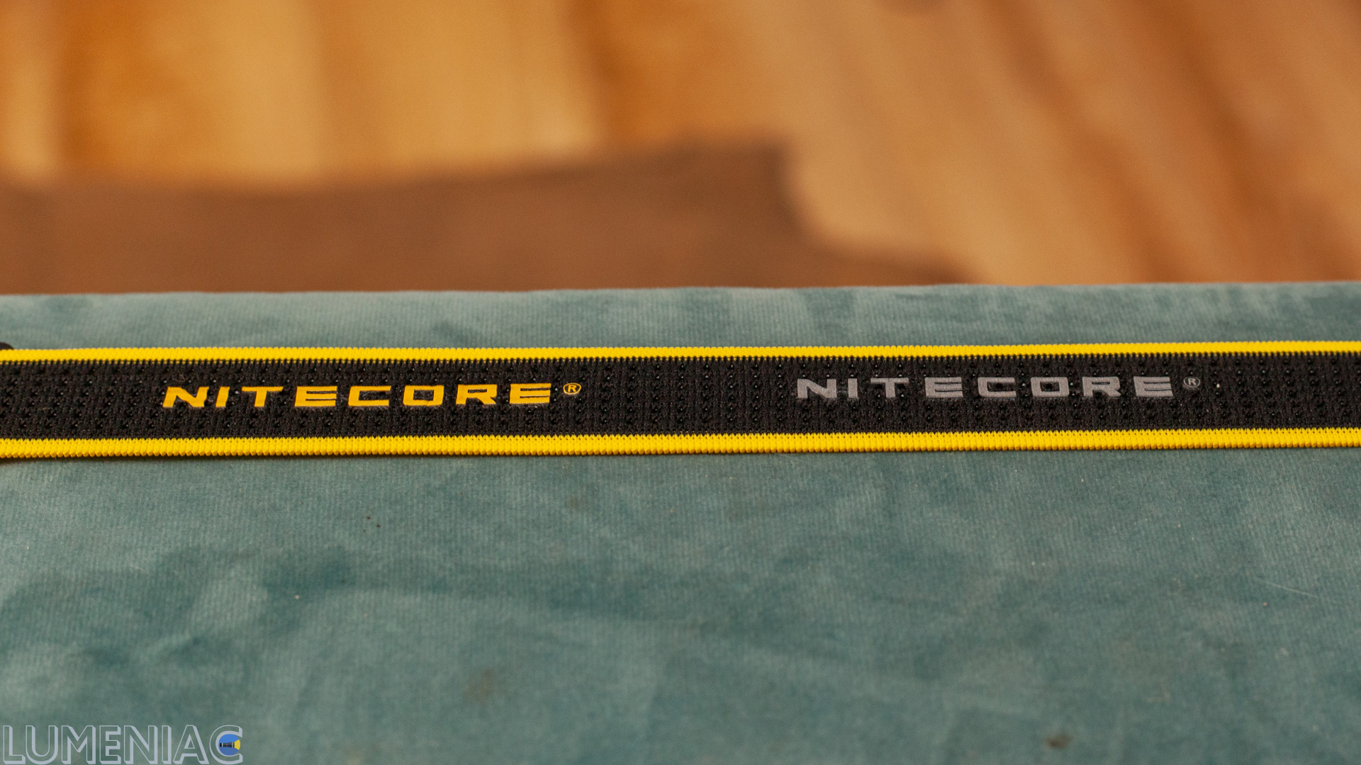

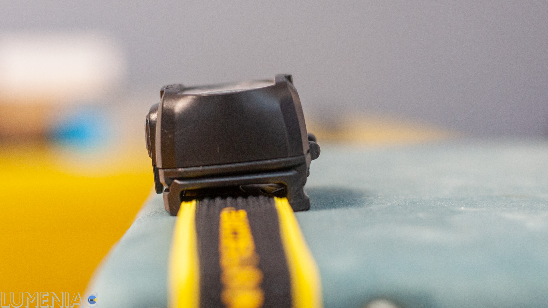

I liked the headband. Lightweight and perforated, with light-reflecting elements.

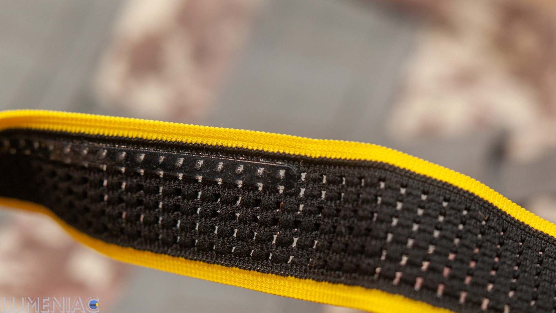

But the gel strip for some reason breaks off in the middle ….
As usually, a ratchet regulates angle.

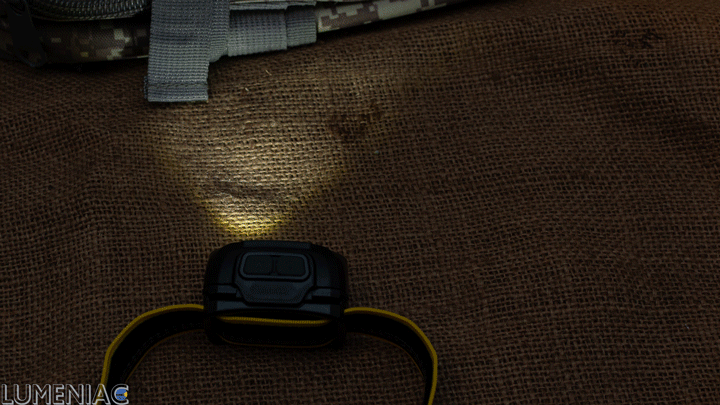

Nitecore UT27 is controlled by a pair of buttons. Each of them is responsible for either flood or spot light, pretty easy to understand even without opening manual. There is no cover that protects them against accidental pressing. But as there is an electronic button lock, you should not worry.
And here is the optics. Here we have 2 TIR lenses, equal size for Flood and Spot. only read light lenses are tiny here. As usual for such flashlights, there is no glass over plastic.

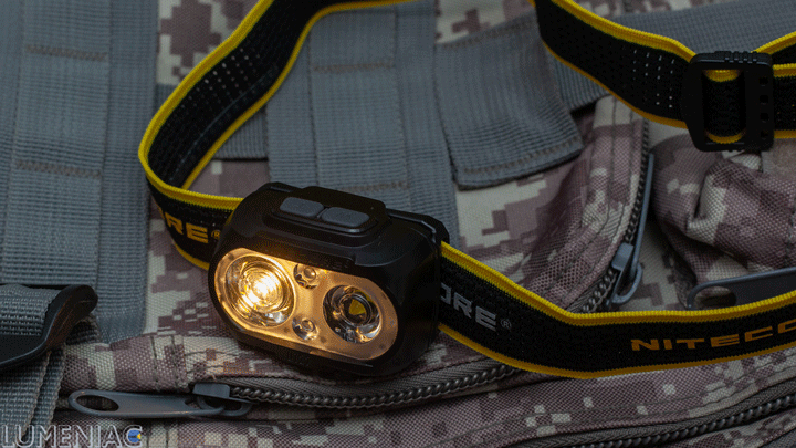

The Nitecore UT27 looks and feels like a good brand item in the hands. There are no visible flaws build quality.

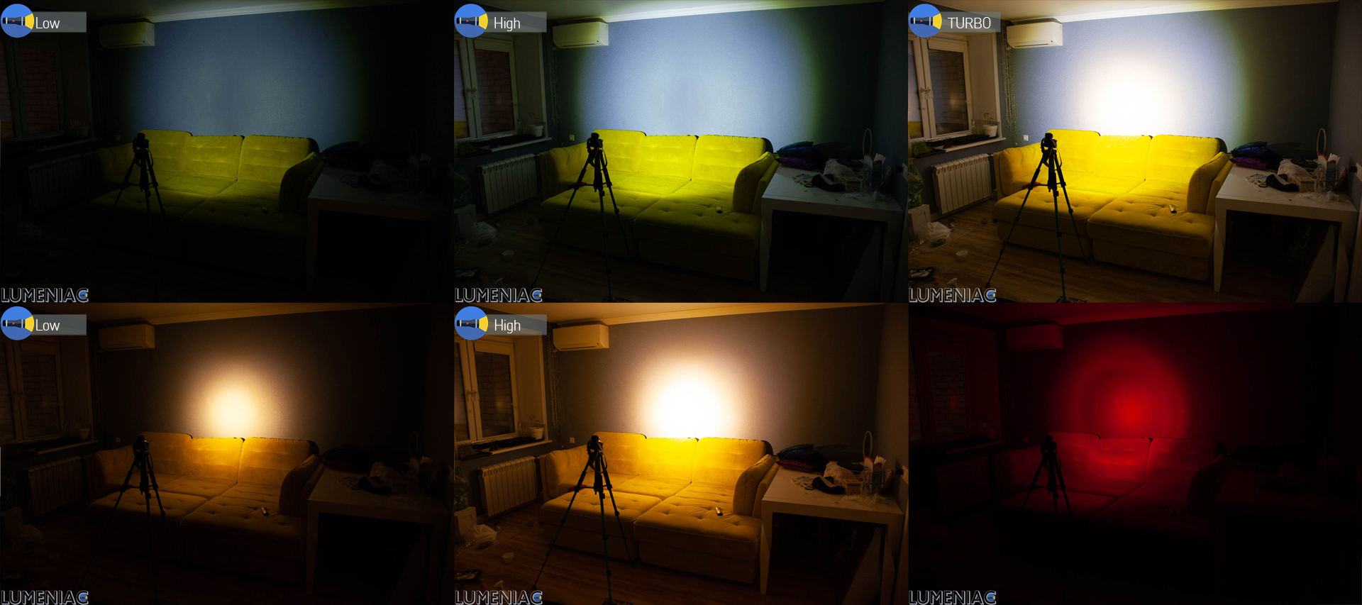

How Nitecore UT27 illuminates

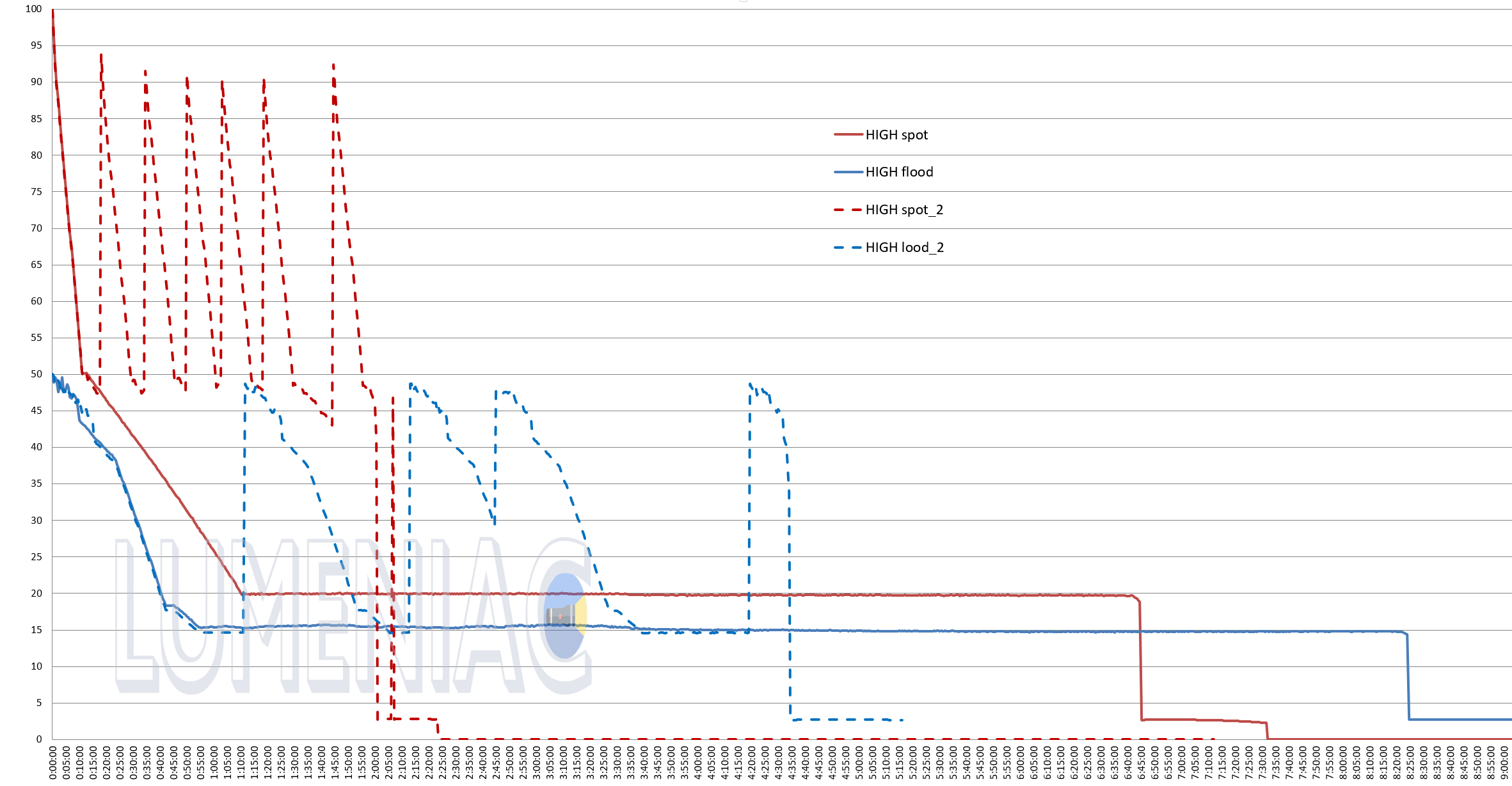

Of course, you should not expect that a compact plastic headlamp will sustains 200 or 400 lumens. UT27 can hold this brightness only for limited time. The good fact is that you can restart both HIGH or LOW at any time, almost up to full discharge.
Even Spot LOW 100 lums is a quite decent mode in terms of brightness and range, and you can quite rely on it. Again, after 40 minutes later it falls, but it can be restarted.
TURBO is 520 lumens bright. But each of both LEDs in this mode is less bright when work in HIGH mode separately. I mean that if you turn TURBO right from HIGH in Spot light mode, then the range will only decrease. As well as when you turn TURBO from FLOOD mode, then the sidelight will only become dimmer.
However, I think that when you need instant “far and wide” light , then with its honest 30 seconds TURBO will be suitable for this, because the brightness here does not slide down.
Yes, it is worth noting that the manufacturer claims thermoregulation. Well, headlamp body is plastic, with a low heat transfer. If it barely warms up in higher modes, then it is logical that I did not see any effect of fan cooling.
As for the light, everything is fine in terms of light distribution. Nice Wide flood light for near range, and Spot light is focused with a reasonable balance of center and side light. 3000K here will certainly perform well in fog, rain and similar air conditions. But again…why Nitecore chose cold light for flood mode, if other their models had normal neutral light exactly in the same mode? Cold light is something I definitely don’t like. And i dont understand why Nitecore so stubbornly cram it anywhere they can.
what is next…mode spacing. There are only generally bright levels. I think that is exactly what you need for a running headlamp.
Firefly at 0.5 lum or just dim ~ 15-20 lum modes are mandatory for household and tourist purposes, but I don’t see any use in them for needs of runners.
So, as you understand, i rate Nitecore UT27 as “ok, will do”, no higher for regular household and camping needs.
Here, I would undoubtedly prefer much more suitable Nitecore NU32, which has almost the same size and weight.
Oh, guys, there is a lot of red light here. Very bright. I don’t know what use it is for running, but if you need a headlamp with a bright red light, then Nitecore UT27 is definitely just that.
