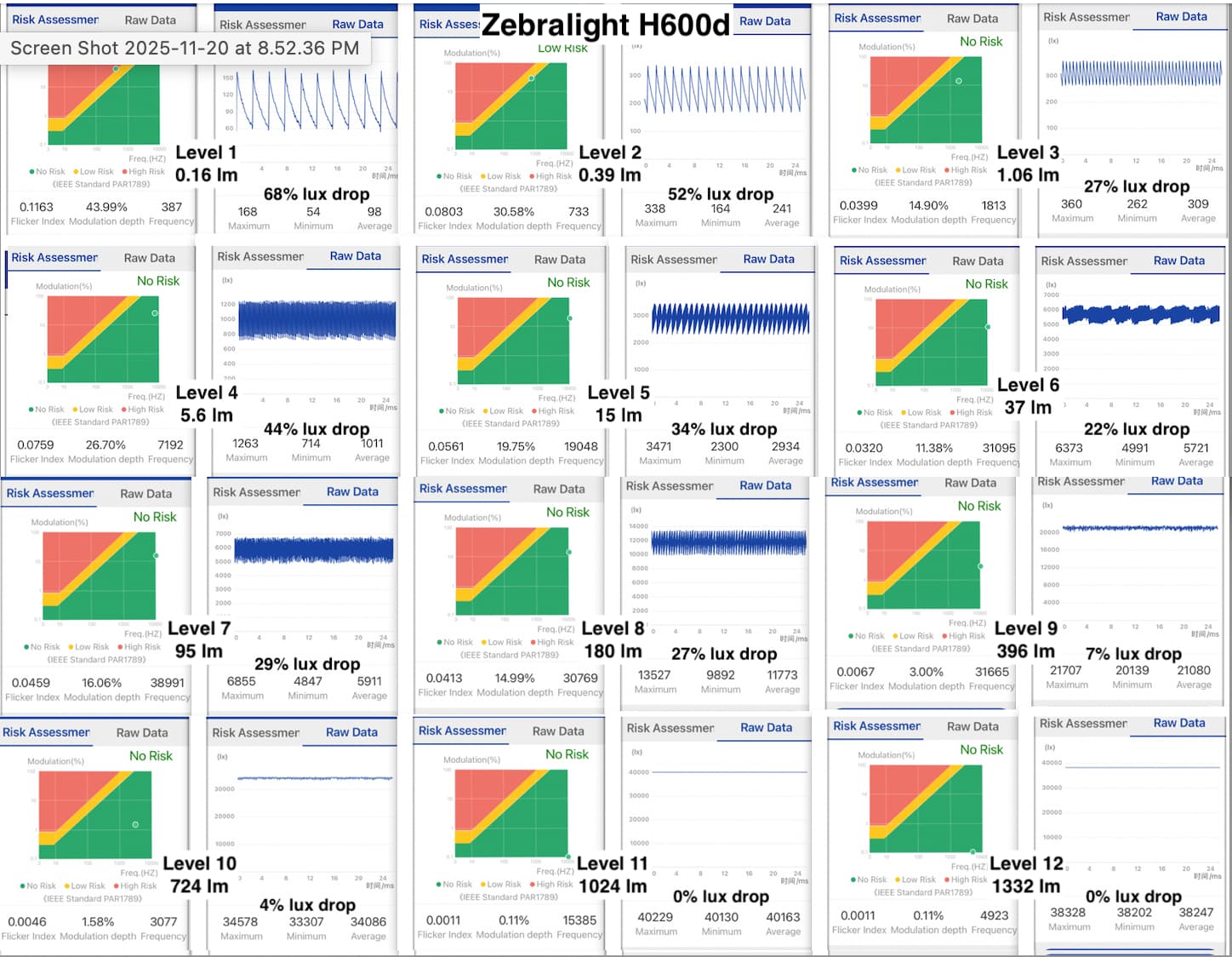

The first two lowest modes have very slow frequency, similar to the SC65c Hi. Other modes through Level 8 use varying degrees of Pulse Depth Modulation, and the Lux output oscillates more than I expected. But none of it is visible to the naked eye. The primary application for this light is for outdoors at relatively high outputs. I have other lights with better LEDs and lower Flicker Index, for low output indoor use.
The Zebra froze in the On condition at low output, just once. When I was testing some of the low modes, doing relatively fast mode changes. Easily remedied by loosening the tailcap.
