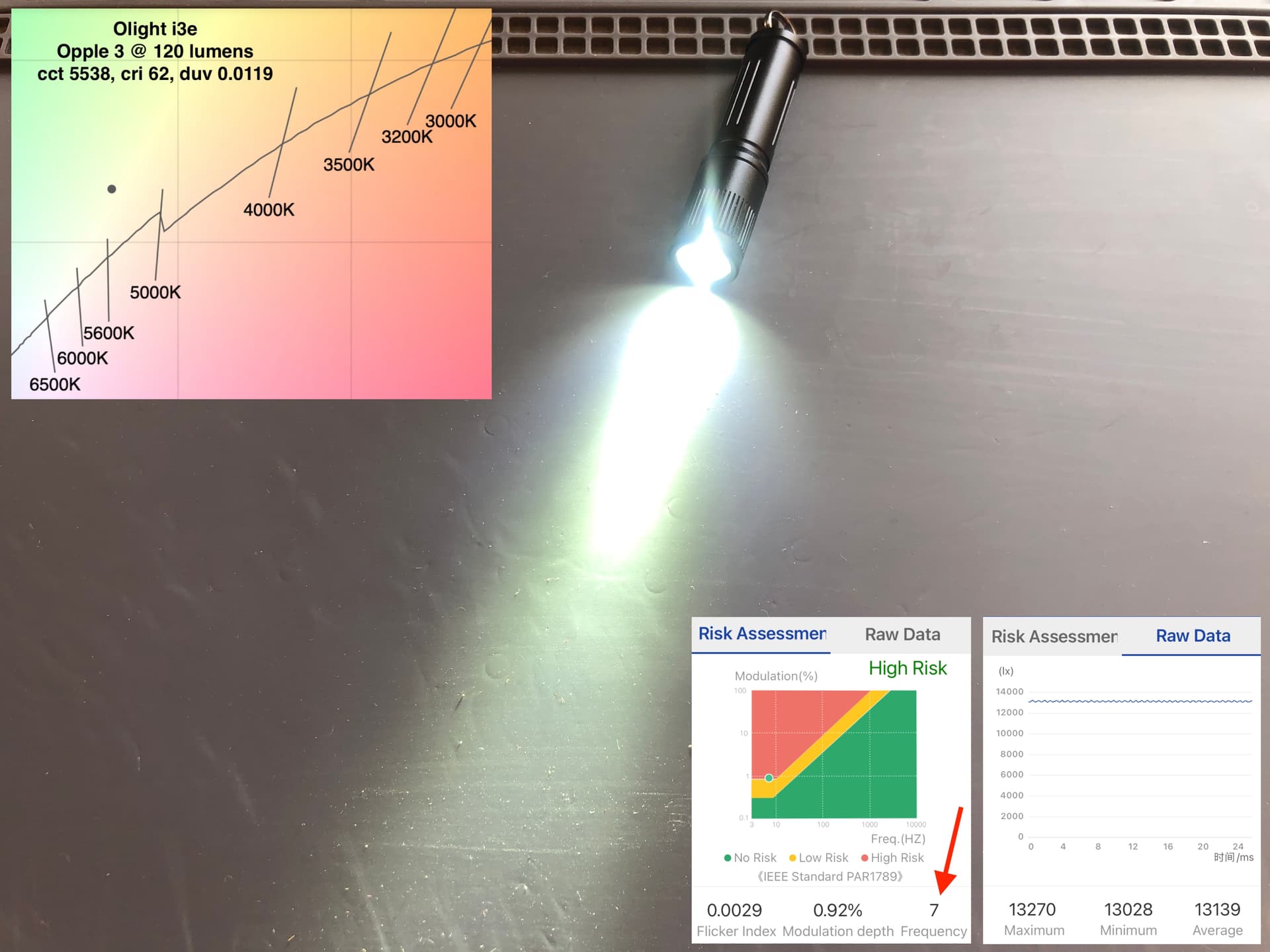

After mod:
Before mod:
As expected output went down (by 38%)
The suprise is the Frequency changed (thousands of times faster)
This was a very satisfying mod, with no drama

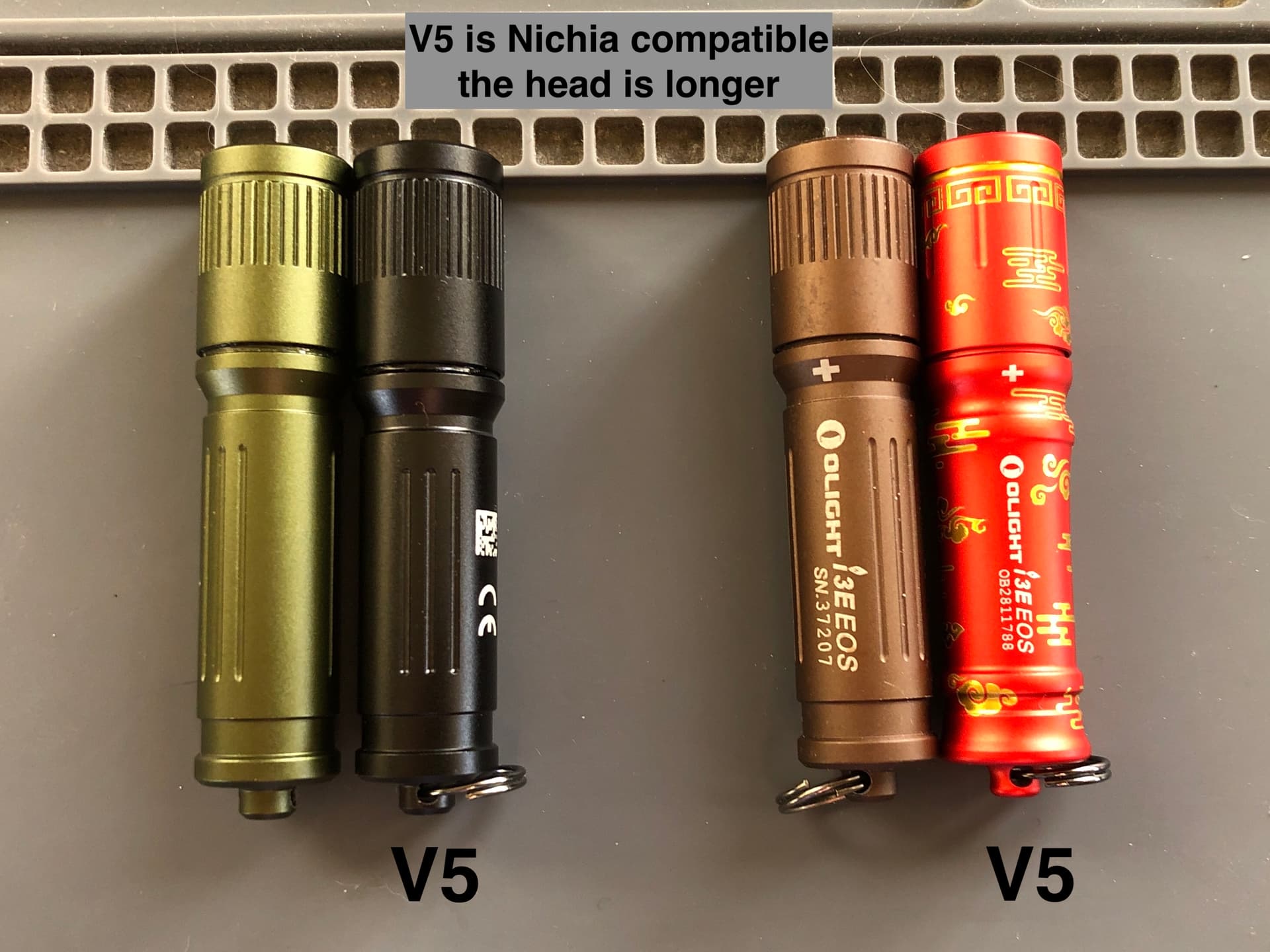

Bear in mind this mod only applies to V5 drivers (present model, maybe for the past year), earlier models dont use 3535 LEDd. The version number can only be seen after separating the reflector from the pcb:

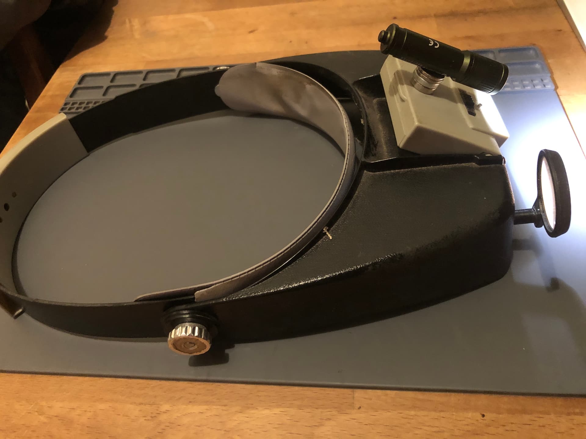

handy for modding too:
(jeweler’s magnifying visor, light held by magnets)

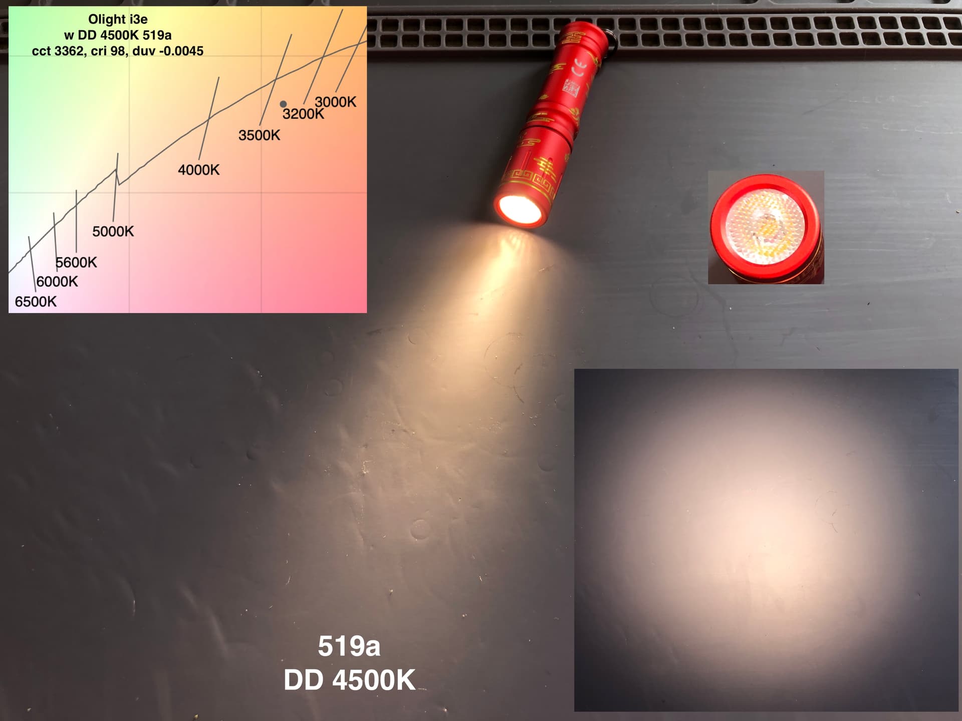

modded it to DeDomed 519a 4500K.

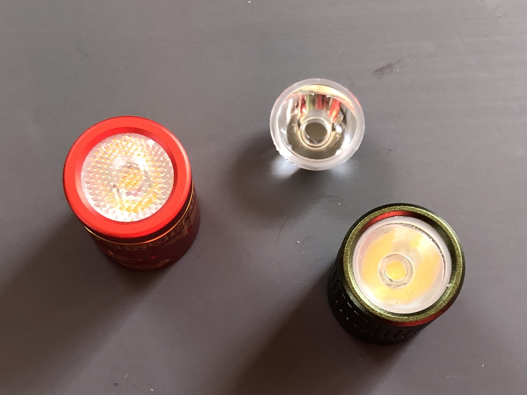

Did not like the beam w the clear Tir, it was a bit swirly… Changed to a 30 Degree Pebbled Tir… like the beam better. Above pic is with the Pebbled Tir.
though now it has radian artifacts around the outside of the beam, noticeable when rotating the light (so dont do that :wink: )
The stock clear Tir is more throwy with a tighter hotspot. Works well w Domed LEDs.
Dynamic Duo (pic shows the clear Tir on both lights):
I prefer the beam of the DD 519a with a Pebbled Tir, so I changed the optic after that photo.
link to the pebbled Tir
the white holder needs to be removed (I used small sidecutters):
