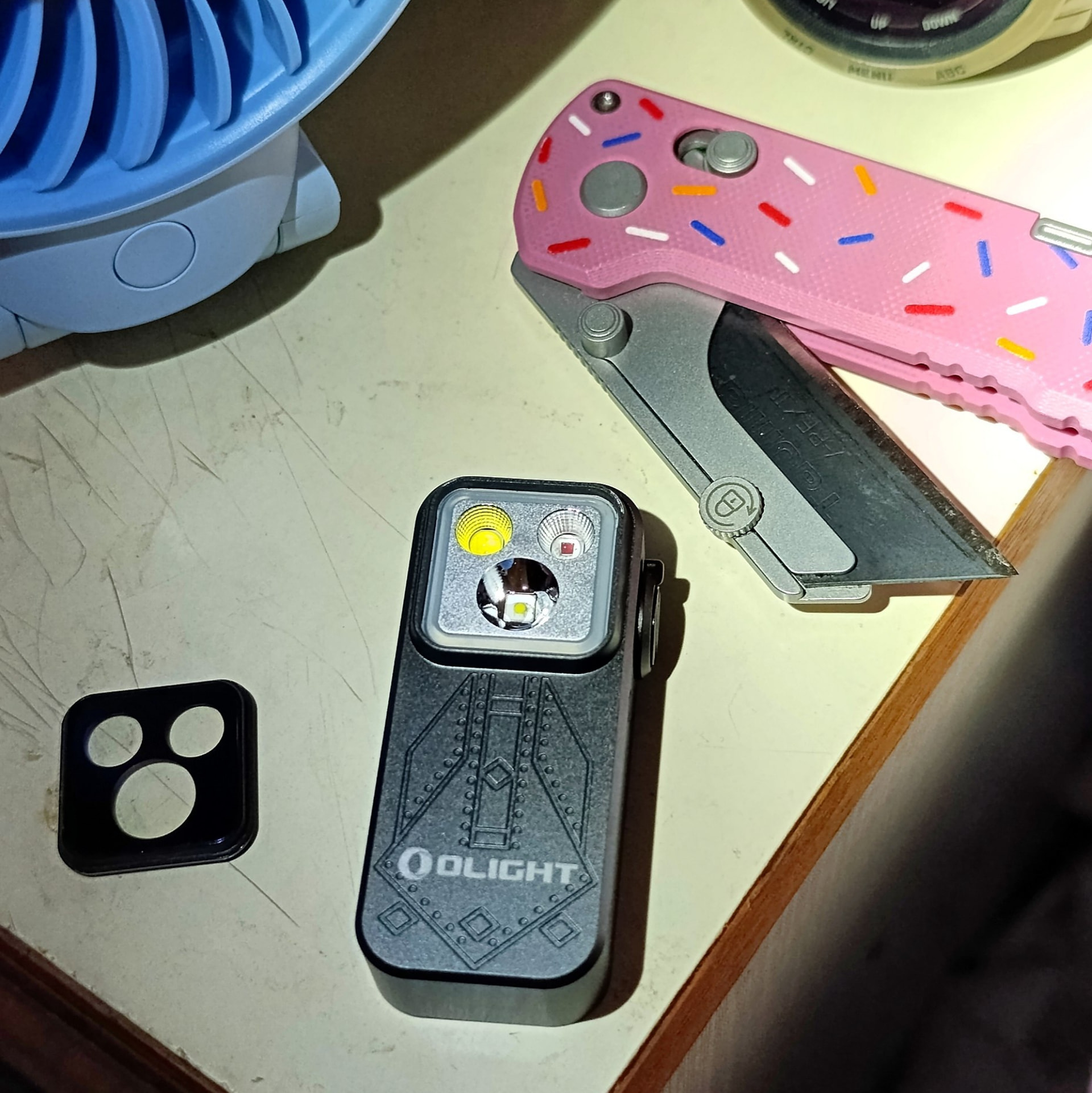

I washed my Oclip Pro and the button started working on its own. Perhaps drying it will solve the problem, like with the Nitecore Tini 2ti.

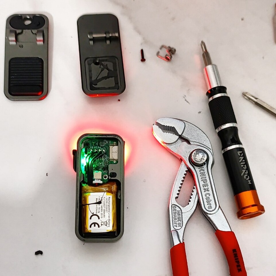

opened glass, there was water, and contacts was also oxidized.
after cleaning with isopropyl alcohol, everything still works, but how long will it last
