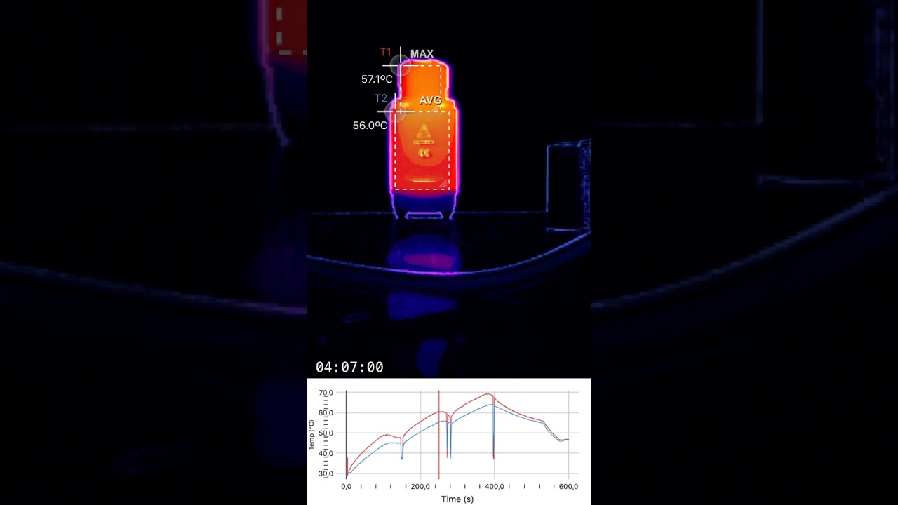

Temperature
The light drops down in output after 1.5 minutes to prevent overheating. However, the light will heat up to very high temperature if you reset the output by switching the light off and on again.
