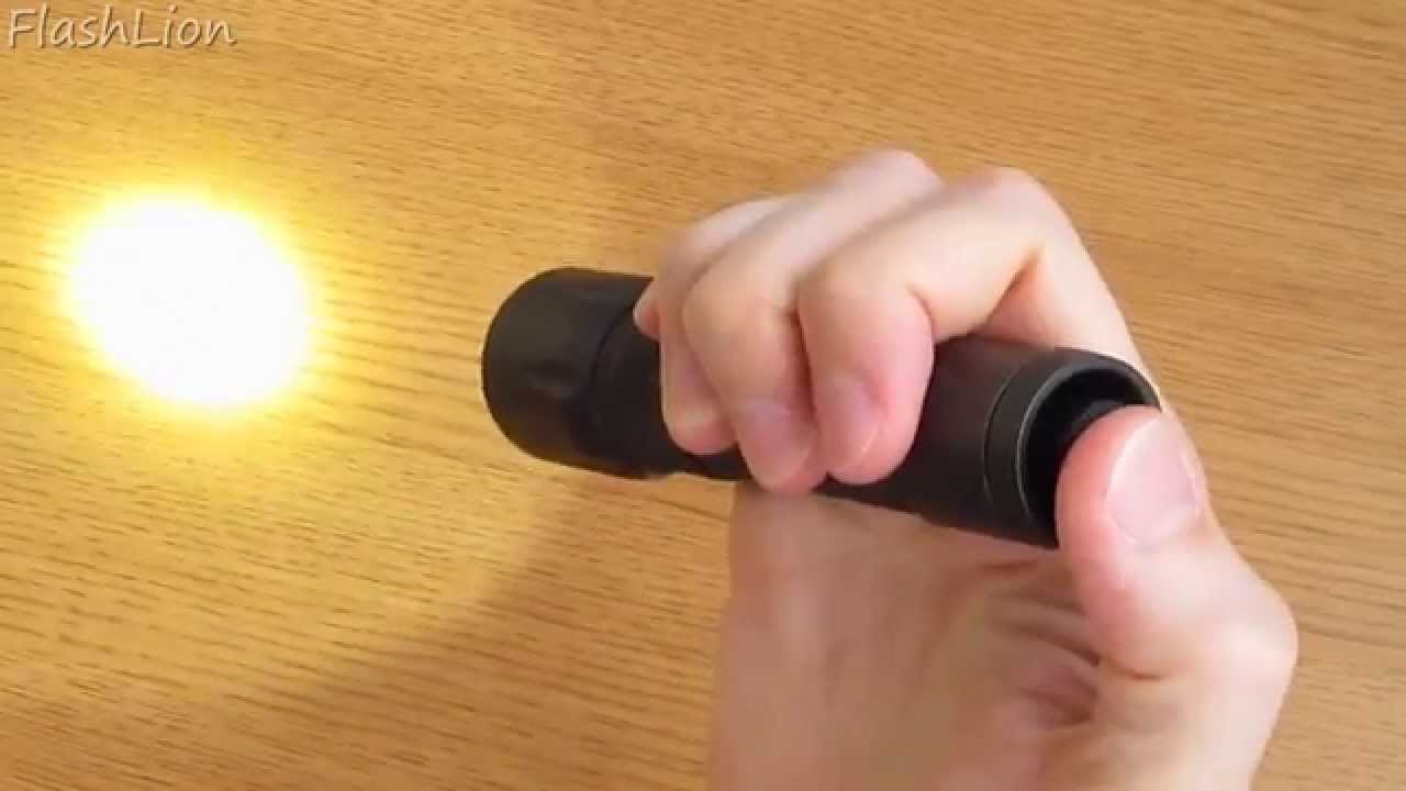

Short video,demostrating the R20 Seeker.
[video=youtube;mZLfopK2e5o]https://www.youtube.com/watch?v=mZLfopK2e5o&list=UU8IeE-lAESAlUjBNau607xQ&index=1[/video]

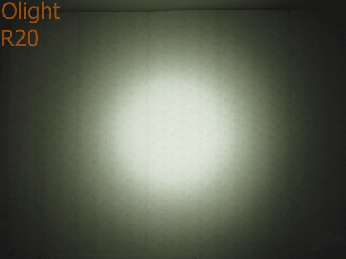

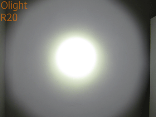

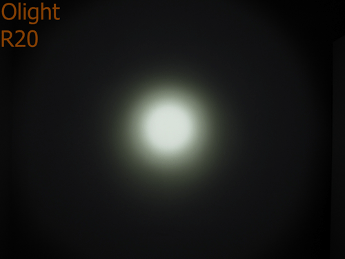

Good beam profile. Due to the Smooth reflector the hot spot is clearly separated,looking more like a thrower beam.
The light from the LED is cool white,but on the warmer side-especially when compared to other flashlights.
The beam is not well mixed and I see a small dark spot in the center.
In my opinion,an Orange peel reflector would be a more appropriate choice for this type of flashlight.

1m, 1/20sec
Olight R20 Low/High vs Fenix PD35,Olight M18 Striker,ThruNite TN12(2014),Klarus ST11,Olight S10 L2( S10L2 was with half empty battery)
1m, 1/250sec
5m, 1/6sec
5m, 1/50sec

Here is the comparison-Olight R20 Orange peel vs smooth reflector.
5 meters, 1/6sec
Here is at 1 meter,white wall
1/250sec
Here at 1/20sec, the beam doesn’t look quite clean,but in real world the OP reflector has much better beam,without dark artifacts in the center of the hotspot(not visible on the pictures,but the smooth reflector had them).
