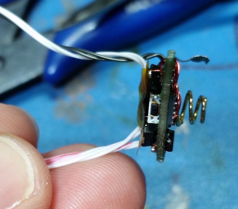

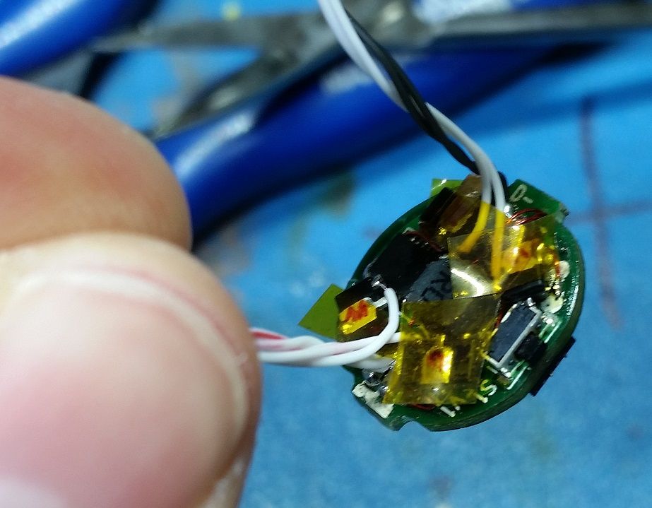

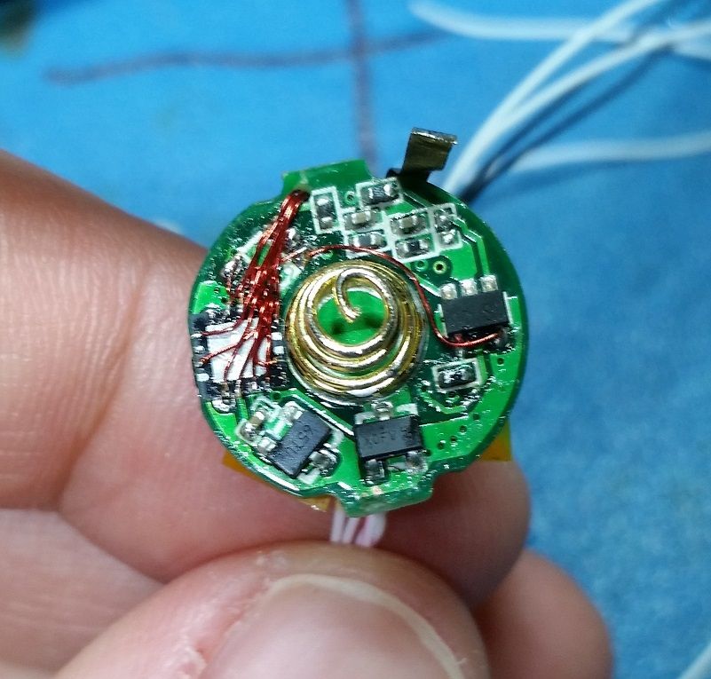

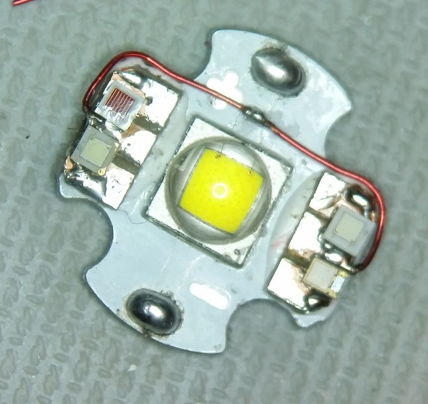

I finally got my hands on an S1 and challenged myself to mod it to RGBWUV with MELD firmware. It was quite a challenge! The driver in the S1 is a really great design and I had to learn way too much about it in order to hack it for this mod. My video goes through the process including an in-depth look at how the stock driver works:
Here are a couple of pictures from the process:

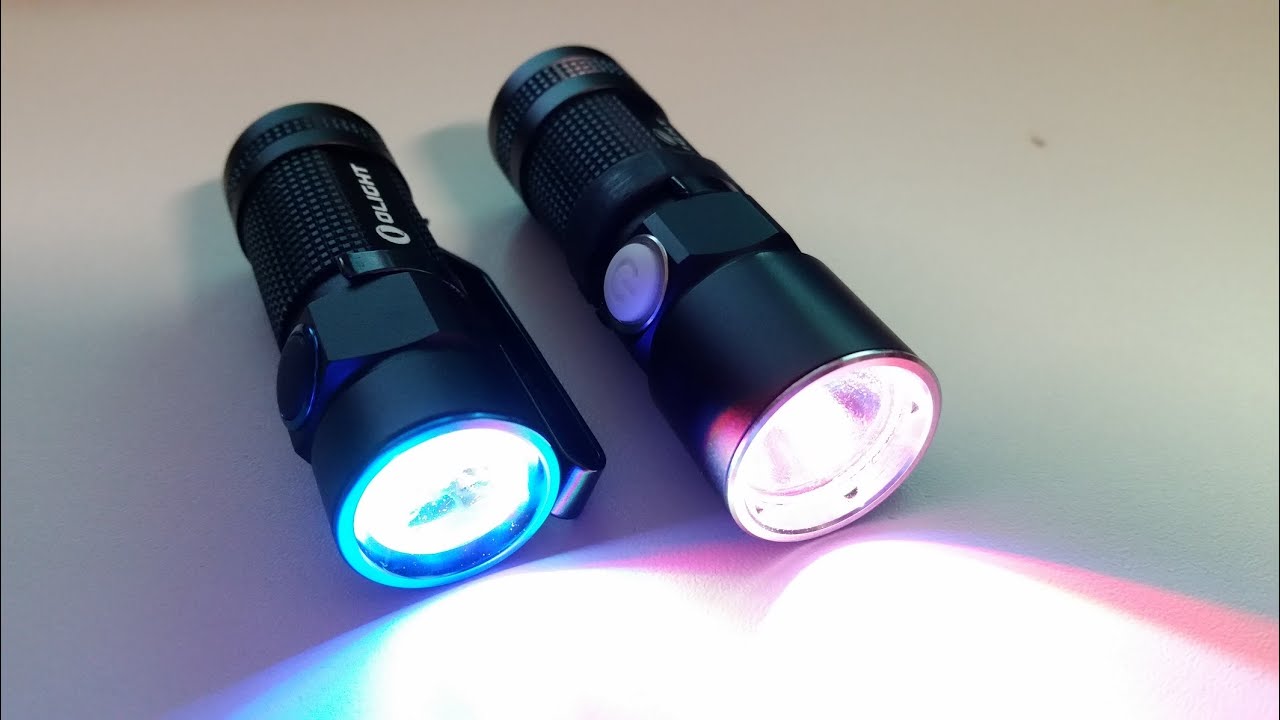

Overall I think I like the S10 better, but the S1 is certainly amazing for how small it is, and that made this a fun challenge to fit so much extra functionality into it!
This is awesome! Why do you like the S10 better? Is it the TIR?

Incredible…. Did you switch the main emitter for another tint? Absolutely incredible mods you do sir!

Yeah, I much prefer the beam from the OP reflector. S1 is really cool just for being so small, but in my opinion the S10 was small enough already and the beam pattern losses don’t justify the size reduction. Some people like floodier beams though, in which case it’s a win-win
Nope, I’m a cool white guy all the way! I know that’s an uncommon opinion around here…
