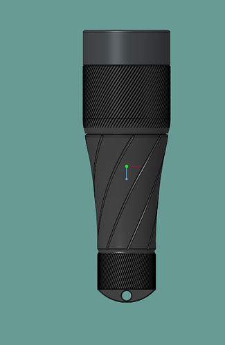

Opinion : Simon should create an AAA Convoy T1
I agree with all above - 21 mm toooo wide for AAA light.
I think this body shape would be nice as a 14500 twisty. 21mm would be okay for 14500.
I think that is too wide for AAA, but it could work well for an AA light.
For AAA I think you should try to make it 15mm wide at most.
I don’t know how popular an AAA mule could be, I don’t think it has been made before.
I think a longer size would be fine, in exchange for a small reflector/TIR. Most people interested in AAA do it for the narrow size, not caring as much for the length. I think a length of around 75-90mm would be ideal, if using a mechanical switch. Shorter if using twist mechanism.
how about this style
I quite like that ,one thing my keychain aaa’s don’t have is throw, So a bigger head like that with a reflector and maybe NM1 would be good.
In Raw aluminium or Stainless steel so keys don’t scratch it up, 10440 capable.
A smaller ,simpler (hopefully cheaper) GT nano.
Personally, I would love to see a AAA/10440 tube style light with an OSRAM to punch out to 25 meters. It seems like all of my options for AAA/10440 is either the Lumintop bigger head with pencil beam out to 100 meters, or an ultra floody flashlight good for under 10 meters. There’s hardly anything in between.
A design similar to an older stainless steel Thrunite TiS (mod with warm white XP-G2) would be perfect. I still wear this lamp with a suit for lack of a worthy successor because it is simply inconspicuous and looks classy. It does not have this tactical look some other lights have and it is also very small.
I don’t like such a playful knurling, especially with such a compact lamp. As simple as possible, with a few edges at the top and bottom, and with an optional clip, perhaps even - if possible - without a knurling. I find this design somehow disproportionate, it doesn’t really fit together.
And for me a keychain light does not need throw. It should be just a flooder because usually I need light in my near area (finding keyholes, looking in basement, guiding my way to the car), not far in the distance. If I want this I would grab a pocket thrower.

I agree 100% with you, that would be very nice. It could be designed to look similar to the S2+ or S6, with the simple diamond knurling.

I have the 11mm driver circuit, but it doesn’t support the 10440 Li-ion battery.
I want to extend the diameter to 13mm.
13 mm to get compatibility with 10440? This could be good in terms of good design and proportions.
