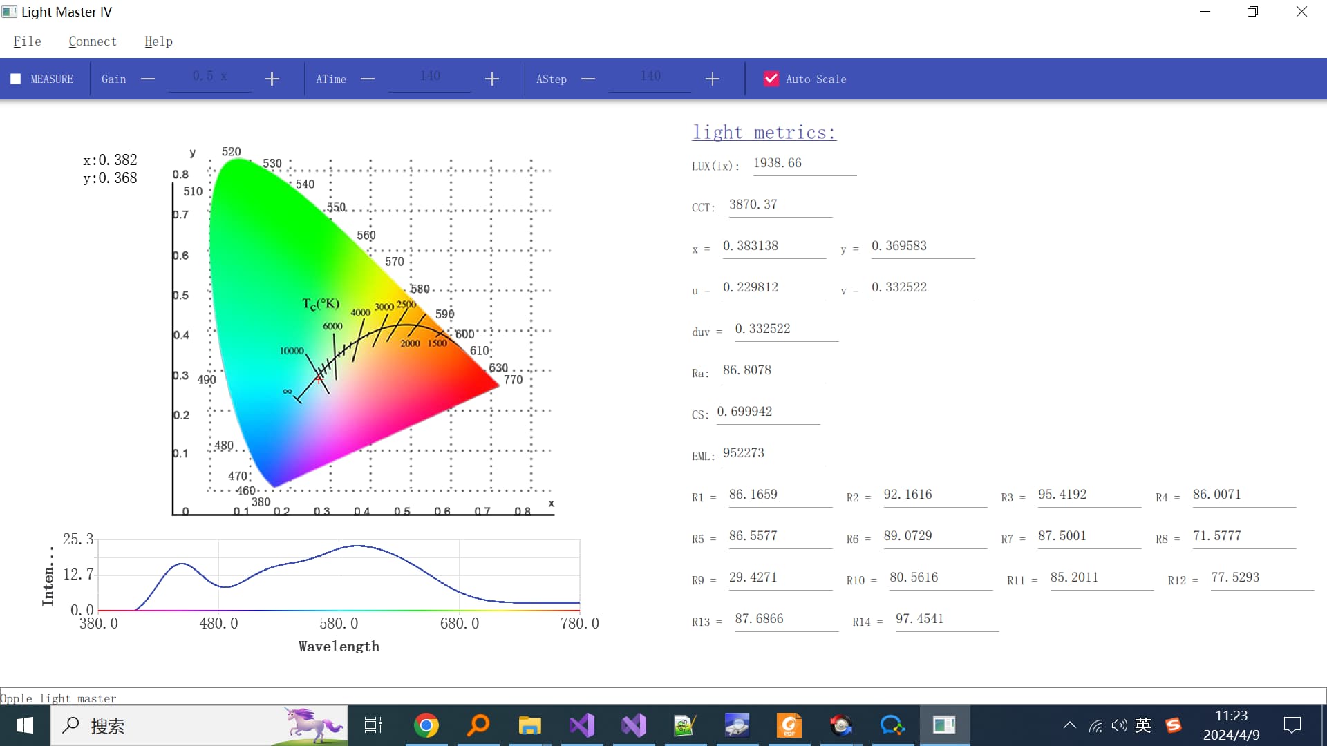

my Windows app GUI as above, currently only serial port connection allowed.
working on bluetooth support:-)
very preliminary, want to copycat ams osram’s color calculator but not easy :innocent:
if color calculator someday is open sourced, it would be great news.
we can just feed the reconstructed spectrum into color calculator and all metrics are calculated. It would be like an IS system, kinda similar to Everfine’s IS system but in a extremely small form factor(of course due to sparse resolution/channels, accuracy would not be comparable to a real IS ).

this is the measurement of sunlight, all those metrics are calculated using the reconstructed spectrum.
most metrics are good enough(XYZ calibration should be used in conjunction with spectral reconstruction, XYZ for metrics like CIE sx/sy and cct and so on, while spectral calibration for color rendering index).
the spectral graph drawing is kinda distorted now, I guess the spectral curve is too smooth because the sensor can not detect the minor details in the real sun spectrum(I have not compare with cl-500a measured spectral curve yet, but I guess there could be some zigzags in the real sunlight curve ). below is the sun spectra curves I measured long ago(totally different weather condition compared with above graph).
for sunlight, currently LM4’s CRI is totally not reliable. as for duv, you mean it is also not accurate? I don’t know how my XYZ matrix would behave under 12000K sunlight.

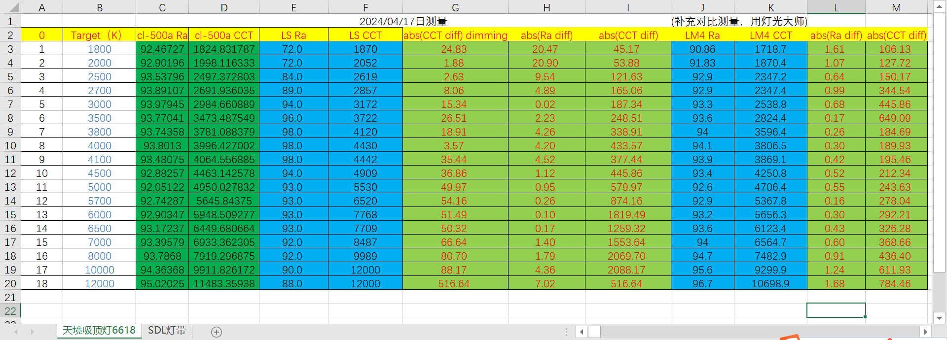

compare column H and column L, we can see Ra accuracy is boosted.
column H used old algorithm, while column L uses new algorithm.
This looks really good, both CCT and RA are hugely better now. Congrats! Amazing work!
Any idea when we will see the new algo in our Android apps?
