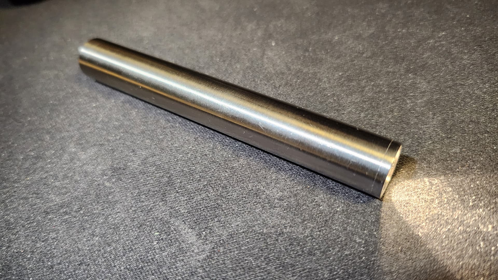

NAME THIS LIGHT! (alternate government name also accepted)
Looks like a…
Spoiler Alert!
BLF-348
I think I have one of those somewhere around the house. :slightly_smiling_face:
I lost the pocket clip a while back…never cared much for it as it always slid off anyways lol.
I do want to update the driver in it though, relative to other AAA form factors this thing gets pretty warm. I ran it for 30m last night on an eneloop, not sure what the total runtime would be.
Great light! It’s a shame these are hard to find nowadays.
I appreciate it’s not particularly waterproof, but the slim format, simple UI, recessed switch and high CRI make this a winner in my books.
I put together a BLF-TINY10 (1x7135 and five modes) to put in an sf 348 and its one of my favourite lights now! Would highly recommend, though you do lose AAA compatibility.
