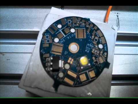

This sounded like a really interesting idea… So, Without further ado:
PPtk
Cool, I’m really surprised that the internal solder junctions in the TEC did not fail. Or perhaps the internal solder junction melted but, being sandwiched between the ceramic faces, they had no where to go.
Nah, I cheated, it’s a high temperature TEC. Rated for continuous operation at 200C with excursions to 300. ![]()
Scratch That! That was a ‘regular’ 80C Rated Module. And it survived, amazingly.
I thought I grabbed one of the High-Temp TETECH ones, but I’m thinking about it now, and that wasn’t a TETECH - it was a regular old MELCOR/LAIRD.
Wow. I really am surprised that it didn’t fall apart at that temperature.
Now that worked out pretty slick. I have no experience in reflow, but would you consider that one of the better ways, or just another way to do it?
Just another… Not even as good as some - but it’s very workable, and for those without a few million dollars worth of electronic assembly equipment surrounding them - it definitely does the job.
