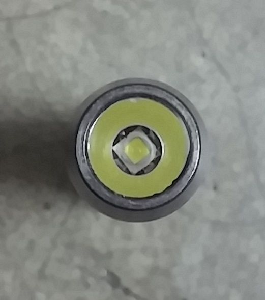

Hello guys I was wondering if i polish the TIR lens of my D2 will it effect the beam? I want it to be more focused. Now I have replaced the TIR with my nitecore T5’s aluminium reflector, but i am not liking the beam profile.
Polish where ? TIRs rely on the point plastic and air meet to produce the internal reflection, any damage to the surface of the tir with dust or fingerprints will destroy that critical interface and reduce efficiency so be very careful only handle with gloves or tweezers around the outer mounting edge. Polishing the front will be ok but polishing the back will only make things worse.
Edit: dedoming would make a big difference to the beam. That’s what’s I’d do first if it was mine…
wanted to polish the front, the frosted part. Will it make any difference?

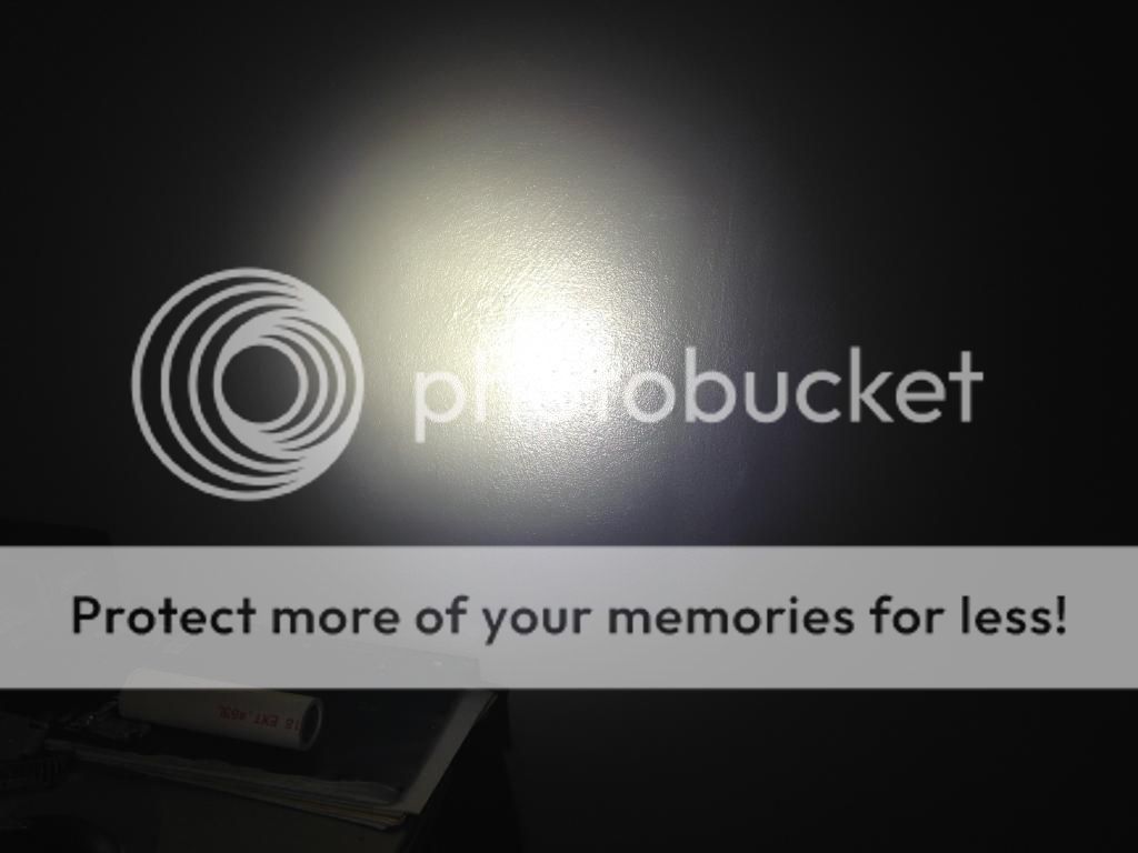

Stock frosted-front 10511:
same 10511 back in the same light with the front face polished:
edit: mouseover version

I dont have any before pic’s of the 511 in the light, just a pic of the 507 vs. the polished 511. I like it and will be keeping it, its IMO the best option for my preference in the way I use my light. Also note 2 of my emitters are dedomed and the 507 is lightly burnt in some spots but it didnt effect the beam.

507 on left, polished 511 on right
Had I taken more time with it I would of moved up to green then white compounds on printer paper but whats the point, this is my EDC, it gets the snot beat out of it every day, it would never last so this is more than good enough plus it gets rid of those stupid dirt collecting divots in the face of the 507.
507, you can see the burned spots but it was at the very bottom rim below the emitter
polished 511
