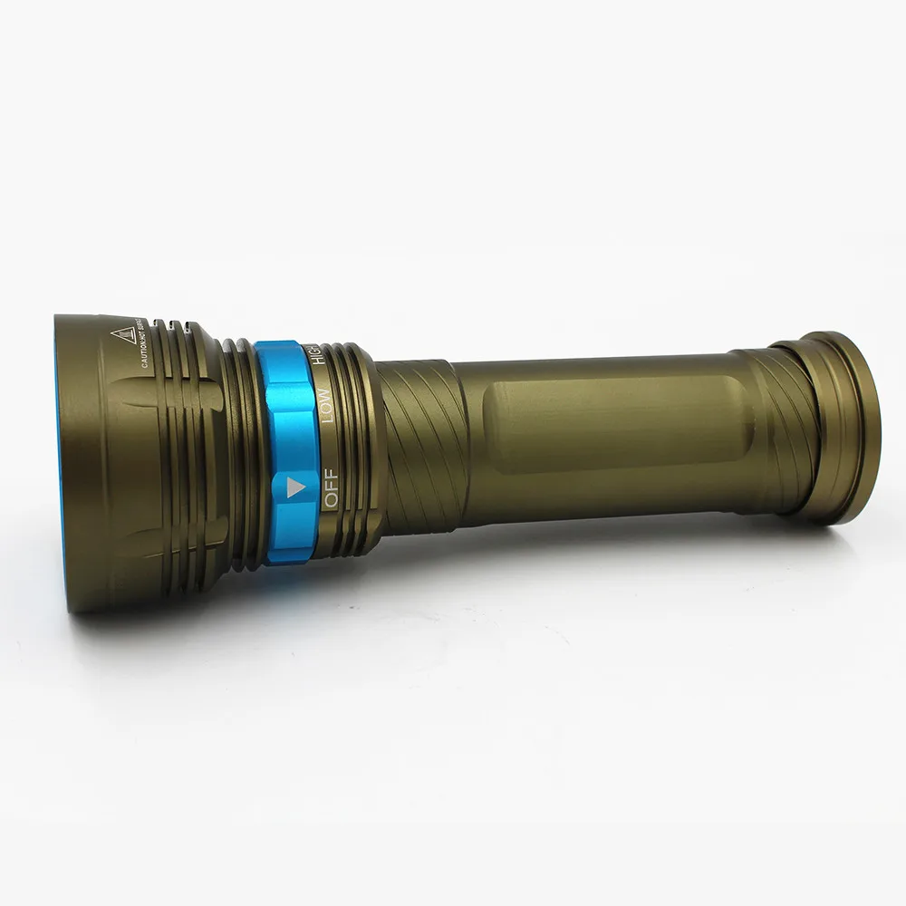

Came across this dive light today and it reminded me of the concept of the upcoming Astrolux MF03
So I had the thought, could it be modded to work that way? (for flood + throw) by installing a dedomed / HI emitter in the center reflector,
and maybe XP-L’s or XM-L2’s around it (looks like lettuce bright LED’s currently) I’m curious how the LED’s are mounted in this.
It has a magnetic selector ring switch with: OFF-LOW-HIGH-STROBE ….so maybe it could be rewired for OFF-FLOOD-THROW-BOTH ?
It has 6x 18650 configuration…
I’m not sure but it appears each pair is in series, then the 3 pairs are paralleled with each other, for 8.4v total?
So I suppose it’s running some sort of buck driver.

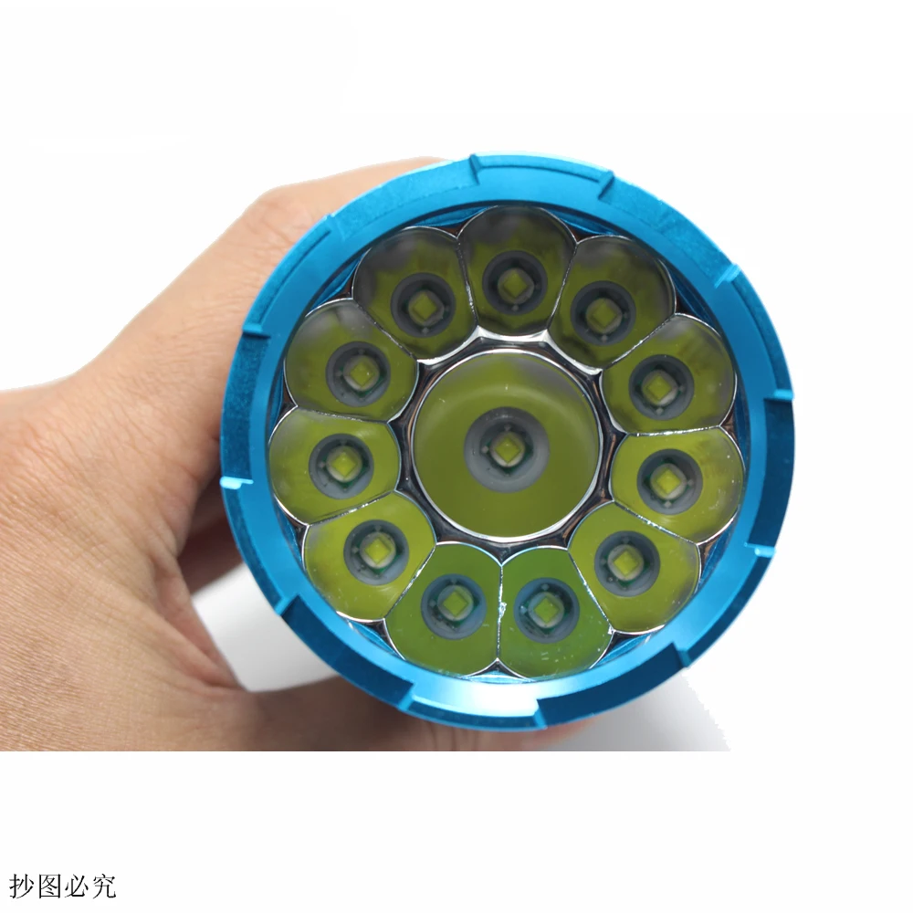

Just noticed a 12-LED “SRK style” version / 4*18650

I really can’t advise on gutting the switch because I don’t actually have this light yet. But I suppose anything is possible, If the ring can be easily removed then just find a location to drill a hole for the switch.
Personally I thought the magnetic ring switch was a great feature and since it’s 4-position I was thinking it could be rewired for OFF-FLOOD-THROW-BOTH

The 12* DAOZHIMEI King has a larger head (65mm) vs 59mm for the Sofirn SF34, and the center reflector is much larger than the Sofirn, The DAOZHIMEI King’s center reflector looks comparable to the Sky-Ray 14* (70mm head) So I’m thinking that center led in the Sofirn won’t be much difference in beam than its outside leds.
………………DAOZHIMEI King 12 * 65mm……………………….Sofirn SF34 14 * 59mm…………………………………Sky-Ray 14 * 70mm…………………
Ultimately I think the layout of the1st light has the best potential for a budget MF03, but I do like the compact size of the kings, out of those two I like the DAOZHIMEI I just posted, it has the largest head and (I think) center reflector. But it’s a crapshoot on the pill until someone gets one.

Also I’d like to know how those magnetic ring switches are usually wired, I suppose it’s like an e-switch? Maybe requires a special driver.
