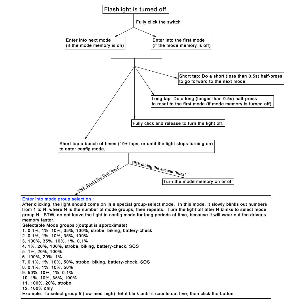

Are you tapping it 20 times to get into the menu?
When i tap it 20 times do i hold on the last tap ?
I can 10 tap program my streamlights..
No don’t hold on the last tap.
With Biscotti it was 10taps, with the newer 12group firmware it’s 20taps.

The default should be group2
Old picture, it’s definitely 20taps to get into configuration. Everything else is the same I believe:

Ive got hope yet, somehow got it to start counting down the 12 flashes, apparently didnt get it to lock in tho.. so its not a driver problem its totally a ME problem, but that was a given hahaha
Nope, i got it down pat to get in program mode, wait for the 12 flashes then half press, 1 slow flash and a long one, it turns off. Nothing is saved. Ive done this over and over and its the same outcome.. am i missing something or have i messed up my driver somehow ?
Head hurts so ill try researching tomorrow.
I just switch it off after the 12 flashes have started, you don’t need to count to 12, just count the 11 flashes and wait for the first flash of the 12, then shut the light off. Now it should be fine.
