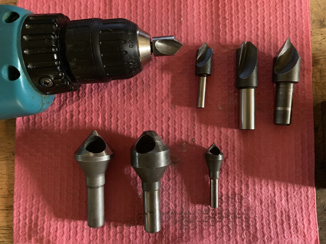

Remember you have to open the emitter holes in the reflector a bit…
I just chamfer the emitter holes to just fit around the emitter pad to keep it centered with out bang it around or use centering rings…
Here are some of my bit(s) I use… some use tapered reamers?
