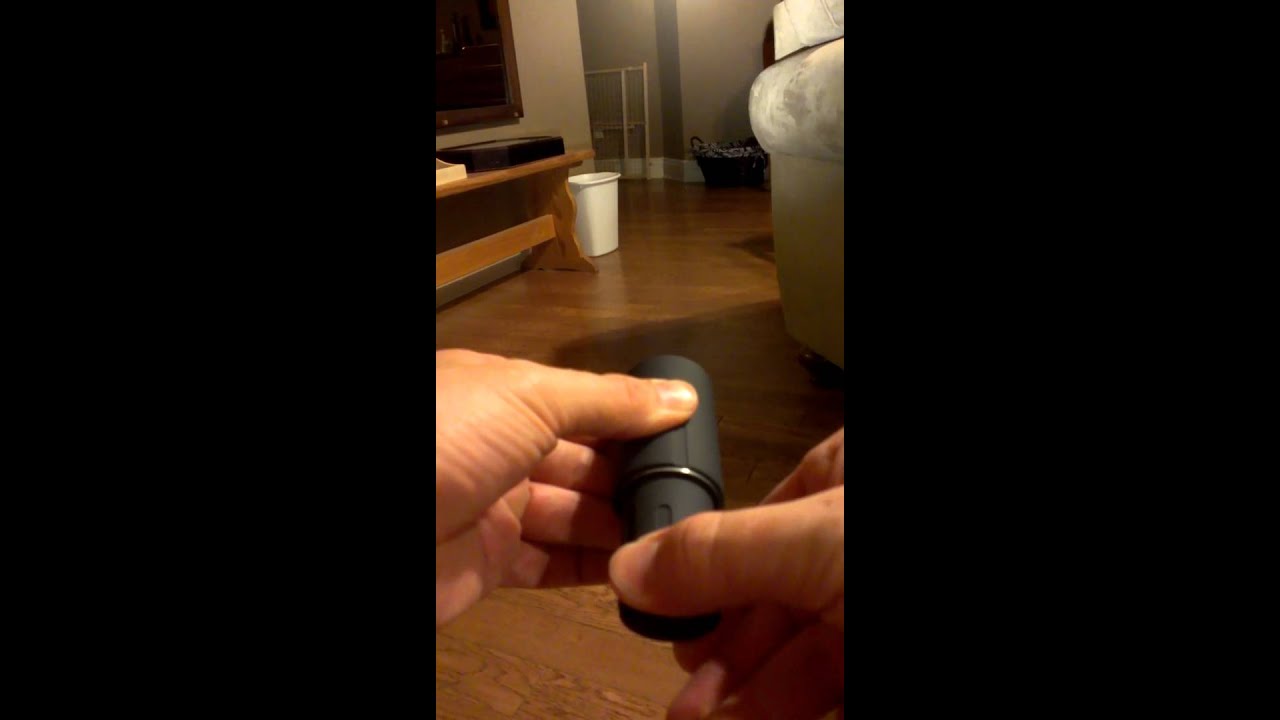

I’ve been working for a long time now on a light built around a QTC engine from scratch – trying to eliminate as many of the common failures of the material as I can. Also, this light is non-battery crush, so no rattling when it is completely uncompressed. I feel pretty good about what I’ve come up with so far. Here are a couple pics of my last 2 prototypes:

I’ve been able to get a good amount of longevity out of the QTC material (after many many failed attempts). In earlier prototypes there would always be artifacts that started to appear. Mainly because the material was receiving too much pressure too many times - leading to the flickers and less-than-reliable brightness change that many have described.

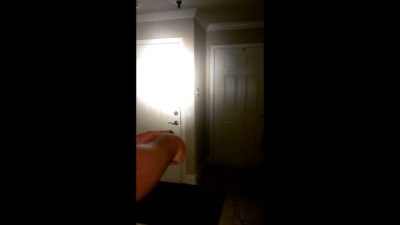

In my older models the QTC would develop these artifacts pretty quickly, but in the newer engine designs I’ve limited the amount of compression force the QTC takes, which greatly improves it’s longevity and performance. I’ve also added a fail-safe in the event of complete QTC failure. The light goes to direct drive automatically, bypassing the QTC, when it reaches maximum compression. Another good thing is that the QTC, even when mangled, still performs approximately as intended in this engine. This light should be very durable. I’ve eliminated as many parts as possible. It is designed to be quickly disassembled - similar to field cleaning a gun. I’m a big fan of minimal design…it’s down to only one threaded part and 2 solder points (and I want to get rid of those too lol).
This latest light after a couple thousand twists and several nights of full-on still acts as it should - one full rotation from dimmest setting to max. I’ll continue to test it until I can get it to fail somewhere, then hopefully fix whatever weak link pops up. Luckily it’s finally getting close to how I originally envisioned it.
Here is a video showing the fail-safe in operation (you can also see the wear it is getting from torture tests lol. Very durable so far). You can see the light jump up to direct drive when it gets near the end of the twist:
