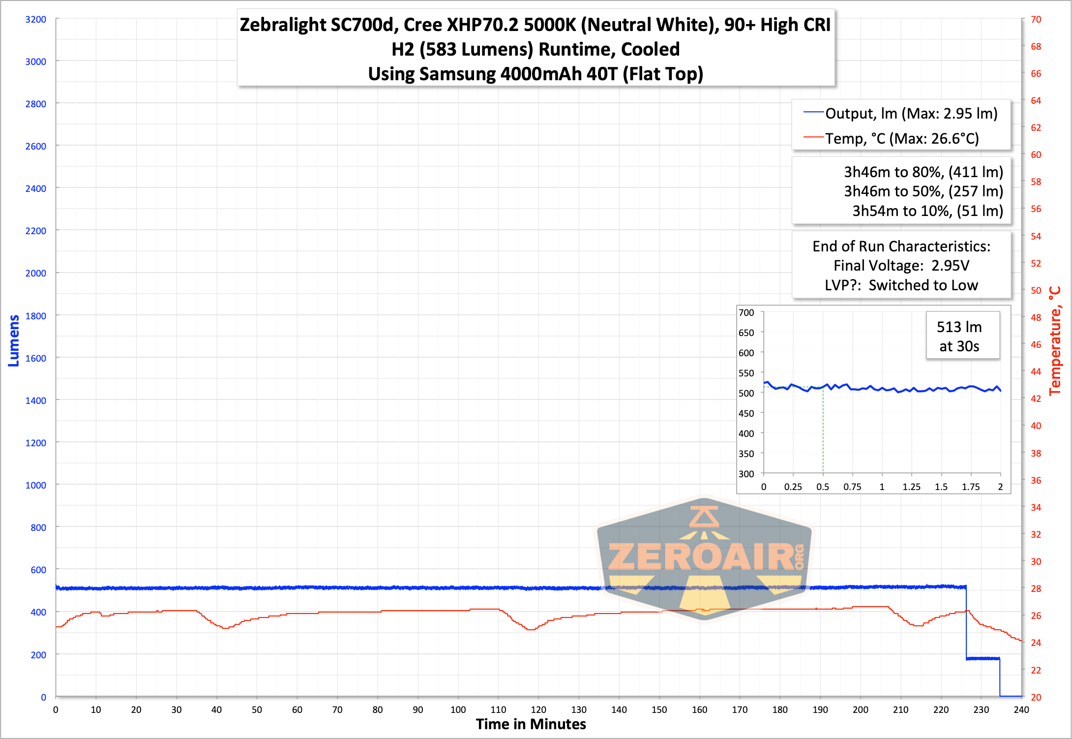

The reason I wanted to do this is because it just bugs me that my zebra light s700 can hold 400 lumens for 4 hours and yet malkoff is less than 2 hours of regulated runtime, that just bugs the hell out of me

I don’t know how to quite explain it, but I just think the way malkoff puts his drop in inside of the body is genius, however, the run time of the m61/m361 compared to the zebra light is not even remotely the same
