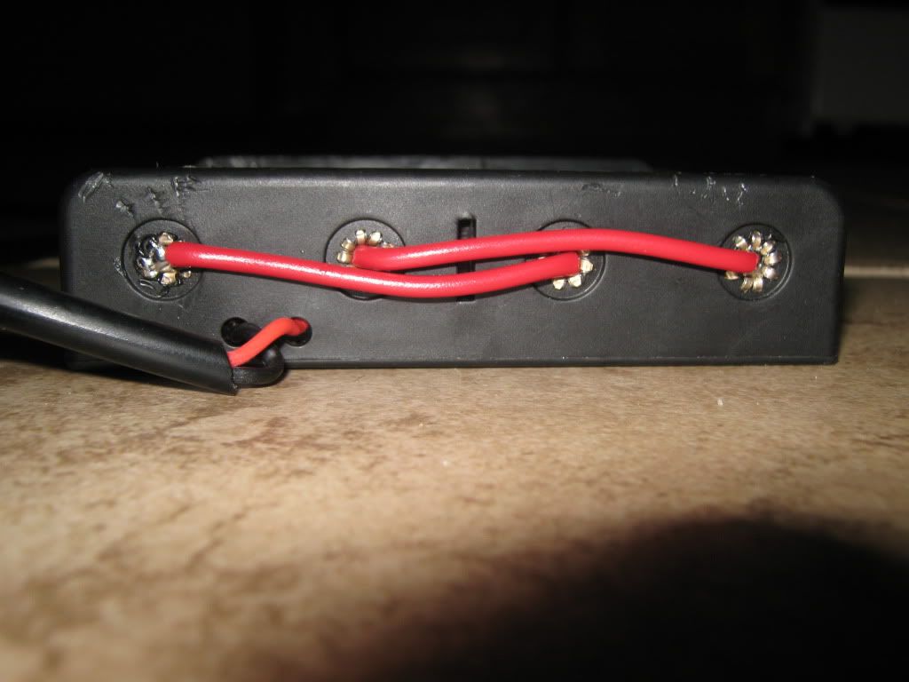

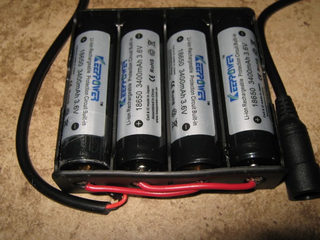

i threw this together quick just to get commentary going on the right way to do it. please pick it apart.
fire away. i know its not completely packaged up nice but….
Kevin, when using li-ions in series it is recommended that you balance charge them rather than bulk charge.
in this application i would charge cells separately in xtar or nitecore charger then install in battery pack. good? bad?
^^^^Good.
13,600?
In series your voltage adds up for the number of cells 4.2vx4= 16.8v and your mah’s stays the same as one cell (3400mah). In parallel the voltage stays the same 4.2v as a single cell and the capacity (mah) adds up (13600mah). In parallel the batteries act as though it is one big li-ion at 4.2v with what ever capacity the total amount of cells give you. In parallel they can also be charged with out a balancing wire. The charge rate can also be increased because the current is dividing between the cells. So if you charge the paralleled cells at a rate of .5C (.5c x 13600mah) that’s a rate of 6.8amps. Just make sure when putting cells in parallel that all the cells measure close in voltage before you connect them together.
my pack is 2S2P 8.4v. so 6800mAh?
Correct. :slight_smile: The charge rate can be doubled over what a single cell would be.
thank you. me personally, i am not interested in charging it as a pack. i will just charge them seperately in a quality charger. otherwise i think it would be prudent to build a pack with balance charging leads and use a hobby charger to charge multi cell pack. any thoughts on the safety of my set-up.
Shoud be good to go. I would mark these cells and keep them together as a pack. So that they will tend to see the same usage. Just remember their individual voltages needs to be close to the same before installing them in the holder. Panasonics are known to be good quality cells.
thank you. my charger hits 4.18-4.19 everytime. so far.
cool… i think i like that idea… it’s easier to build and monitor the batteries :slight_smile:
now what if… i want it for longer period, can i link 2 of those together?
i think i can get some “cheap” protected sanyos from fasttech :smiley:

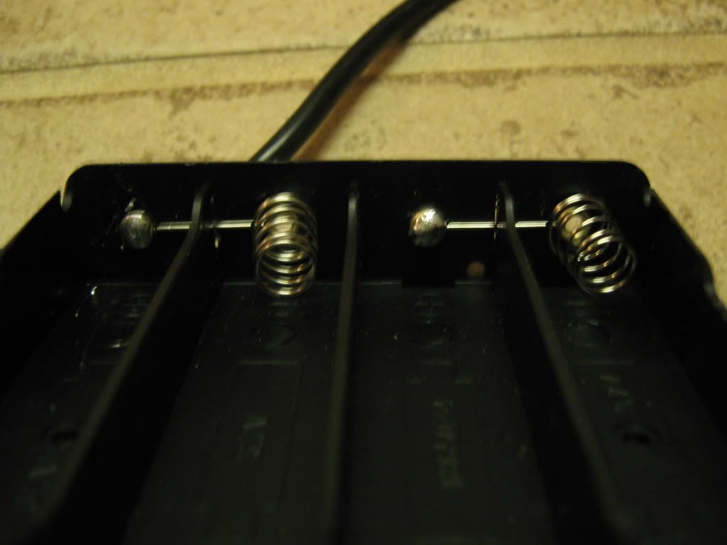

i think it would be possible to attach two of those battery carriers back to back to create a very large capacity pack. just be careful on your wiring. don’t want to short circuit anything. anchoring the power cord to the battery holder would be a good idea too. handling the battery pack could weaken the wires where they are attached to the pack. some other ideas: a velcro strap to hold batteries in the carrier, cover all wire connections so no short circuits, use trail tech or magicshine connectors (heavier wire and more positive connection). the carrier i pictured was not a plug and play unit. started as a 4S1P holder and was modified to its present state. careful attention to wiring and distance between posts(see solder blobs on terminals)to adjust distance for keepower 3400 18650 batts.
