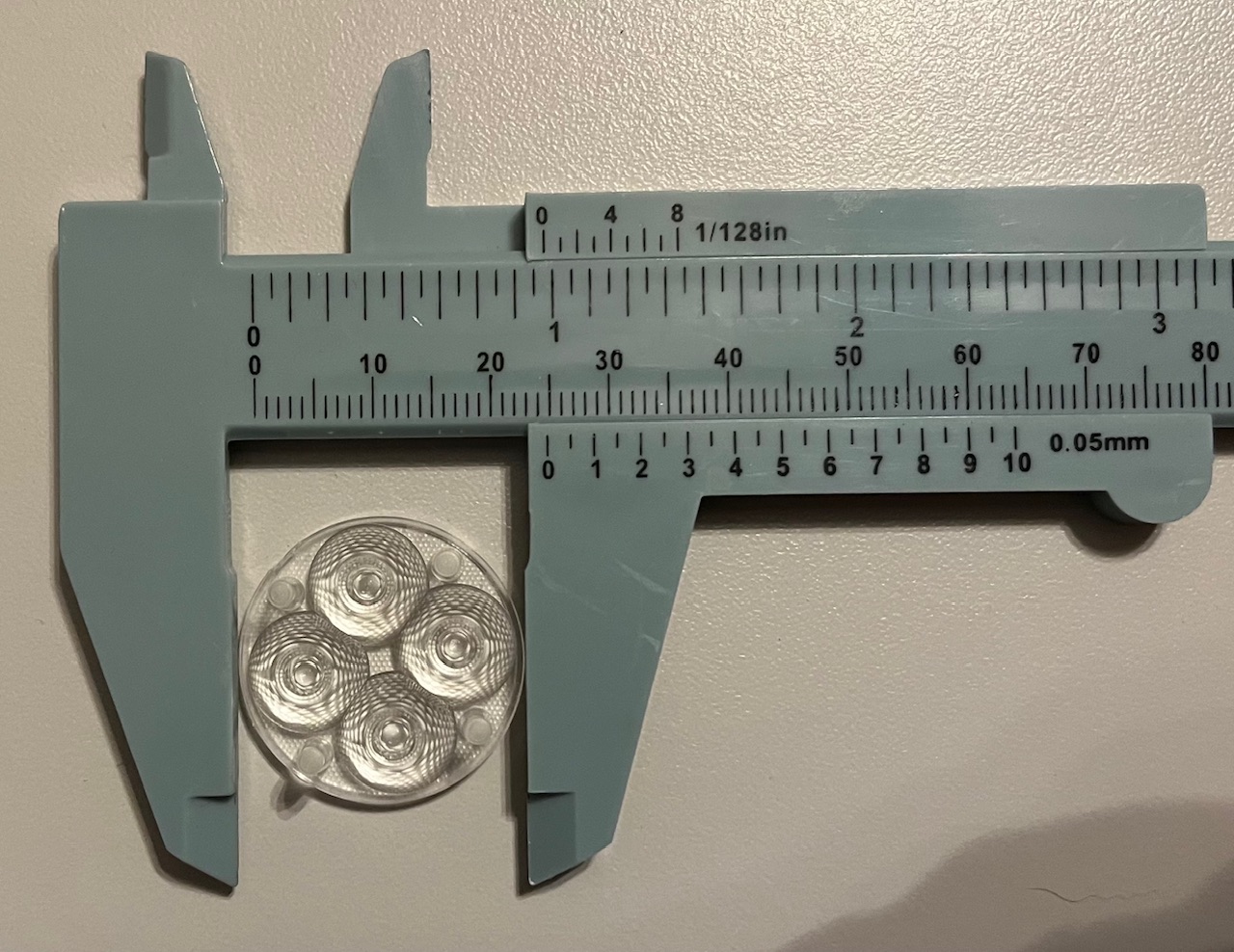

25mm🥲
Good news is that only 23.5mm of the diameter is optically effective, so I suppose one can sand that down the same way one does a 20mm optic to fit a T3, though the latter is quite lossy.

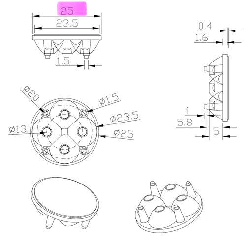

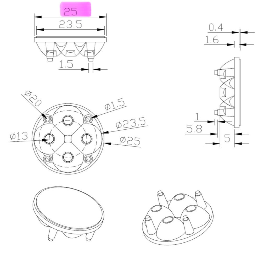

TS25 optic is also similar/same.
It’s 25mm:

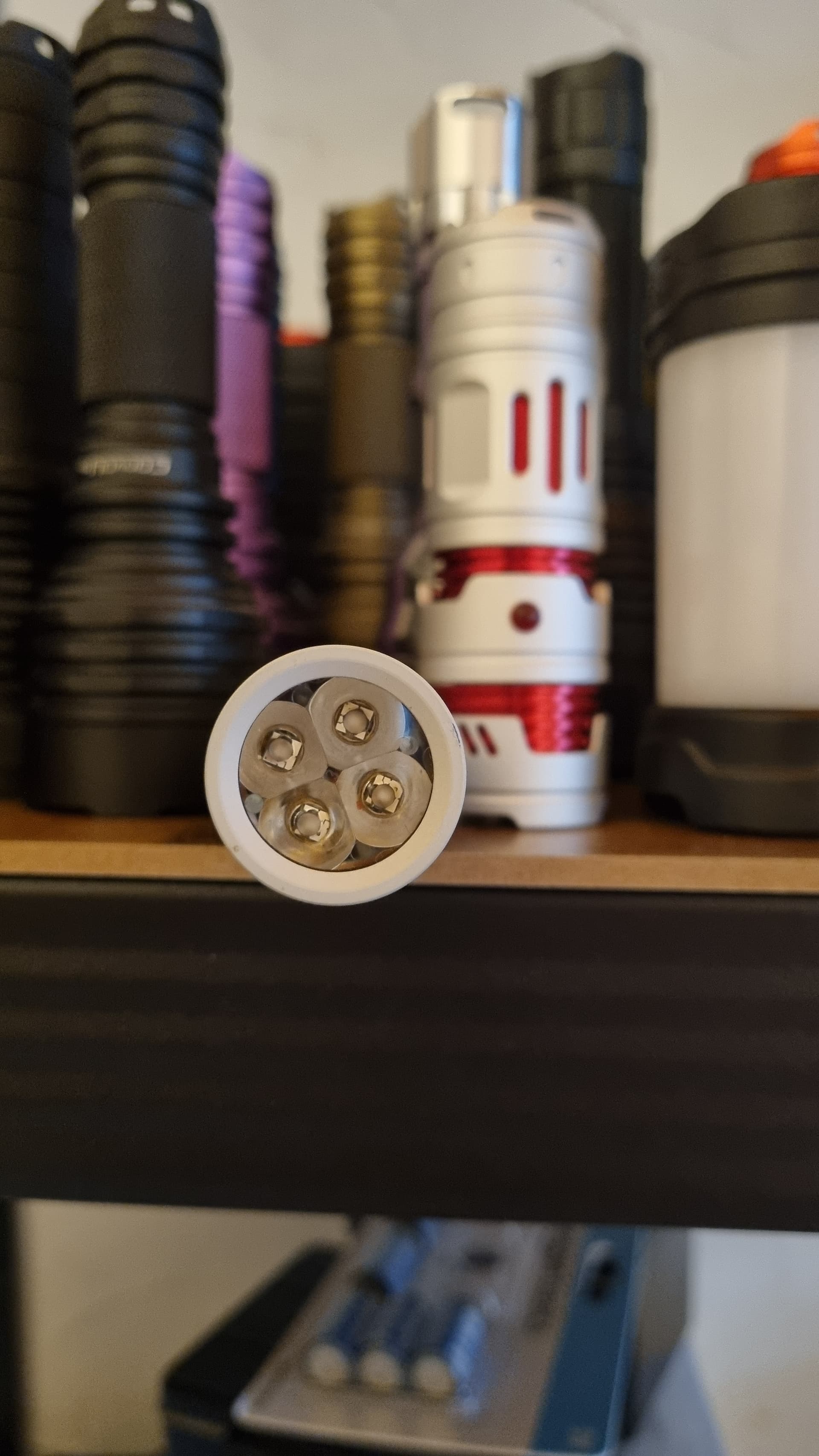

I don’t think you’re losing much output with those overlaps
(SST-20 DB)
I never said it was losing much output, only that a good portion of the optic is covered. Also, I see you’re using a different optic than the Carclo 1062X I was referencing. It appears you are using a Kaidomain quad optic which has ~1.6mm smaller diameter.
I couldn’t remember but yeah
it was the KD TIR that I used
