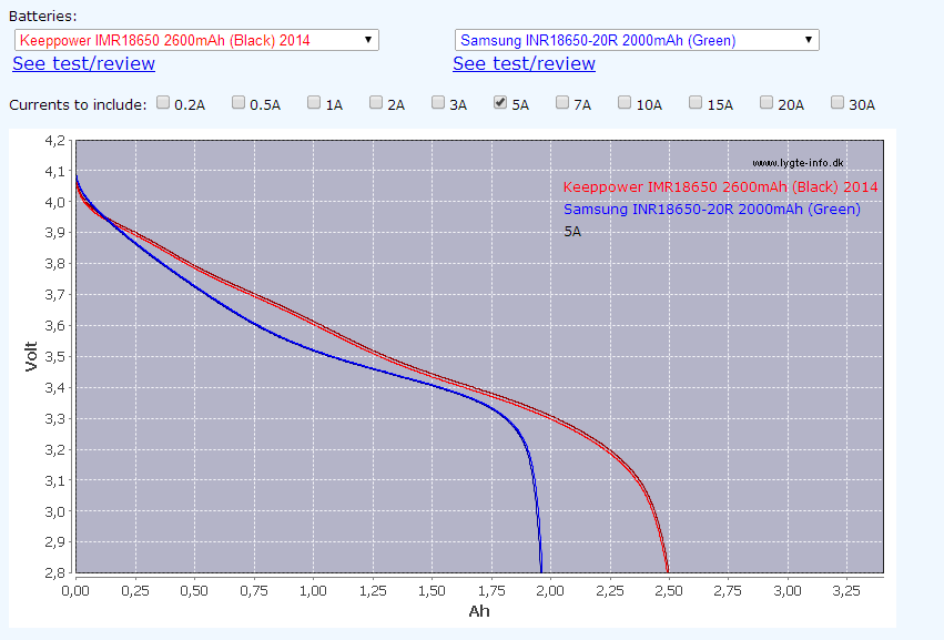

I am also going to build a C8 at 4.4A and am wondering whether to go with the VTC5’s or the Samsung 20R’s?
The VTC5’s have higher capacity but cost considerably more than the 20R’s.
I also see very little benefit in the extra capacity while under high load.
Comparing the graphs by HJK there is little benefit for the extra capacity in the VTC5 over the 20R.
The VTC5 cell in the graph (assuming that the keeppower cell is in fact a VTC5 due to sharing exactly the same specs) displays only 150mah more capacity down to 3.7v at 5A compared to the 20R.
As is evident by the graphs (unless I’m reading them wrong lol) the VTC5 provides only a few extra minutes of runtime down to 3.7v at 5A. Considering that the VTC5’s are almost twice the price (on fasttech) which cell should I get?
You should also consider Samsung INR18650-25R . $3 cheaper per cell, and compares well next to the VTC5s
Thankyou dru-dragon :slight_smile:
I looked at the graphs by HJK and the 25r holds up very well to the vtc5.
Thanks for everyone’s very insightful recommendations :wink:
