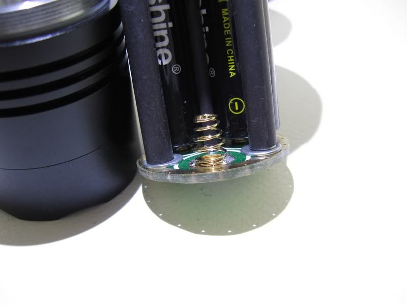

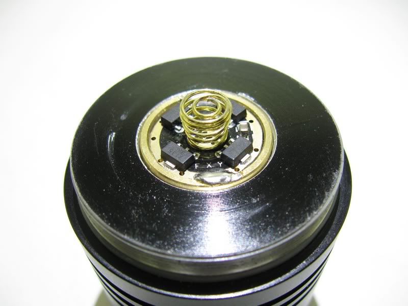

Driver :
5 modes , 8*7135 38L , 3.03A on Hi
Change to next mode click switch on between 25-30 seconds, And turn to Hi mode after turn off 25-30 seconds.
Fit about 68-69mm of batteries. 69mm up batteries are too long.
I use washer to extend battery tube.

I wonder how good the driver is (considering it'd be very hard to swap, for obvious reasons). Not sure whether I want to order it now or wait for a review, hmm..

Driver :

Hi Pok...nice review. I can't wait to get mine, it should be here very soon. We use IPAD'S and IPOD's here and why I wanted it for charging purposes. Overall, I think the 8*7135 38L is a good driver because power isn't wasted up in the 4a range as heat. So at just over 3a, there should be very little sag from heat and in a good power range for an XM-L. I'll have to see if I can disable the blinky modes when I get mine, but otherwise I'd say this seems like a good buy.
