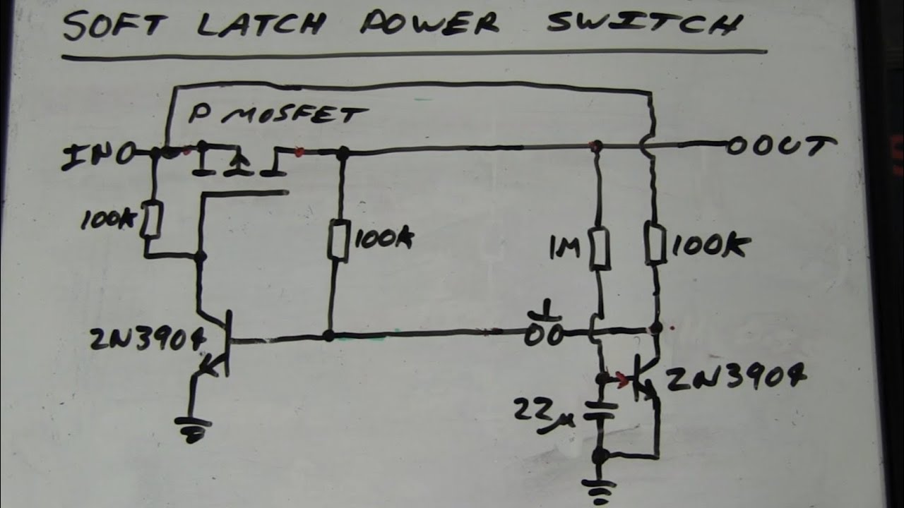

As suggested do you have room to make an electronic switch?

I’m still wondering why someone hasn’t developed a soft latching power switch
Activating a FET would allow HUGE amounts of current to be pushed with a teeny tiny push button (that is silent by the way)
Solid state high current latching switch
Isn’t that how some flashlight with a small switch on the side work? Or is that switch controlled by the ”controller?
Side switches are simply wired to a input leg of the MCU, pressing it grounds that leg.
Ok, so the disadvantage is that the MCU is always powered on, draining the battery? (compared to the EEVBlog solution)

was about 200uA on my SRK and considered high. Drains a battery in 2 years
