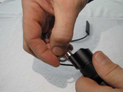

I recently posted about the PTS-3 and probably made the comment you are referring to. There is a definitive “snap” or “pop” when you press on the switch hard enough to activate. It’s the only switch I’ve used that makes any significant noise in use. Not a big deal for law enforcement high speed operations, but could be an issue at the closer ranges required for bow hunting.
The PTS-3 has a rectangular rubberized cover over the switch. Most pressure switches are covered with what is basically heat shrink. The switches I have for XTAR lights are extremely quiet, as are some generic ones I have ordered from DX and Manafont.
