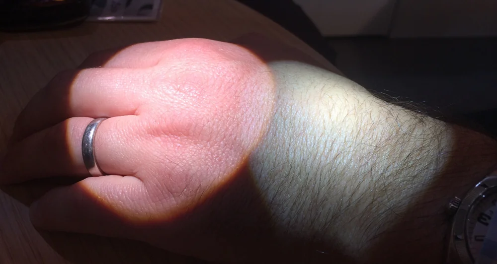

skin tone with high cri and low cri
Is that the same CCT?

3500K R9080, 3000K R70. Skin looks very similar imo. Skin only really seems to work on cold to neutral CCTs, with warm CCTs low and high CRI make almost the same skin tone. The camera heavily exaggerates the greenish skin color of the S21E, to my eyes it looked almost the same.

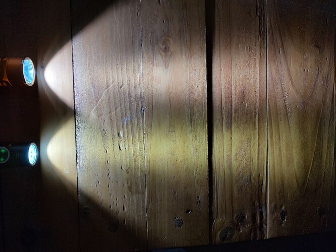

Another way to test is to shine at wood grain, can you tell which light is High CRI:
