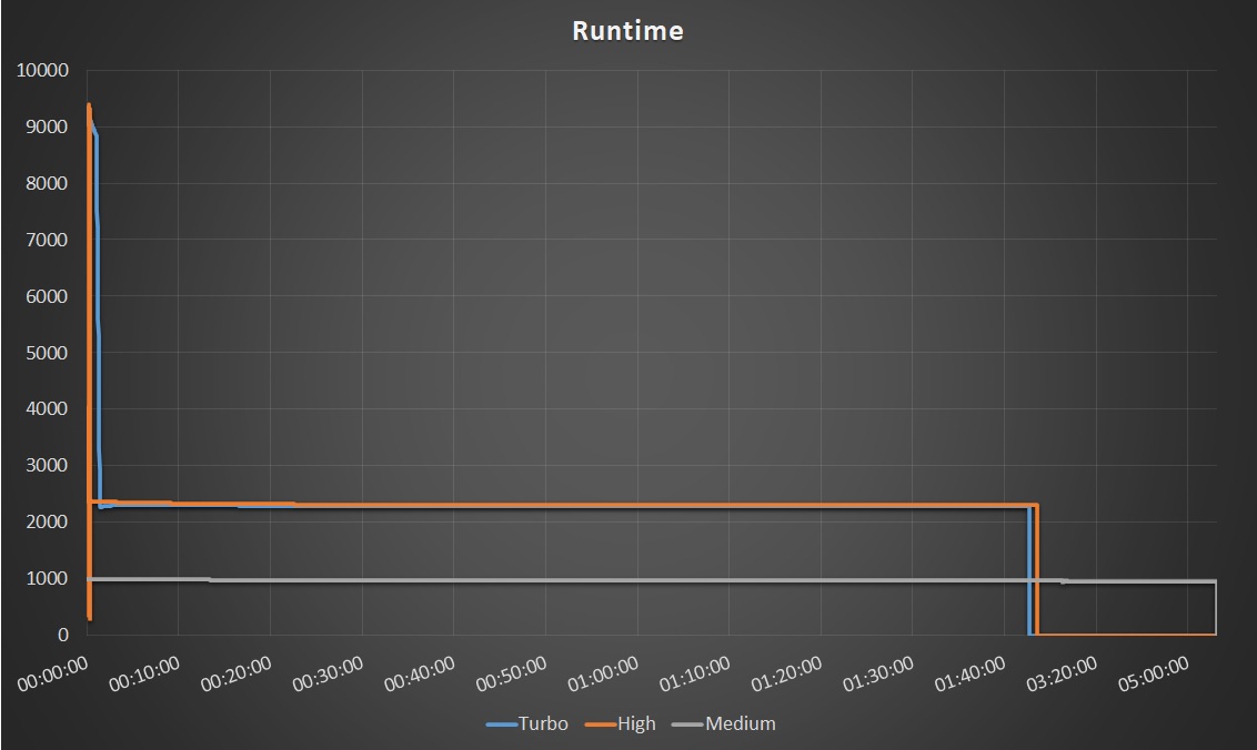

I have a problem when trying to create a graph in Excel.
Up until now, I used to:
  • import the CSV file into Excel
  • replace the first few cells in the time column with “00:00:00, 00:00:01, 00:00:02” and so on
  • let Excel auto-fill the rest, knowing that the App takes a measurment every second
Up until recently this used to work great.
But yesterday, I realized that there is a fatal flaw to my technique.
I didn’t know that after 100 minutes, the app takes a measurment every 10 seconds. Therefore, my graphs in Excel would get squished 10x beyond the 100 minute mark.
I only realized this after uploading a 5 hour runtime, only for it to show up to be 2 hours and 10 minutes.
Right now, even if I autofill the time to 100 minutes and then autofill again correctly after 100 minutes, the runtimes are still squished, but with the correct time on the bottom.
I tried different ways to approach this problem but I can’t find a solution.
What’s a good way to create runtime graphs from a CSV file? A video of the process would be much appriciated.

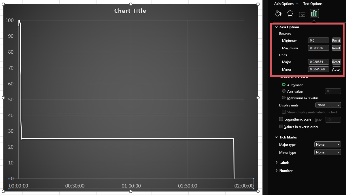

Are my Bounds supposed to have such bizzare values?
This makes it quite a bit more difficult to set the units, I need to bruteforce and guess the right value until it’s correct.
I did format the Time column as duration ( [h}:mm:ss ).

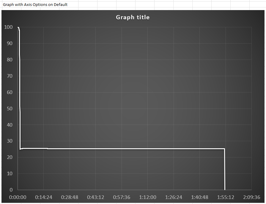

Here’s how the graph looks like if I leave the Axis Options settings at default:
Your bound values are minutes/1440
For example your Units: Major is 0.020834 * 1440 = 30 minutes
Etc.
There might be a way to correct this automatically but something like this I’d make a table and enter manually. You should only have to do this once for template and adjust for very long or short runtimes.
