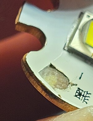

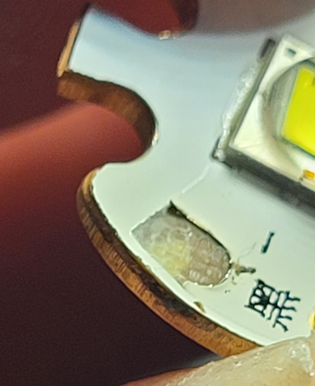

I tried something like that recently cuz I was getting impatient. I was able to pull the wire off its solder pad on the board but the whole solder pad came with it
Side note, is this board still usable if I solder to the other pad
Just check to where the other sections of the traces go, you can usually make it out from the height difference. You could scrape away a bit of the the white insulating layer, then use a multimeter’s LED testing function. If that lights up the LED you have the right area and you can scrape away a bit more and then solder to that.
