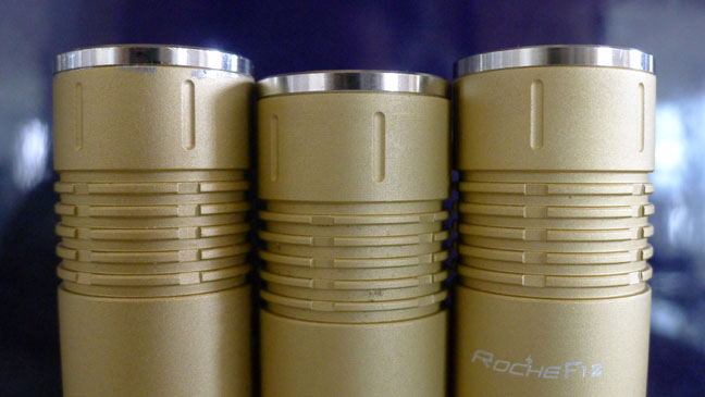

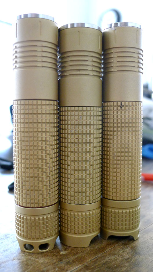

That is weird. If you have time may we get a pic of them standing next to each other?
Actually, they ALL look to be of different lengths. They are different Mahs, but that shouldn’t make any difference.
The ruined annodzing on the left top Roche occurred when i was trying to get the bezel off with cloth-covered pliers, but slipped. URGGGGGGHHH!
