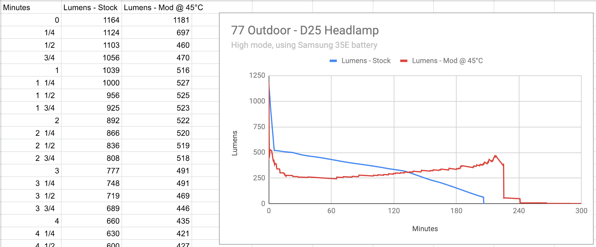

Well… thermal control is working, but appears to be a bit conservative. The body stayed at 45°C (113°F) throughout the run. I think I need to kick that up a notch and hopefully avoid the initial big drop. I will say that when I ran this test with the stock D25, it got hot! I need to find the middle ground. Thoughts on an ideal temp?
45C looks good. Do we need 1000lm in headlamp? I think more important thing is long run time and stabilization of modes.
…where Frugal meets with Flashlight! :smiley:
If you decide to sell pre-flashed MCUs I’d be interested in a couple.
I think 1000LM would be great for the outdoors, personally I can never get enough light in the dark.
Yes . 5000lm would be great even more . But first of all you have to understand technical parameters like heat dissipation. This tiny body can not handle more than 1A. 1A is about 300lm of warm 3000k HI-CRI light. And if you need more throw , you can always use narrow angle optics
