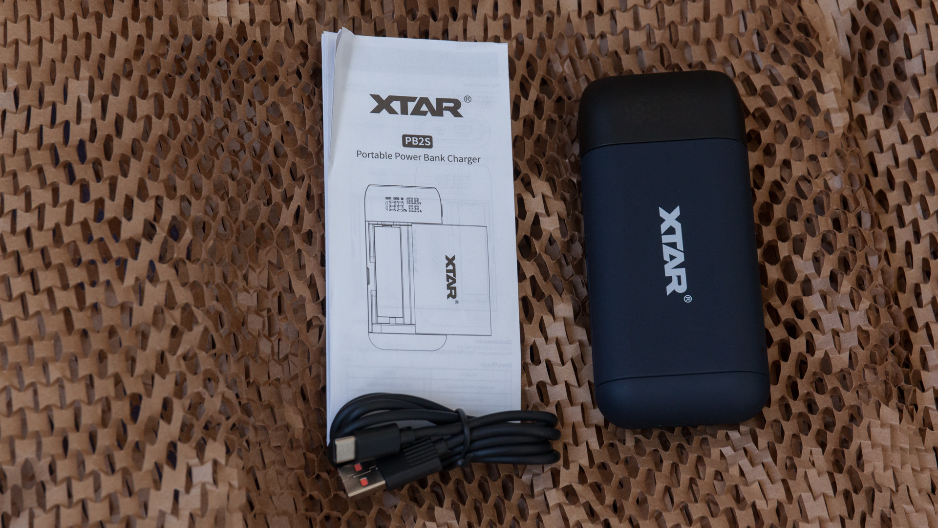

The design is quite decent in white and blue cardboard packaging.
Inside: the device itself, type-c cable and manual.
To my pleasant surprise, I also received 21700 and 18650 batteries. The first could not be determined, judging by the characteristics of the latter, inside the usual VTC5A.
Another add-on was the QC charging unit. Well, not that I need him, but why not)
So, let's look at the device itself. Outwardly, it is a relatively compact blue-gray remnant with a soft-touch coating.

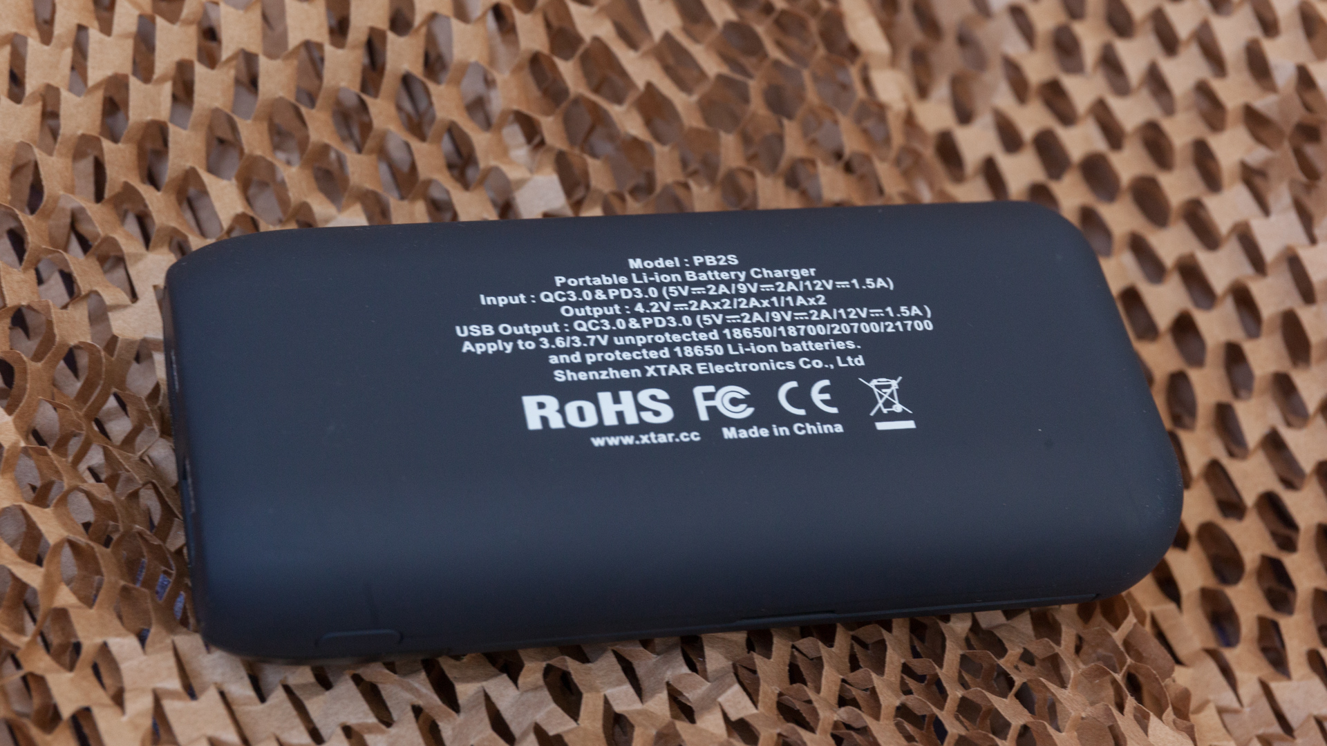

On the reverse side are all the basic technical data.

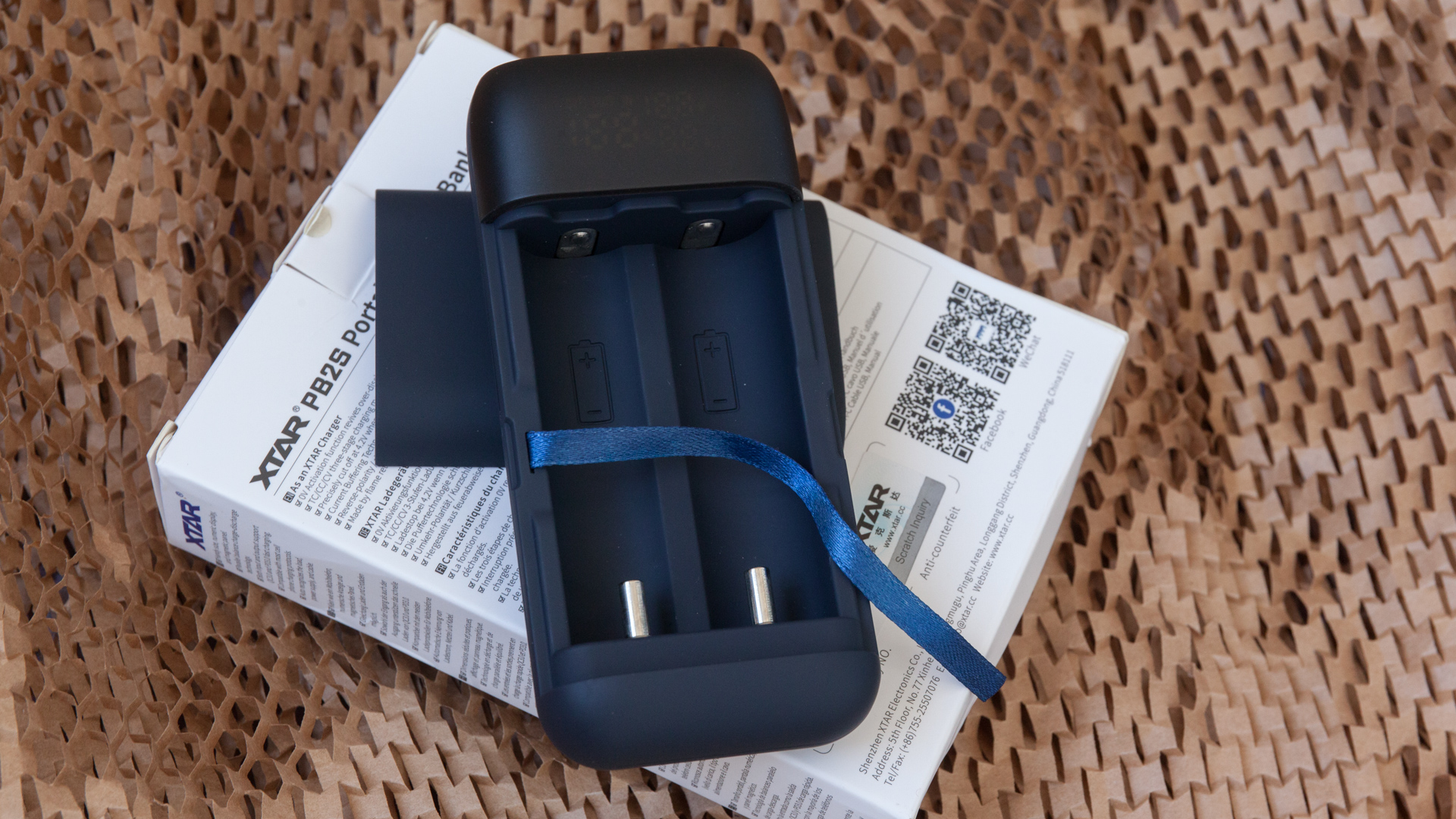

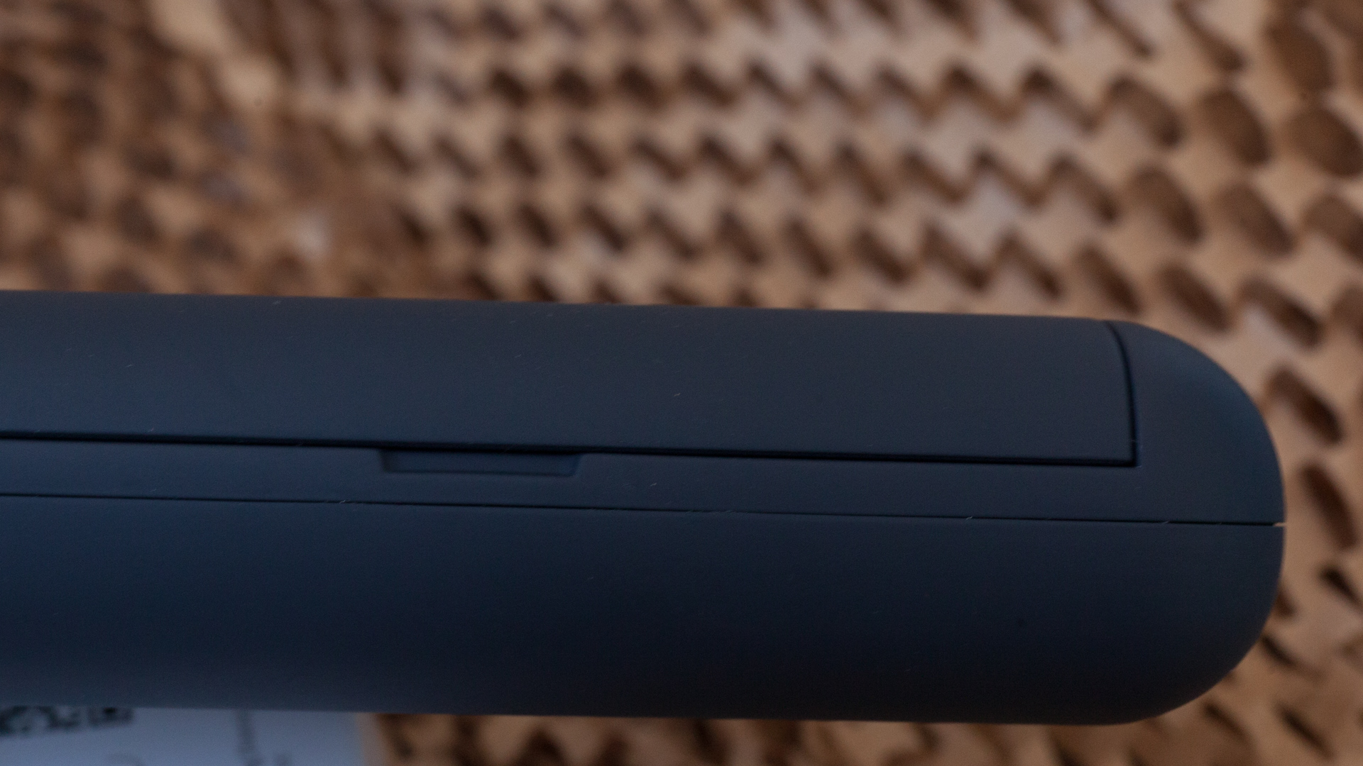

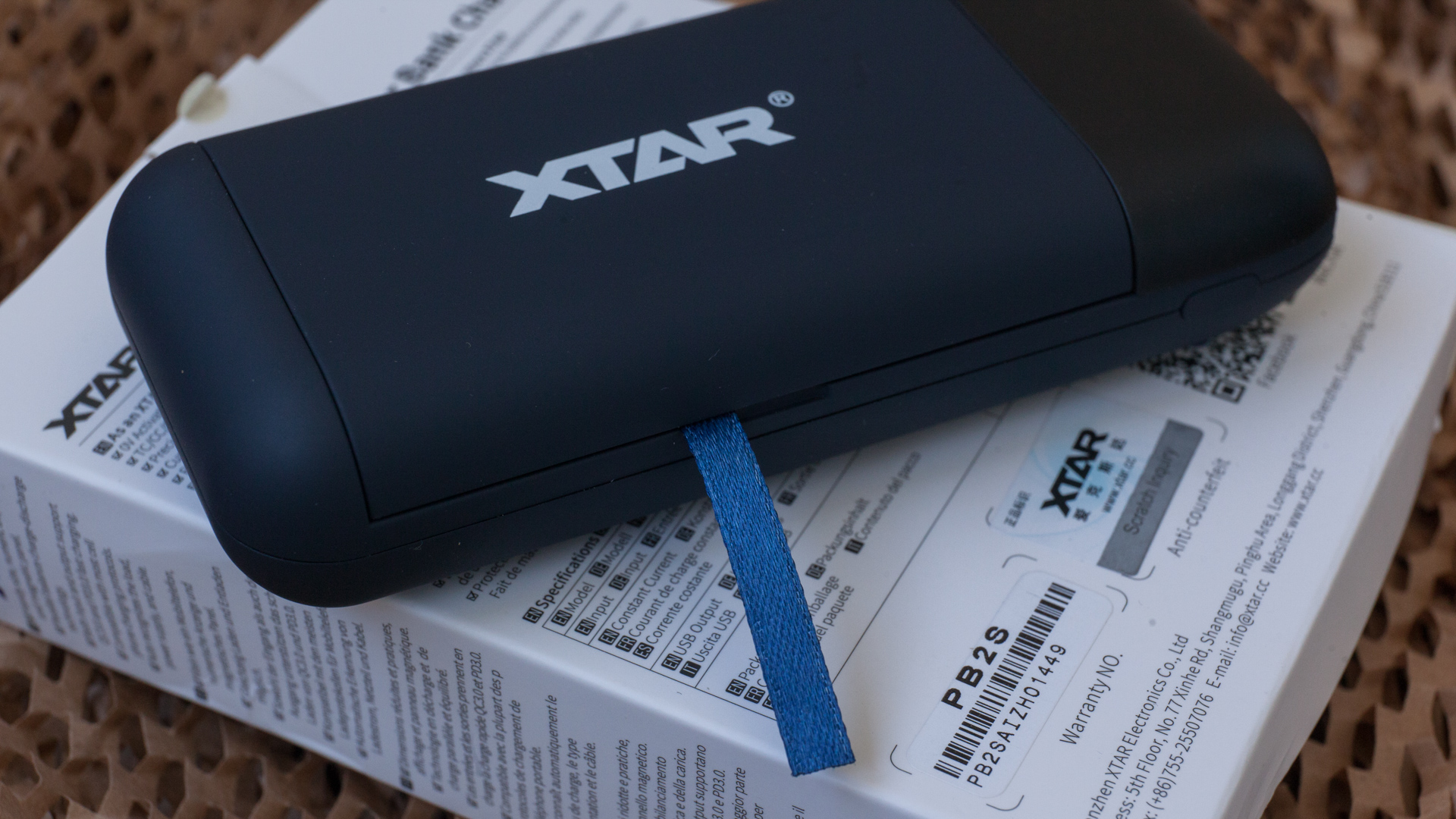

The battery cover rests on magnets and holds firmly. To remove the cover, pull the tail sticking out from the inside. Of course, if you wish, you can remove it and lift the lid without the tail, for this small grooves are visible.
For a long time I use a device similar in functionality from soshine. That's just due to the presence of a spring-loaded contact rod Xtar PB2S supports two additional battery sizes in addition to the usual 18650: namely, almost never used 20700 - in contrast to extremely promising and increasingly used 21700.

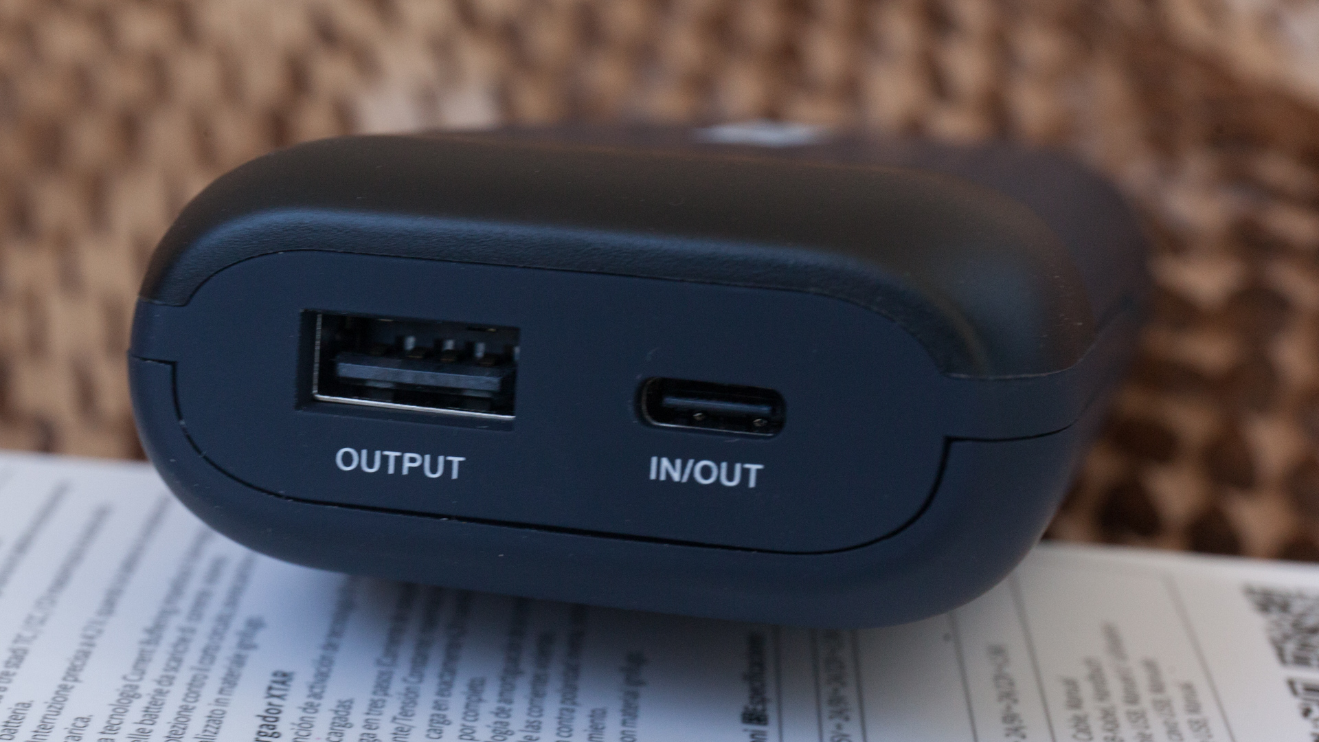

From the end above the display are two in \ out connectors: USB-A and Type-C.
That's all with regard to appearance. The design is attractive, there are no obvious manufacturing jambs (backlashes, gaps, defects in plastic molding). There is a question for the soft-touch, in the review at BLF here, people complained that in the future such a coating will wear off to an unpleasant gloss over time. I don’t look into such distant prospects, and even if this happens, then I will not openly give a damn until the charging functions as expected.

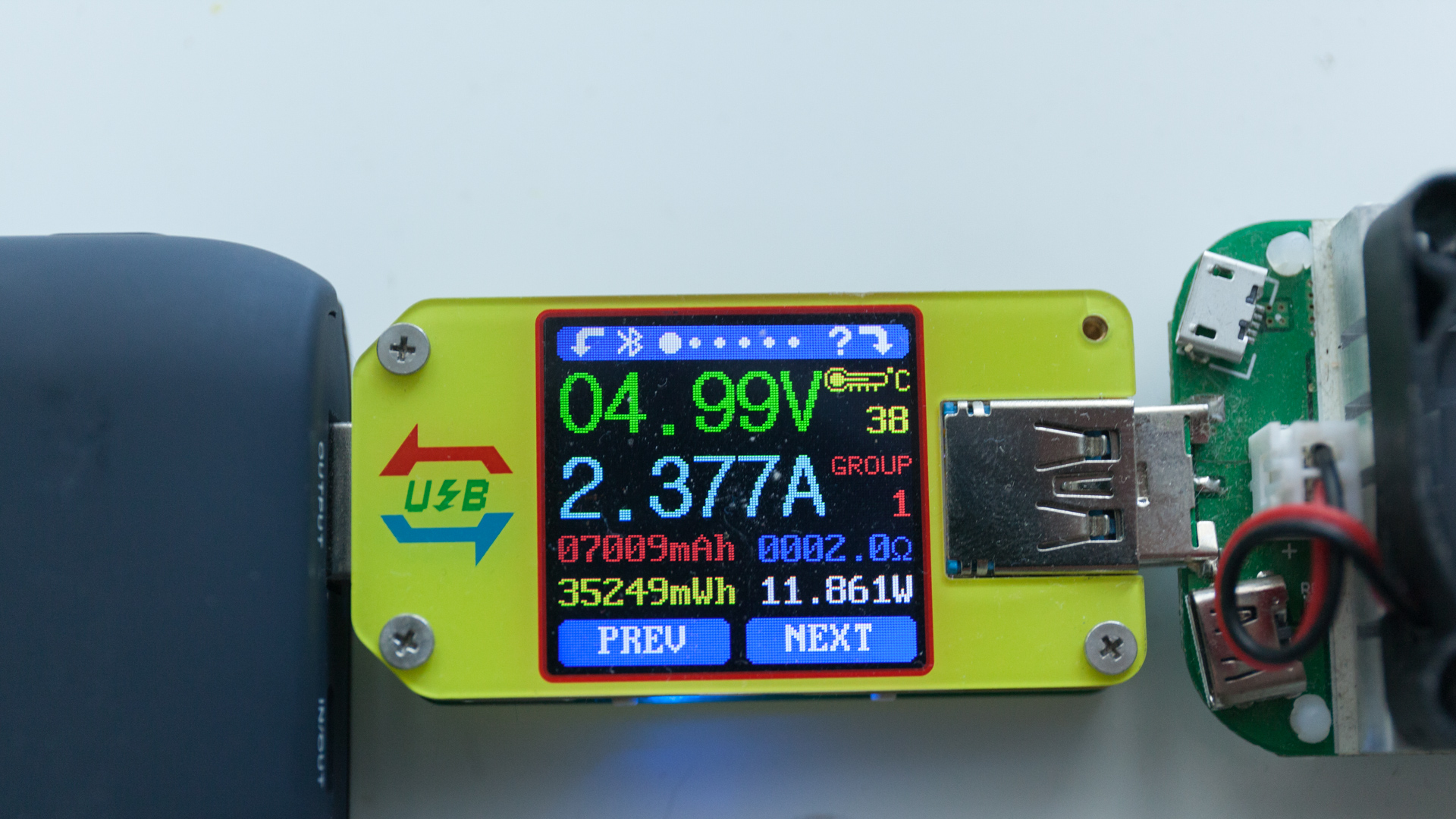

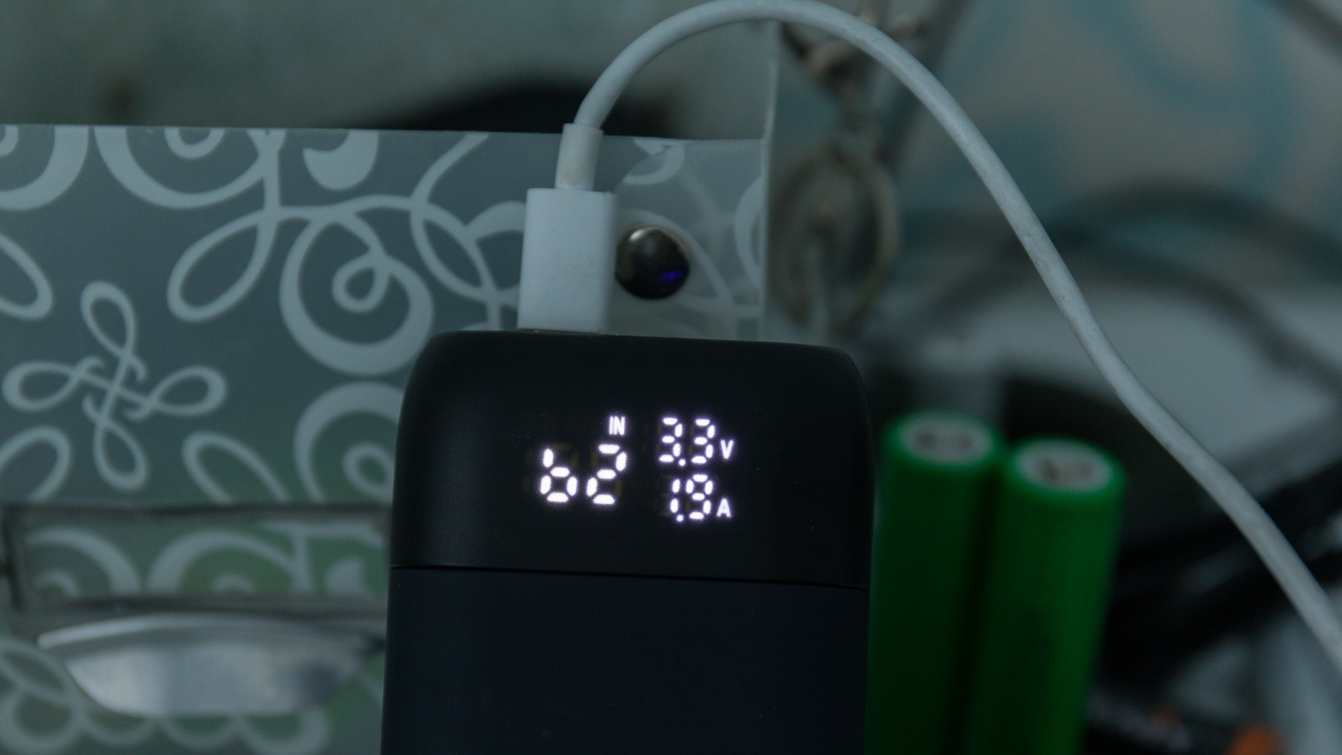

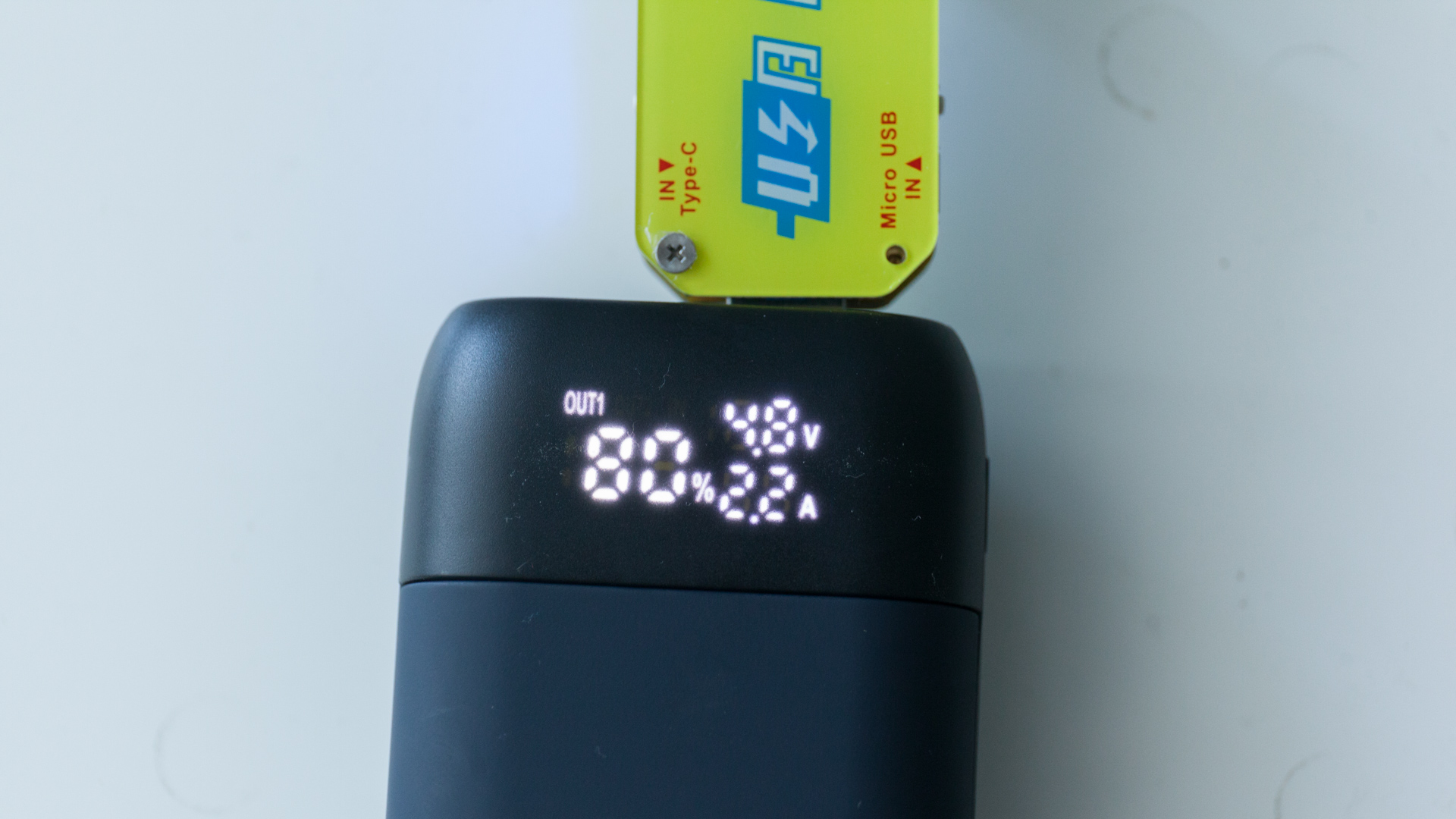

I'll start with the display. Charging is two-channel and by pressing the button you can see the data for each channel.
That's just ... that's just I would not trust these readings, they differ from the data on the screen of the USB tester. Fortunately, difference is minor. It would be unpleasant if the powerbank overstated the amperage, currrently it underestimates it. See for yourself.
In fairness, an error within 0.1-0.2 volts and amperes will offend the perfectionists more likely. In real use, I do not care. I contacted a company representative, they said that I received one of the early samples, there is some variation.

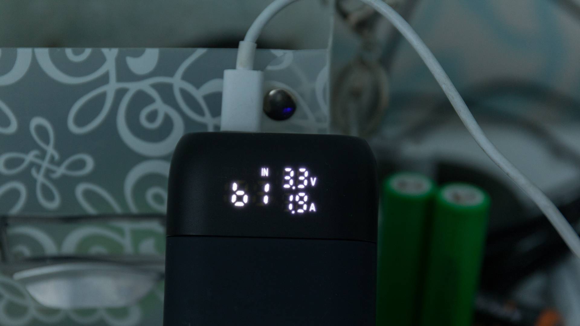

Charge 2x 18650 (Sony VTC6) QC3.0
incomprehensible drawdown in the middle of the chart.
For Li-Ion, a comfortable charging current lies within 0.5C, i.e. 1.5A for a 3000mah battery. In principle, it can be charged with QC. 21700, the bank will definitely be no harm. charging time is very good

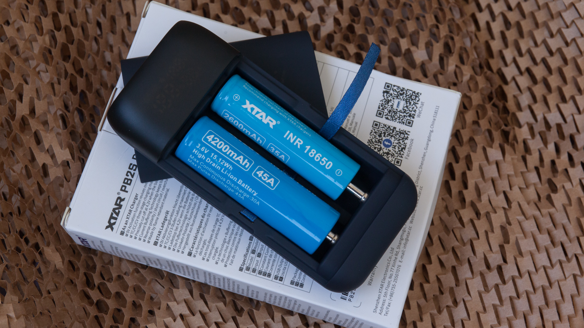

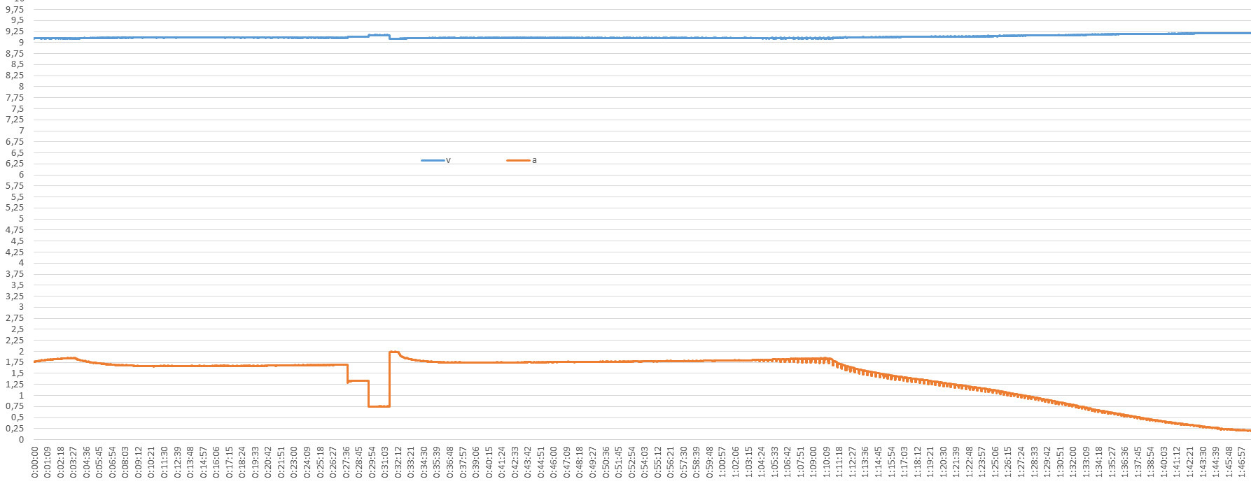

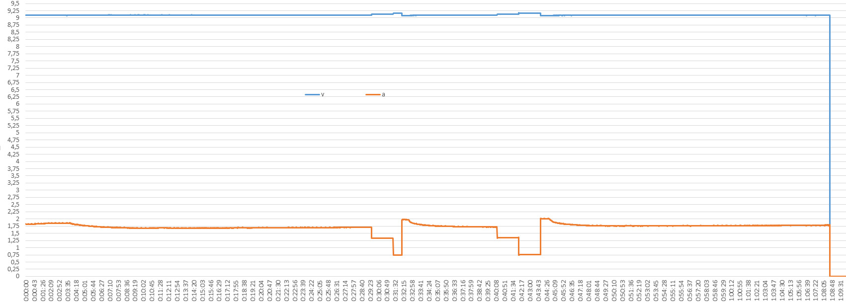

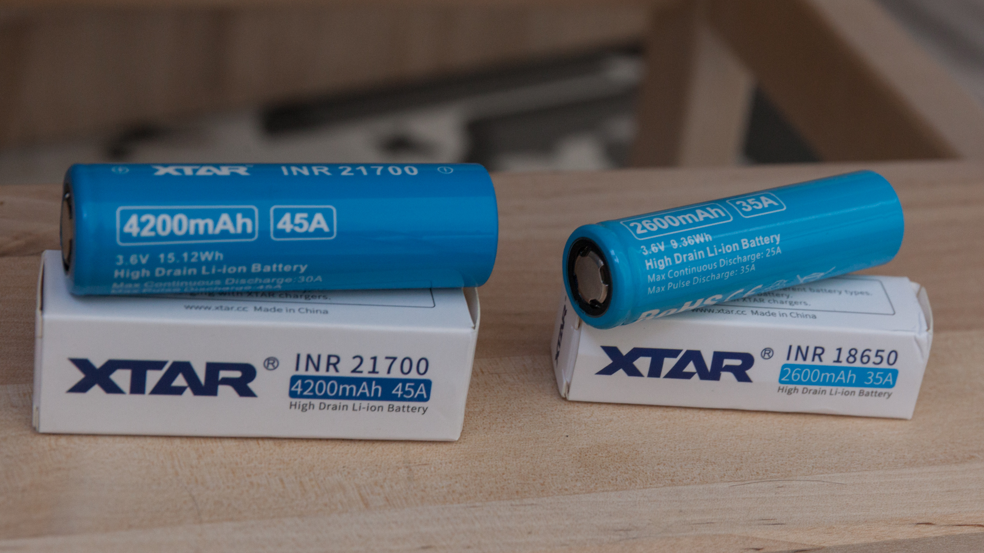

For a mixed charge of 2600mah 18650 + 4200mah 21700, I used the batteries included in the package.
What immediately catches your eye is two steps in the middle of the graph. My symbolic knowledge in electrical engineering is not enough to identify them, I could reflect them on the graph - and that’s good, I think that there are understanding people here.
The second point, I did not see the CV phase here, then the focus was on the same level.

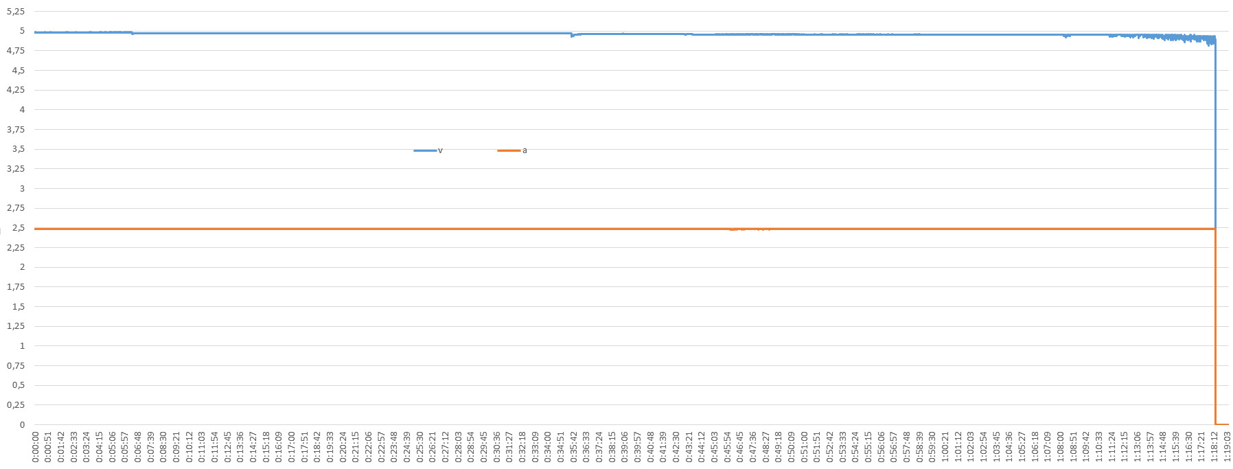

Discharge

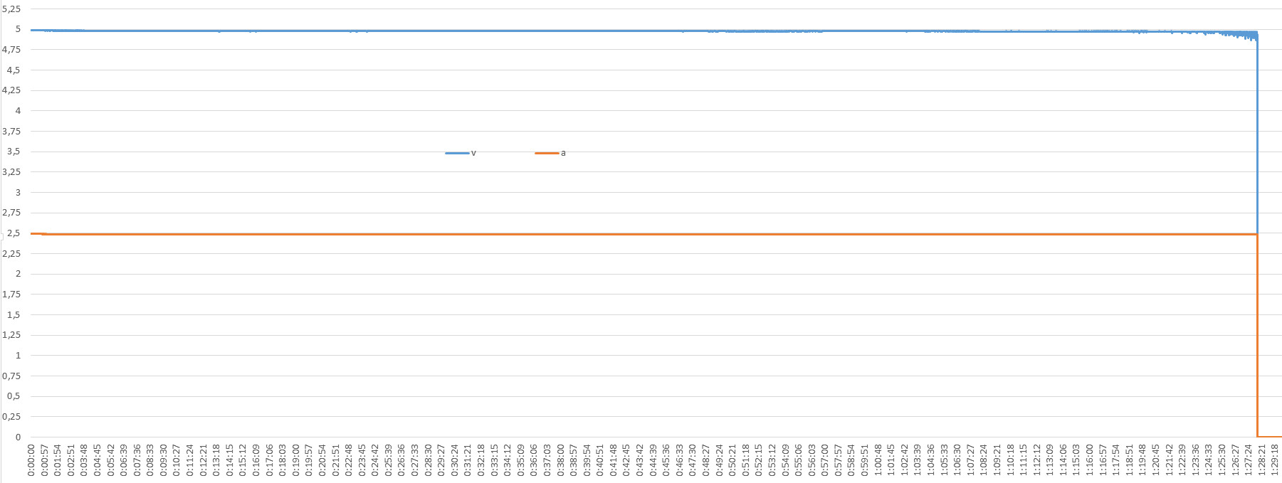

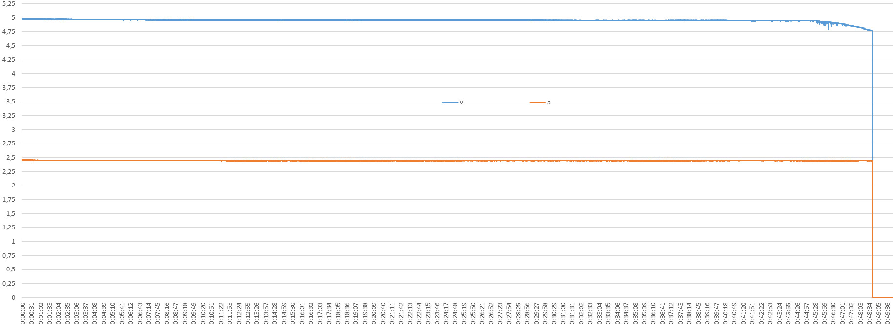

The specification indicates that on USB 5v you can expect 2A, but I got 2.5A without any problems.
From 2x Sony VTC6 i got 3545mah.
Adjusted for voltage conversion, it would have to be about 4200mah, received 84.5%. The difference is quite noticeable.
But, I am sure that when the voltage on the banks drops to such a level of the order of 3.2v, they simply do not draw this current. A discharge with some kind of symbolic current could and would turn out to see the removed capacitance close to theoretically possible. So I won’t write down.
When discharged from one batery , the same 21,700 current is kept without drawdowns. The voltage at the end - 3.35v

Well, the same mixed test, let's see how it behaves when discharged from two different batteries. In general, this situation seems rather hypothetical to me, nevertheless, as a rule, if a person has two batteries, these are two identical batteries.
so, with 2600mah + 4200mah i got 3968 (expected 4840mah), those. 82% of the expected - actually as much as the last time.
voltage on two different batteries at discharge: 3.2v for the 2600mah 18650 and 3.15v for the 4200mah 21700. it will do. The current, as above, holds well, on the same level.
