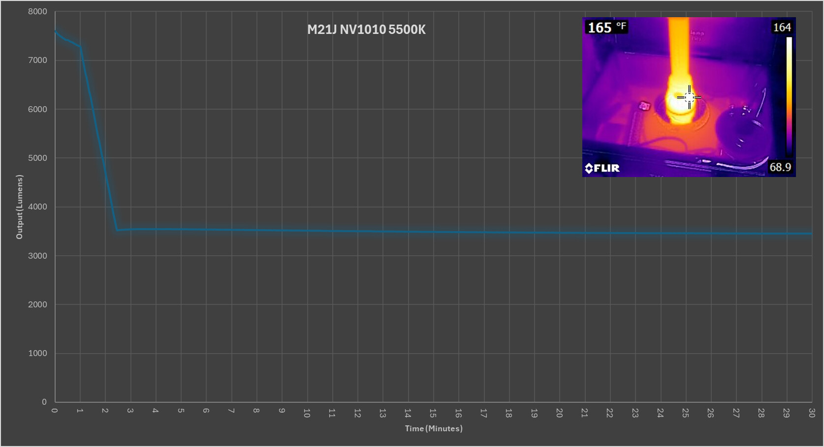

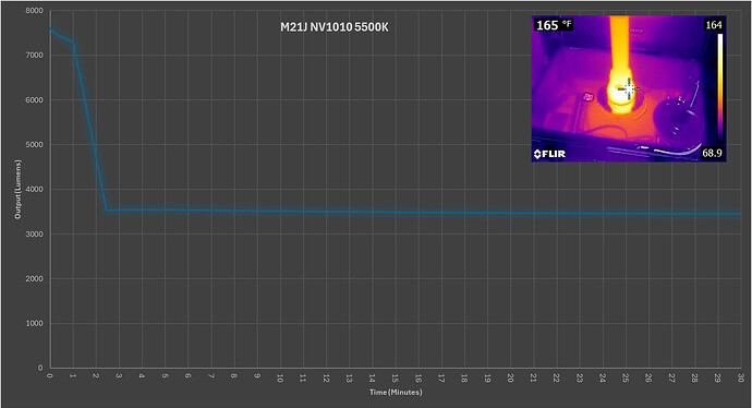

I installed an NV1010 in my M21J, it’s a monster. But, I do agree it is borderline dangerous. I tried to communicate this to Mr Simon but I don’t think he understood. I was trying to convince him to at least have only tabless cells available for it and advised to use only tabless. With the NV1010, it never drops lower than about 3500 Lm. While I love it and am all for it, this is dangerous to someone unfamiliar.
