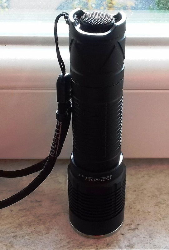

In terms of size, the flashlight is exactly between the Convoy M1 and Convoy M2, differing only in a slightly larger tube diameter. With its 134mm length, it walks right along the edge of the EDC segment. You can’t put it in your pants pocket (and there are no clip for this as well), but it fits easily in the jacket pocket. I would name it not S12, but some M# as it definetely looks like one from M model line.
The appearance of the flashlight pleases with that fact that there is some semblance of design. Personally, it seems to me that each of the knurling elements looks quite stylish, but something still does not grow together here and the budget background of the flashlight can be easily noticed. Nevertheless, the Convoy S12 looks pretty good, even if it’s not Aceabeam \ Olight, but it’s definitely not some shitfires. Yes, and the first ancestor of the Convoy S2 + looks much simpler compared to the Convoy S12.
In fact, each Convoy flashlight is controlled by a tail button, and this one is no exception. There is nothing unusual - a deep move with a pronounced click. I’m too lazy to look, but I think that some kind of phosphorescent buttons will also work here if there is a desire to upgrade the look.

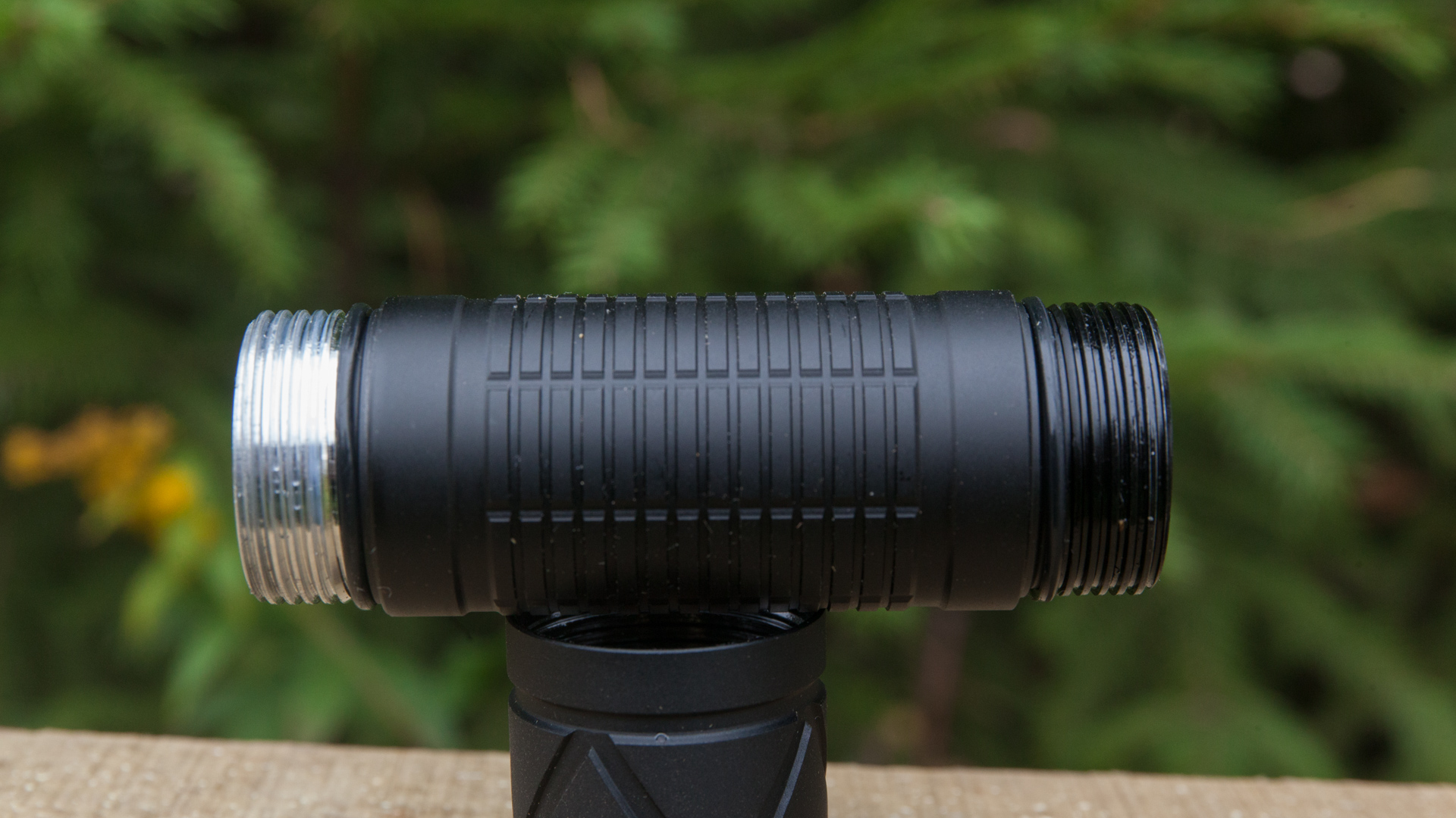

Coarse threads, well oiled. From the side of the head, it is not anodized.
Actual fact for Convoy flashlights - third-part 21700 batteries also fits in diameter, including the popular and inexpensive 21700 LIITOKALA. Of course, 18650 batteries are also suitable, and in this case, why not put a penny plastic tube adapter? Perhaps I’ll hint at this to Simon.
Knurling is large and tenacious.
The battery tube is quite long and the grip is really comfortable and sturdy.
