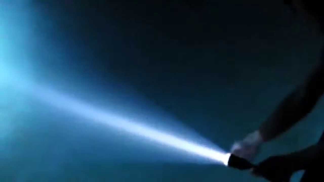

Video! ;D 1080p Fullscreen pls!
Comments: It looks really cool underwater with goggles on! Very fun! Can’t wait till the day when I whip this bad boy out and use it underwater for reals.
