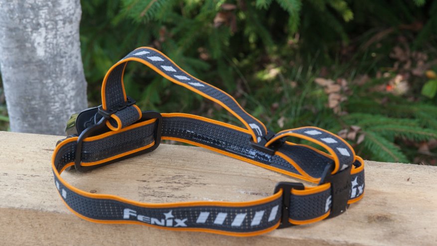

The headstrap is gorgeous here. At first impressions - the best of those seen. I don’t remember seeing a perforated elastic band. This seems like a good idea to me, as my head is sweating definitely less. The rest is the same: sweat-inhibiting gel strip inside and reflective elements outside.

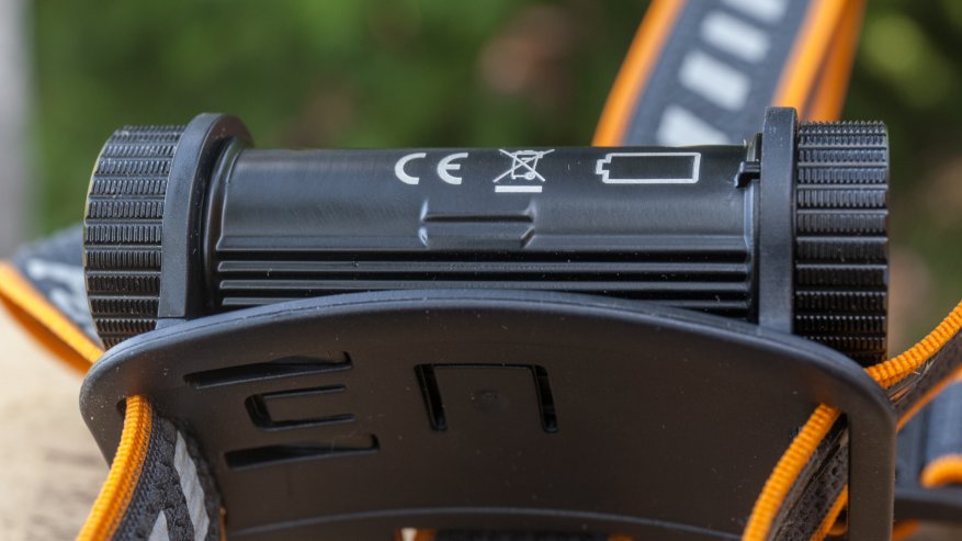

HM65R body is made of aluminium-magnesium allow , so it is really lightweight. i cannot measure it as i cannot take it from plastic mount. but, believe - it is really, really lightweight.
The spring on the cover is quite thick. But on the opposite side, Fenix put a contact plate with a limiter for using flat-top batteries. I have been and remain an opponent of such decisions.

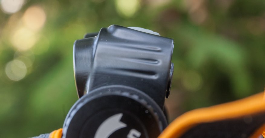

The angle of inclination is regulated by a ratchet (7 positions), which is locked by the strips below the headlamp mount. In the photo it is clearly visible. Yes, as i mentioned, it is not possible to separate HM65R and plastic mount It doesn’t bother me, it’s not an L-shaped forehead where hand-held use and magnetization are supposed. But this point is worth mentioning
On the back there is a charging connector closed with a thick Type-C plug.

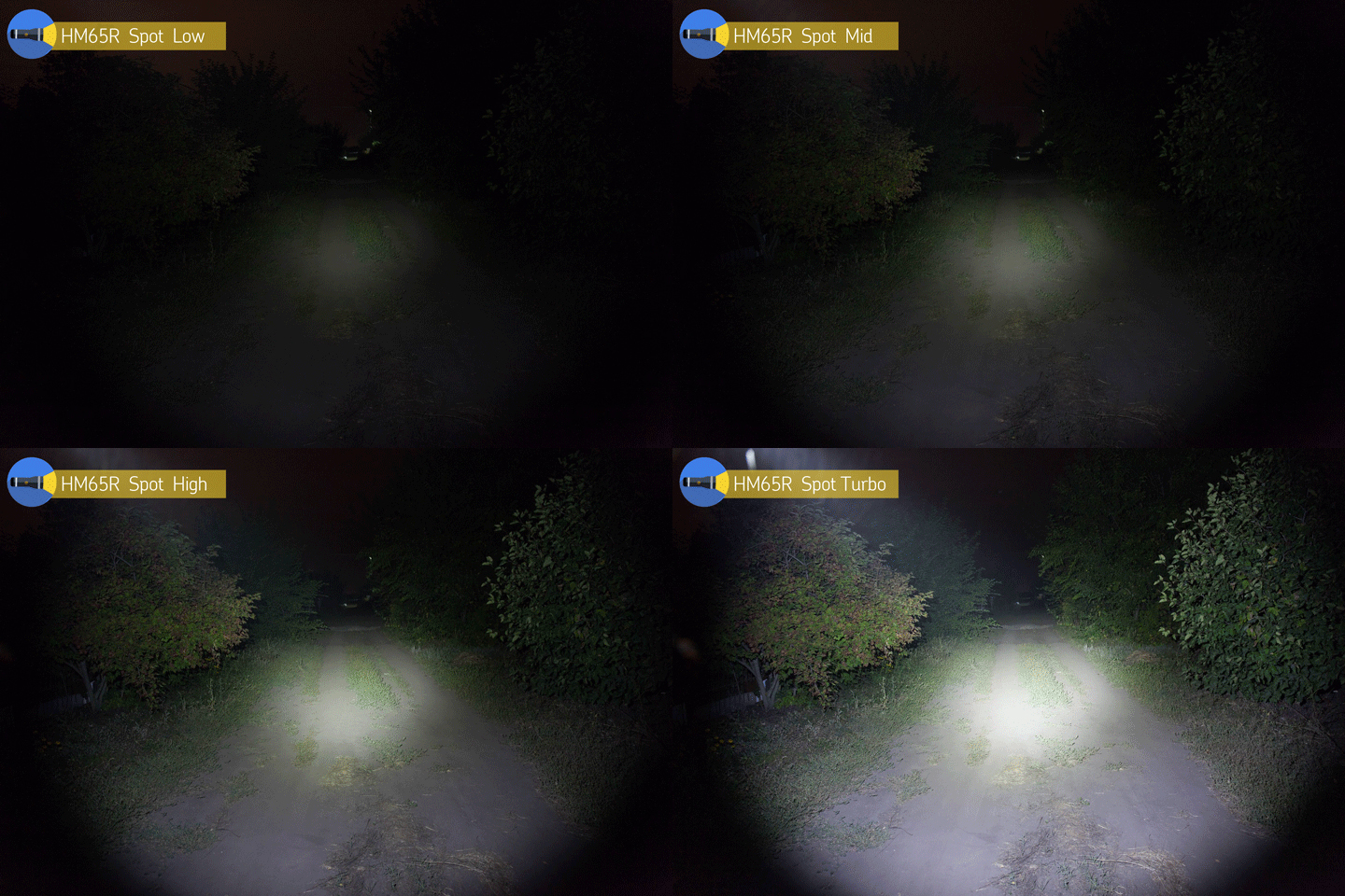

Spotlight is cold, somewhere around 6000K. Good side light, quite decent (for the headlamp) throw and brightness in a turbo.

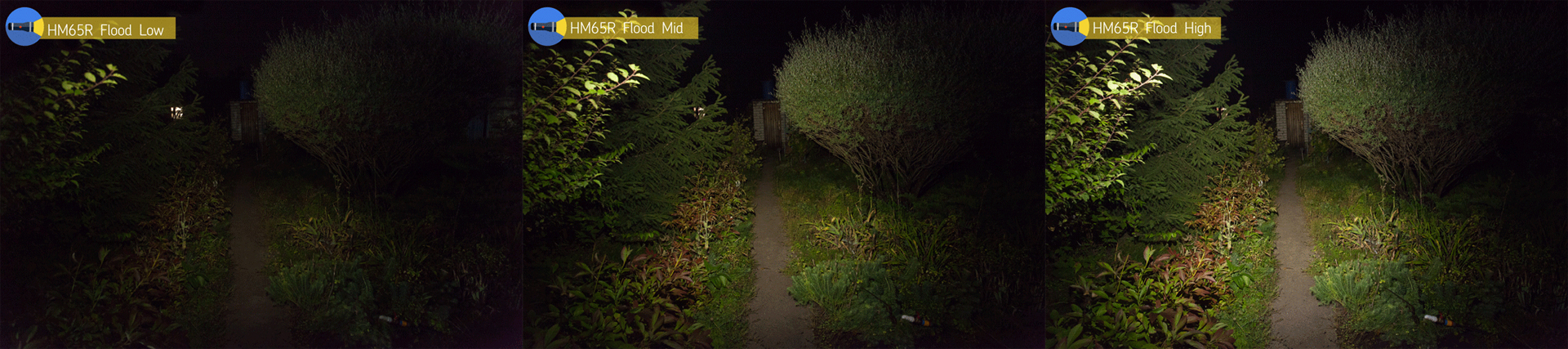

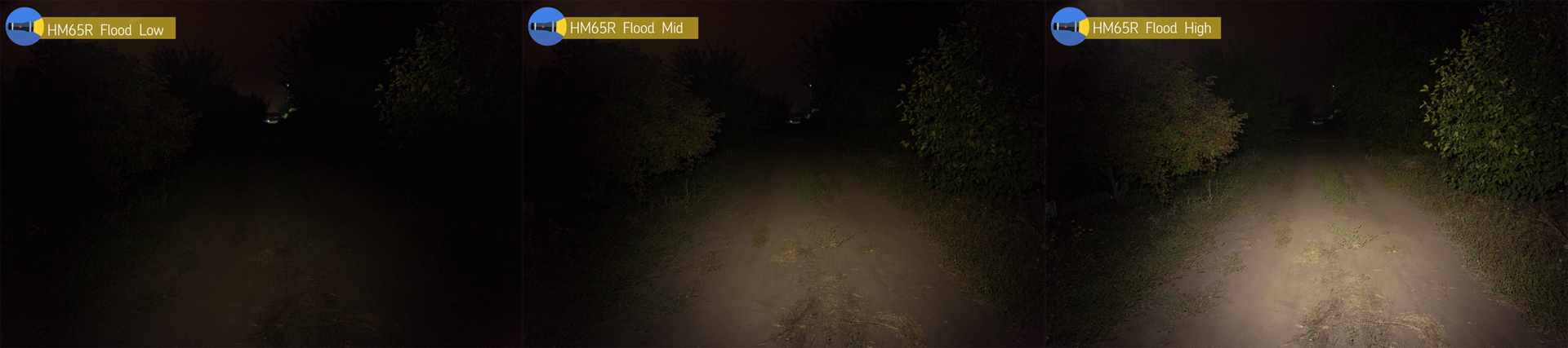

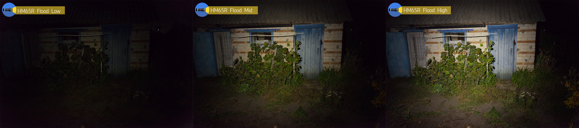

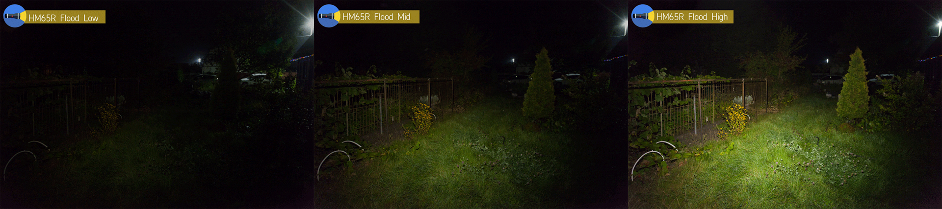

Floodlight is significantly warmer. 5000K somewhere. Uniform light, quite a convenient thing for such purposes. Accordingly, Spot and Flood can be combined.
Here, the MID mode for each type of light manifests itself in a very balanced way, at a distance of about 7m, a good sidelight and a bright center. Immediately on the GIF you can estimate the difference in light distribution of both types of light.

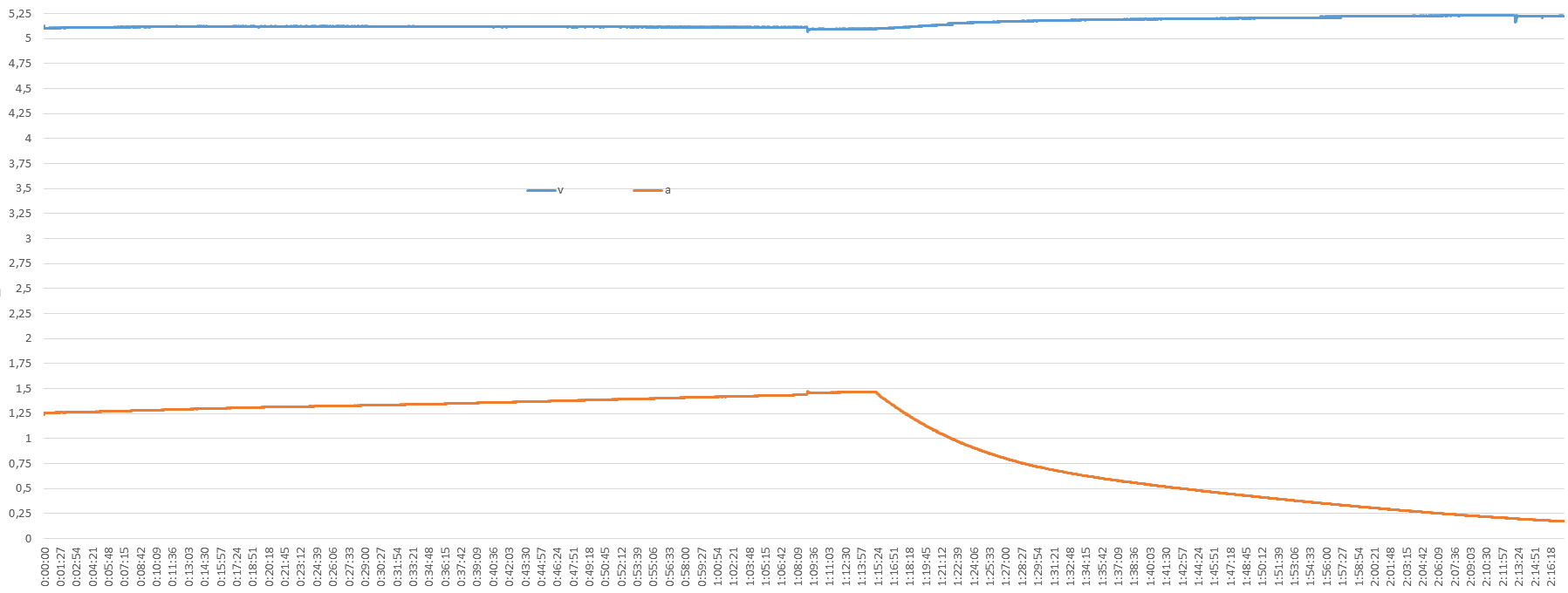

The charging current is very good.

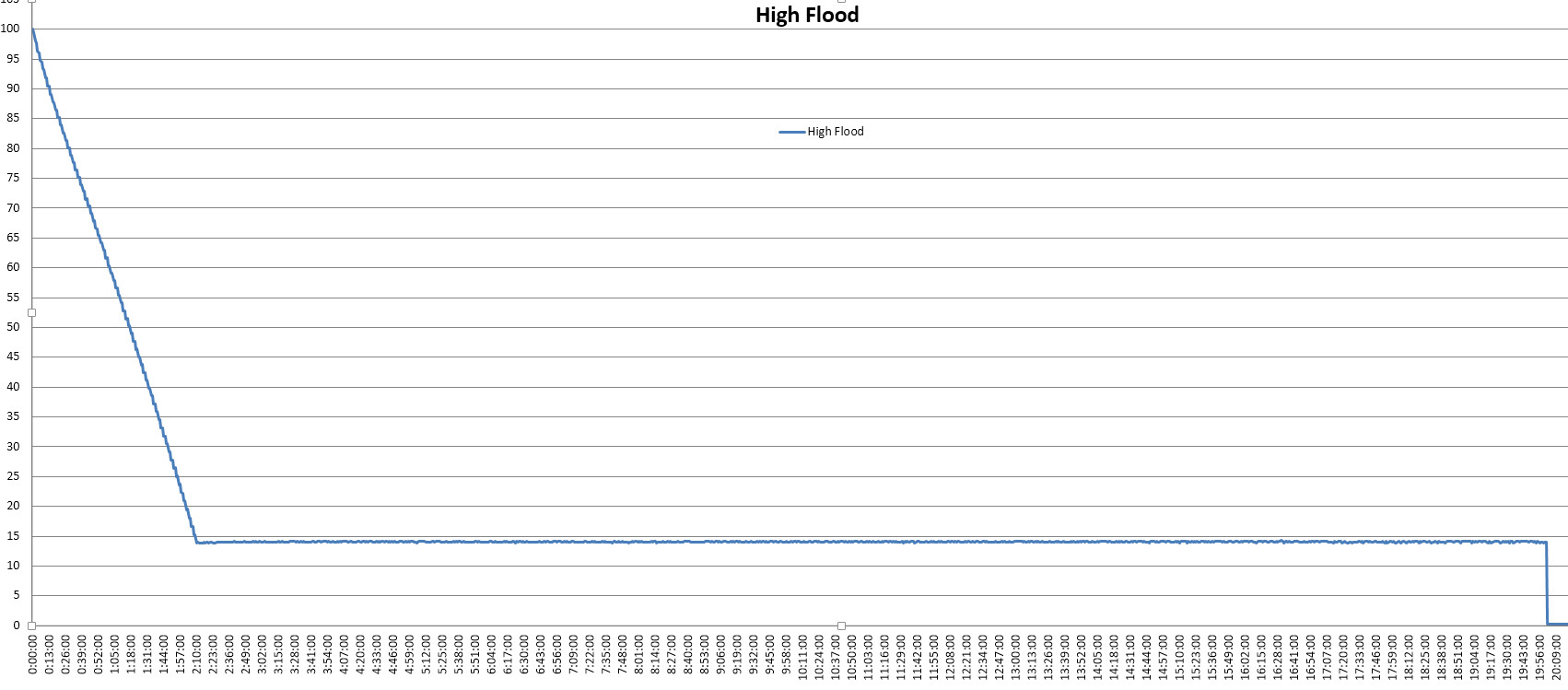

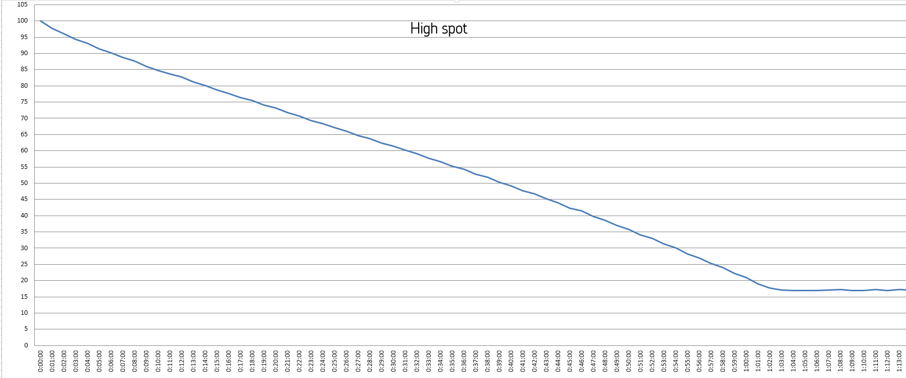

Fenix HM65R has one serious thing that must be mentioned. Namely, there is stepdown in all modes.
And if for Turbo-High this is completely logical and natural, then downer - it is surprising . For brightnesses like of 200-300 lumens it is logical to expect full stabilization. I don’t like it, but I’m not ready to say right away that it’s terribly bad - I see the logic of such a decision.
What I mean is that the human eye adapts, and in reality, the brightness of the HM65R, due to the slowness of this decline, is perceived as relatively as staying at the same level. Until some point, of course. And after this moment, you can rewind the modes again and turn them on at the same initial brightness.
+ Less battery drain when the brightness drops.
  • As I said, the brightness drops for a long time: 1 \ 2 hours for turbo \ high flood light and in many situations you turn off the light even before the brightness drops significantly.
  • If you wish, you can return to the same initial brightness when you feel that you still lack it. - after all, this is not full stabilization - since the eyes are already accustomed to a lower brightness, it can be uncomfortable for the eyes after “zeroing” and scrolling to the initial brightness. here, as I said - the brightness in a high spot falls for an hour. You can return to the same brightness 4 times.
High Flood gives a similar picture, the difference is only in runtime - here the drop is 2 hours.

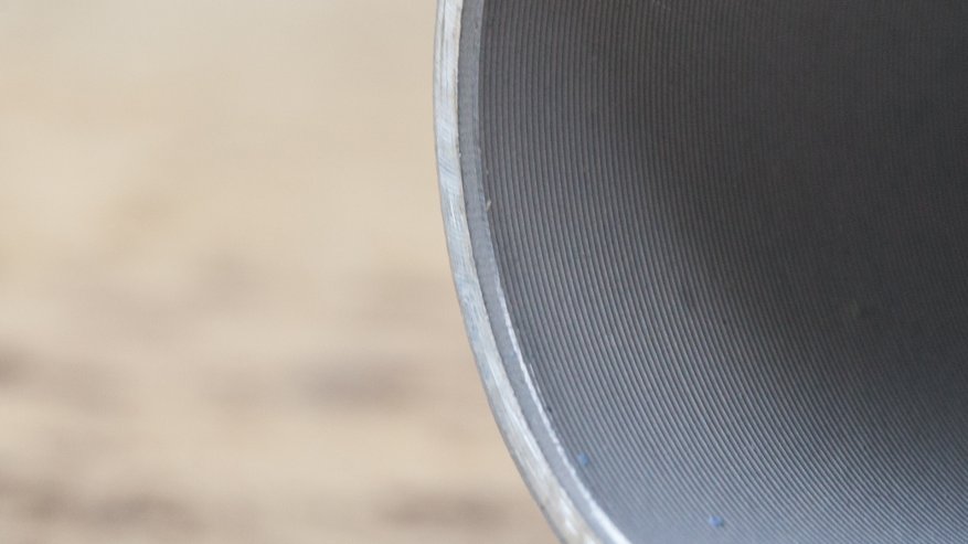

Are the threads anodized?
No
Thanks
Non annodized threads is a bit of a fail
