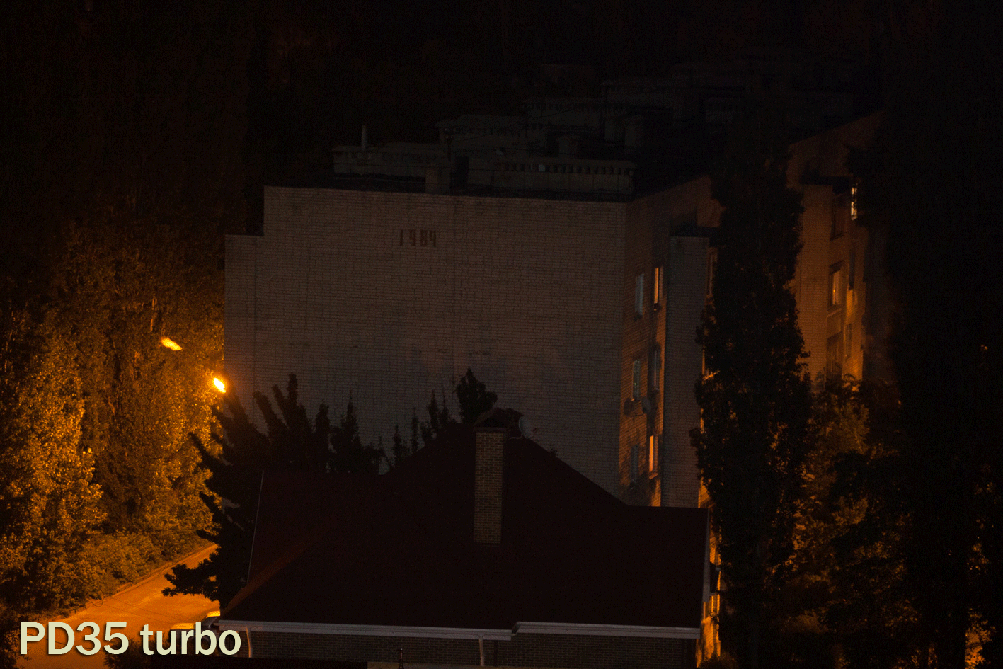

I suppose this flashlight is intended for those, who needs more throw than sidelight. But, still, UC35V2 is ok for close-range use.
175m is not that distance that such flashlight is good at. But, still, in turbo, UC35V2 shows good throw. For pocket light with small reflector it is significantly good.
It performes well at intermediate distance of 50-70m, though only in High and Turbo, MID also gives some light, which is good for such distance.
And here is typical EDC distance, 10-15m
