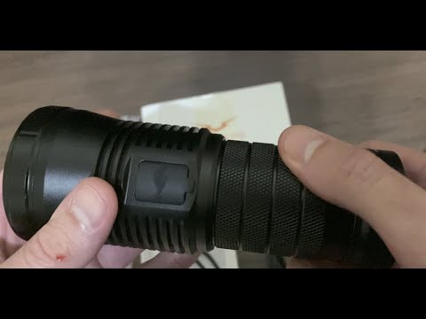

Mine won’t double-click to get to turbo. Tried many times.
Oh indeed it’s your video…… :smiley:
Unfortunately, ramping/stepping up wouldn’t get you into Turbo level, just High level. :frowning: Same for my HT50. I believe you definitely know how this works for some lights………
I know the vast majority don’t read chinese, but turbo is accessed via double click in the instructions for HK90S (TB link above). You can do this in any of the normal levels or from OFF.
And from Turbo, double click again to get into the notorious SOS and double click again into strobe. I presume you also cannot access SOS and strobe too?
As per instructions on the webpage
There are small differences in UI between the HT50 which i have and the HK90S, for my HT50 there is only strobe and not SOS. HK90S has both SOS and Strobe. This is also mentioned in the HT50 TB webpage and product instructions.
And for your lockout “issue”, it gets locked out with a 3 seconds long press in OFF mode. You can unlock by mechanical means of twisting, or you can unlock by a 3 seconds long press in Lockout mode.

Mine doesn’t go to turbo. I will replace the batteries and try again. But the lockout bullshit feature is for the birds and does NOT unlock with three presses. It’s so easy to accidentally trigger…yet another reason why these drivers are trash.
Yep, i know what you mean by UI trash. The UI is still usable of coz, just not really friendly to use.
My HT50 electronically locks out when you are in turbo and then long press 2 seconds. In output modes 1 to 4, long press is fine, that cycles through from 200 lumens to 2.8k lumens. Like….WTF man? Why not stick to the proven 4 short presses for lockout? My Haikelite HT50 also uses 1 second long press from OFF position to enter “moonlight” output mode of around 50 lumens?
So definitely mistakes can be made.
Another thing is that my Amutorch DM70S and JKK76 both switch off with long press, so occasionally i do make the mistake of locking out my Haikelite HT50. I do use the Amutorch DM70 and JKK76s pretty often in real life so that long press to switch off is now like second nature to me.
Haikelite’s boss replied, really need to double click when the light is switched on to enter Turbo. I asked him if the top ramping output setting is same as turbo output, he did not answer that directly. But double click when the flashlight is switched on is confirmed. He also said that the HK90S and HT50 UI is a bit different, which we know of course.
I also made a vid regarding double clicking speed, see if that helps and to confirm that we are on the same page regarding this double clicking thingy. Mine is 4 stepped output modes, double click to get into turbo, and then double click again to get into strobe.

BTW, it just occured to me that the boss also asked me which grouping is the light in, ie stepped mode or infinite ramping mode.
(the first message he replied at 20:39)
Can you try to get into the other grouping by clicking 3 times quickly when the light is switched on? It can alternate between the 2 when it is switched on.
Then try double click to get into Turbo setting in the other mode. Not sure if this would help.
The light has never come out of ramping. No amount of playing or holding down works.
He just sent me this image, seems to be claiming that it is Audril (1st version). Of course whether or not it really is Audril, i don’t know.
See how you’d troubleshoot it, as the things you tried doesn’t seem that the driver for this HK90S is programmed with Audril?
He sent other images but is basically a summary of 2, 3, 4, 5 etc clicks, in chinese……so won’t be posting here.
Wonder if there is an Audril factory reset, if that works that is…… as if the firmware is already messed up then it’s tough esp if the innards are not accessible and/or you do not have the stuff to flash it. Definitely not for the non-DIY crowd like me.
I am wondering if anyone else reading this has any additional ideas. I’m just a regular flashaholic and buyer of whole lights.
Basically a light that i stuck in infinite ramping mode, and the manufacturer fella said it is Audril.
