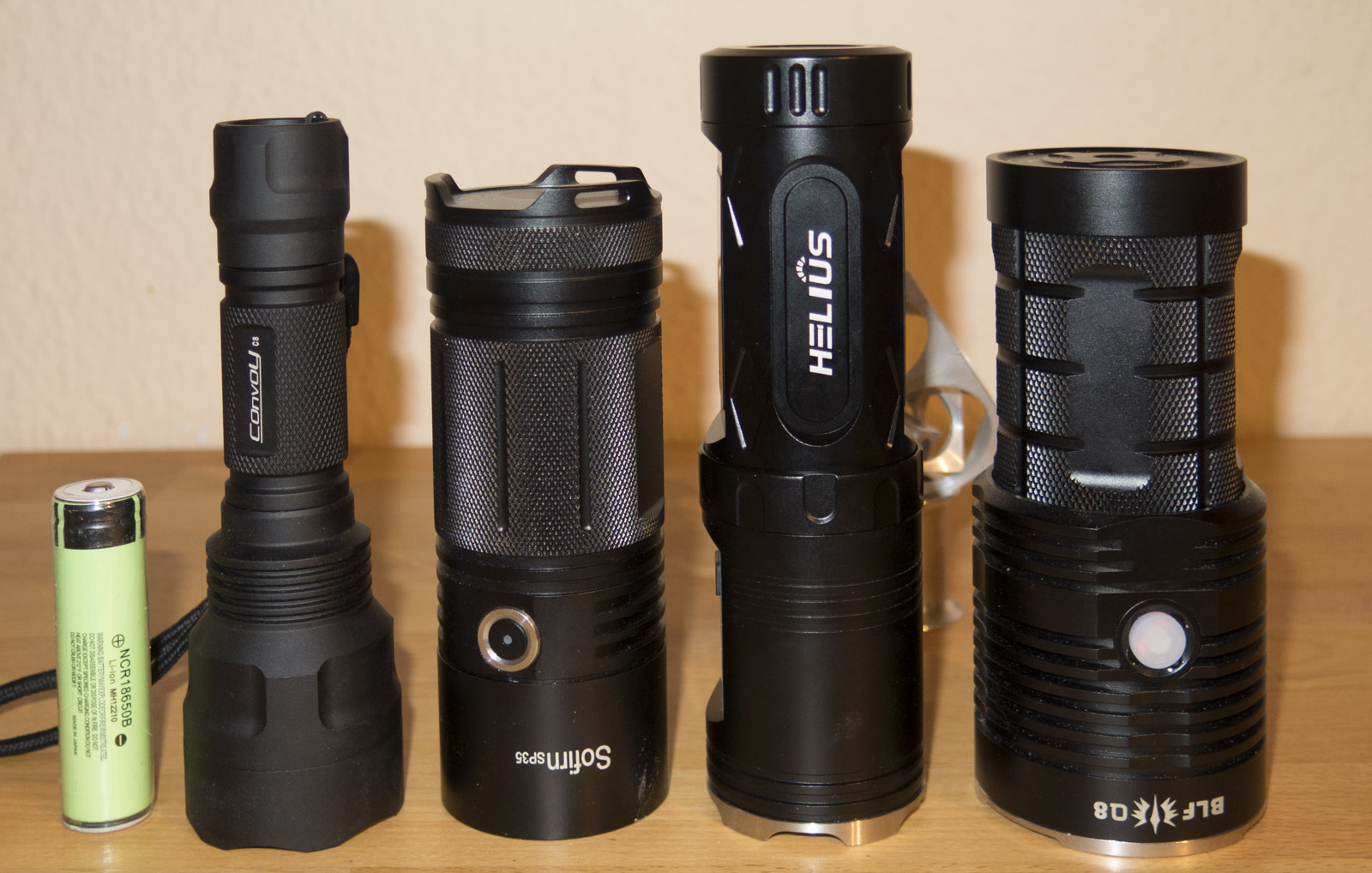

Size compared to other common 1x, 3x and 4x 18650 lights the Helius is medium big, but on similar size more output or throw is available

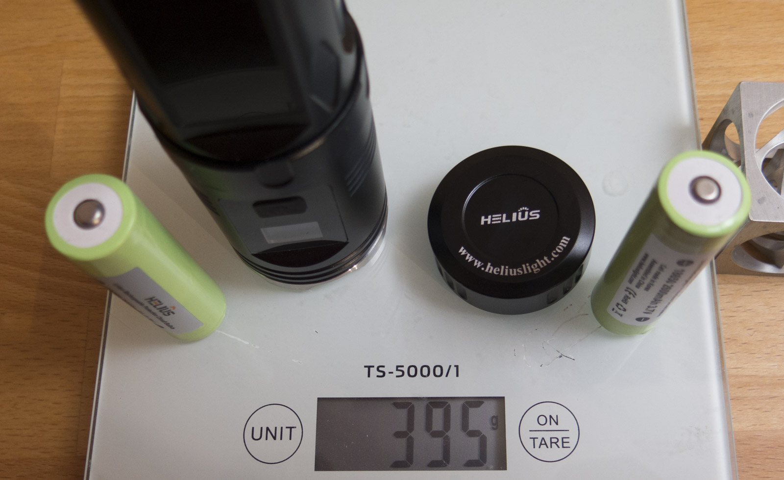

The light stands on the tail as its flat and weights 395g with batteries

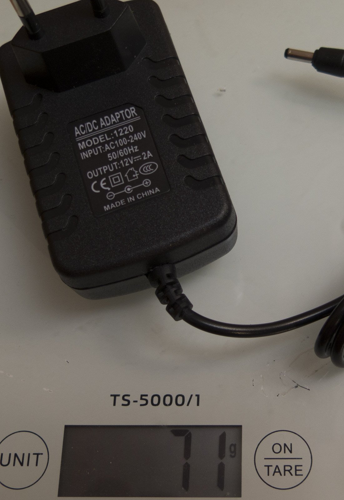

The PSU adapter is too light to be a good stuff inside, compared with a other similar

The whole box is a little over 1kg heavy, too heavy for a 2x18650 light, even a really big light like TN42 in box with 2 batteries has about that weight

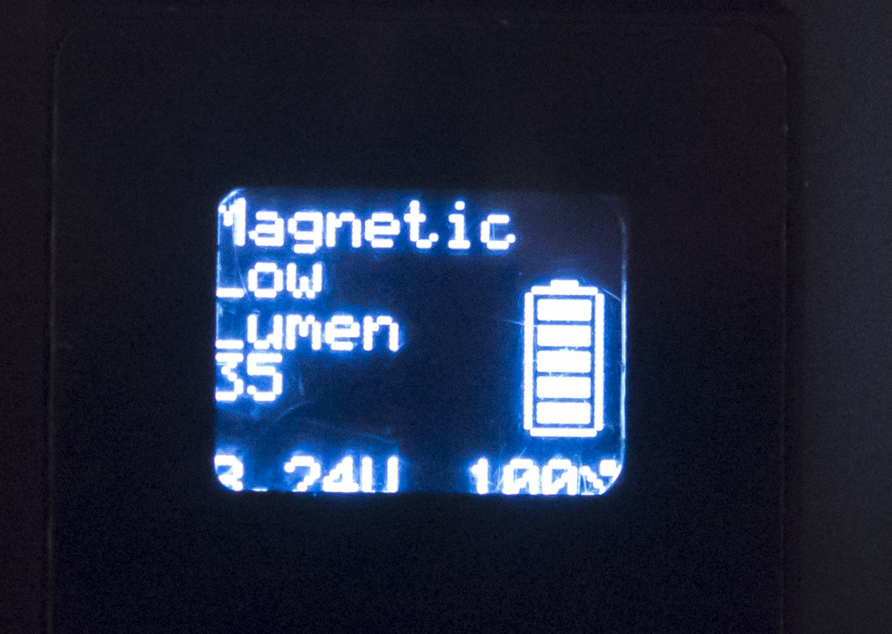

The only optical status this light has is the OLED display
The side switch has a good feeling and direct click
The main issue I see on the head is the cutout for the display is too small, you can’t read the full display from one angle

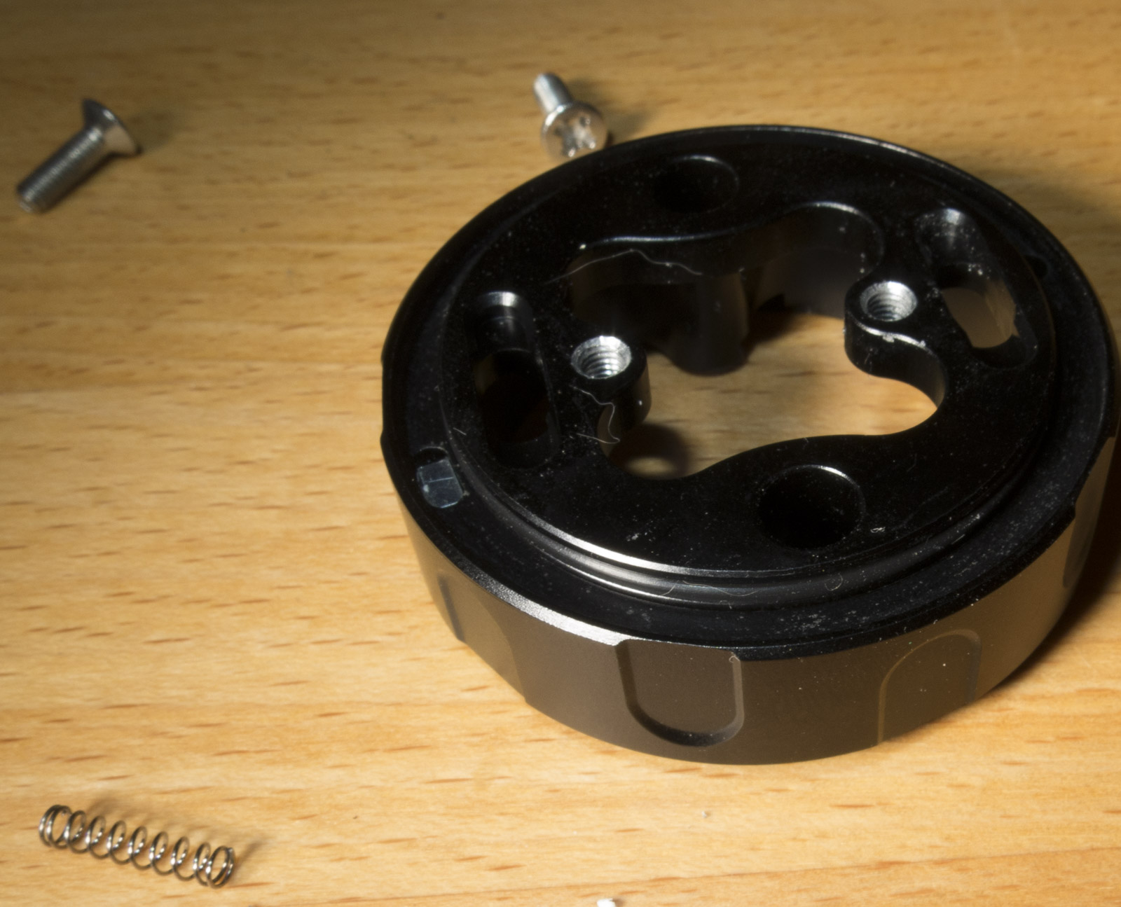

The light shut down between 2 resting position which I do not like

The tail cap is fully anodized, with a centering screw to rotate and one alignment bolt to fit in the tail tube

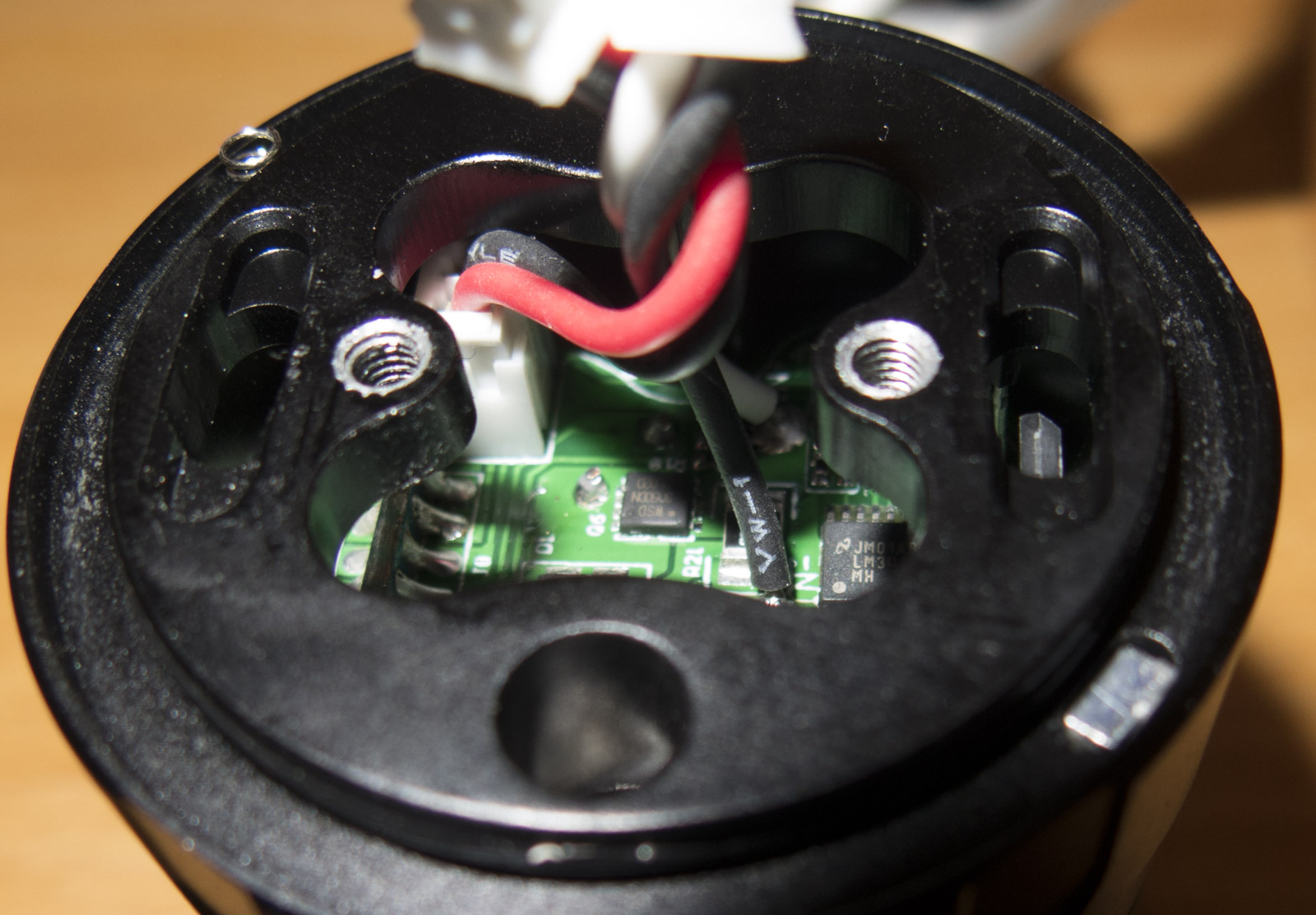

The driver is well hidden inside the light
I can’t pull it out completely as it is connected with the OLED display
The drivers contact plate has a spring from a magnetic metal like steel, on it are as well the coil for wireless charging and the charge driver connected
The drivers charge board is hidden in the tubes side it is behind a plastic plate that is sealed with an o-ring and glued in place
This plastic is very soft and will be scratched very fast
Other side has a coil behind an identical cover which has also the wireless charge symbol printed on it

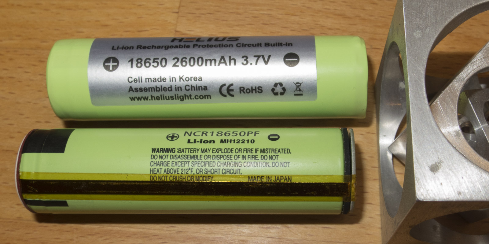

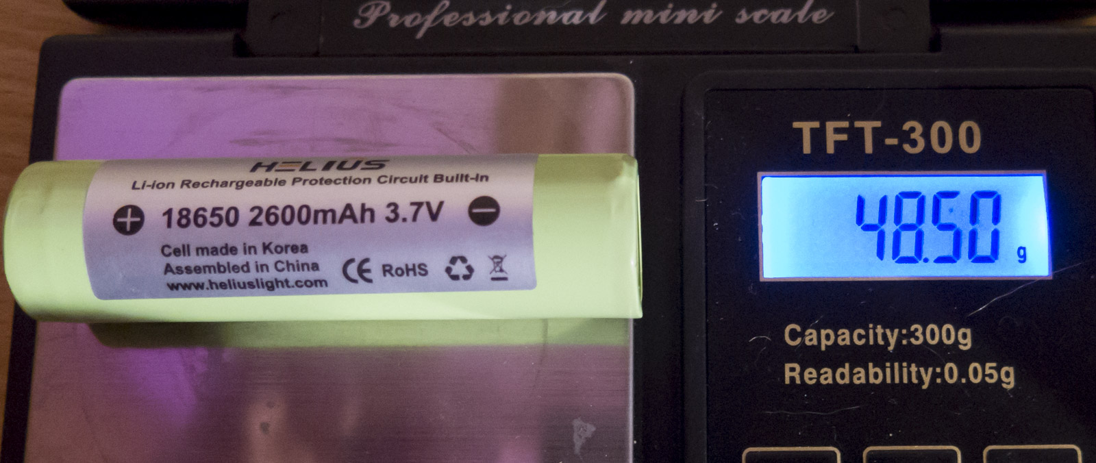

The batteries are Panasonic NCR18650-PF with a weight of 48.5g
The Cells showed 60 and 80mOhms on my charger, this is a common reading for good protected cells, but not balanced well
10A 2950mAh from Datasheet, not latest cell for max capacity, I did not find any test for this cell so far I guess it performs well in this light
The mode spacing is not good, the light has no moonlight lowest level is 35 lumens
The light has only 3 modes 1500 Lumens max, which steps down 500 lumens and 35 Lumens
additional it has one Strobe mode
3 Modes in modern LED lights is just not enough at least a 1 Lumen mode missing

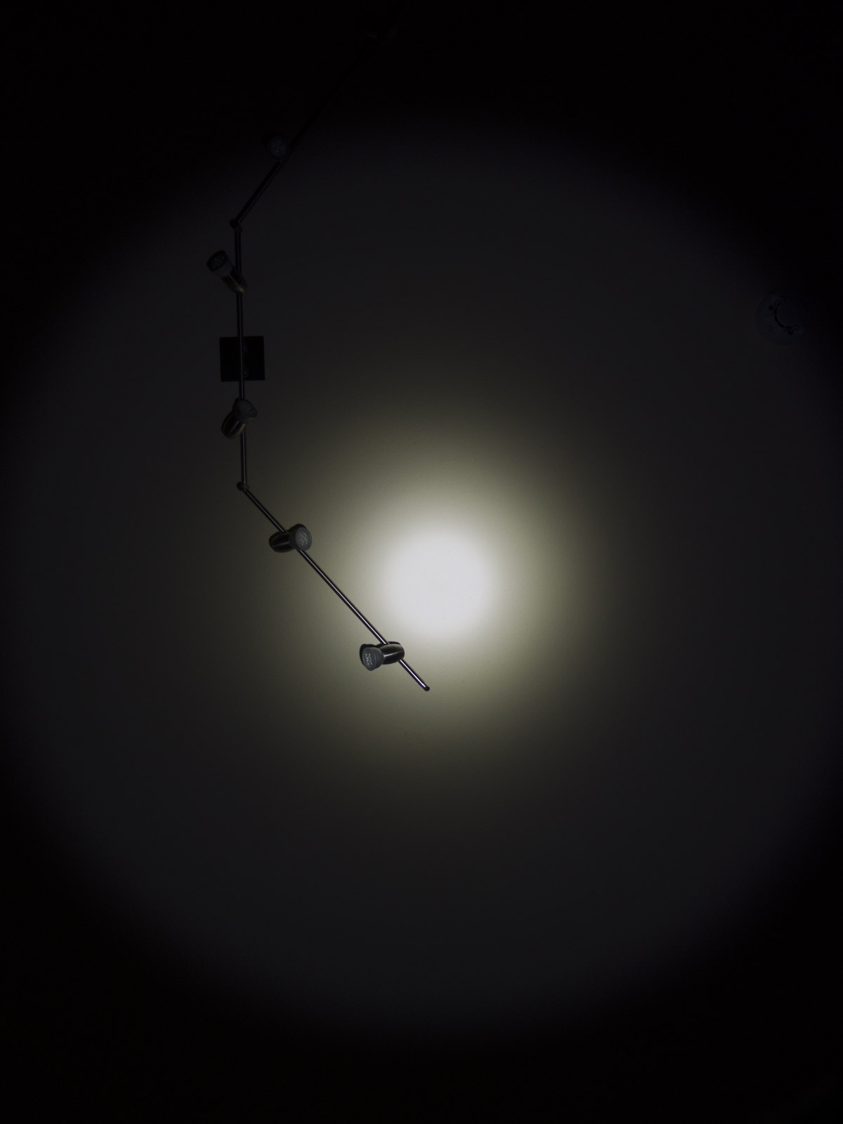

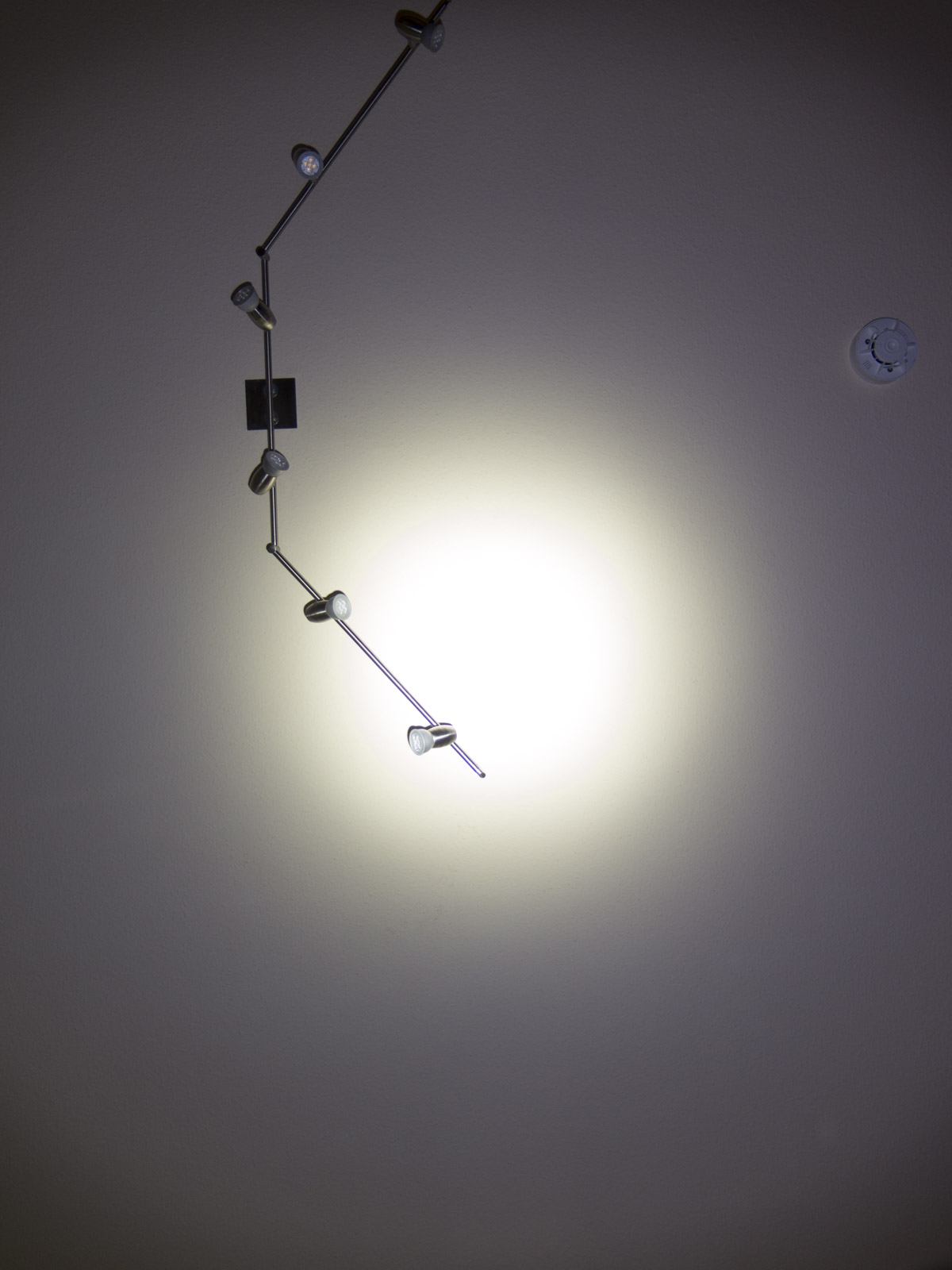

Beam shots
2m to ceiling
Helius Omega VI
Nitecore P12
BLF Q8
Sofirn SP35

- PSU for the magnetic base is too light for a quality one
