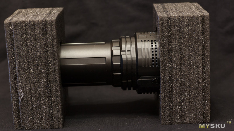

Inside, between a pieces of foam rubber, levitates DX80.

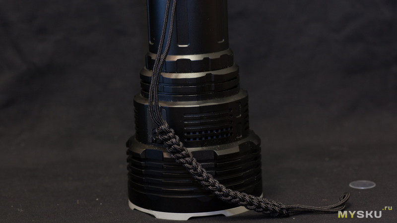

That was a good idea to use paracord lanyard because flashlight is THAT heavy. For the same reasons, Imalent didn`t use regular hole in flashlight body to attach lanyard and use metal ring instead.
Hm, there are 2 pairs of holes for this metal ring at opposite sides of tail.
Actually, I`d like to see some shoulder strap like the one from Jaxman X6. Similar and surprisingly unused feature.

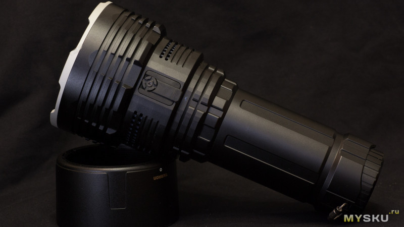

Cooling ribs? There are so many ribs you can start BBQ party.
Here is a GIF as well, to give a better idea of head appearance.

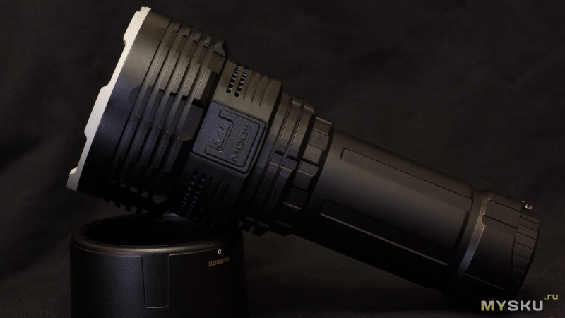

Also you can see button here, the part that I definitely don`t like. Yes, it is big, like postal stamp. But as there are a bunch of details on head surface, button is almost undetectable for fingers.
There are a pair of small blue LEDs , glowing while light is on, to help to locate button.

Is there anyone, who suffer tripophobia? Hope no and all you can see the same beauty that I see here in this honeycombs. Also notice teeth of bezels and OP glass.
So, appearance is futuristic and attractive. Actually, any light of such size will draw attention. I cannot see any bugs of build, but as all the DX80 is eee…undisassemblable…there are no way to detect them
