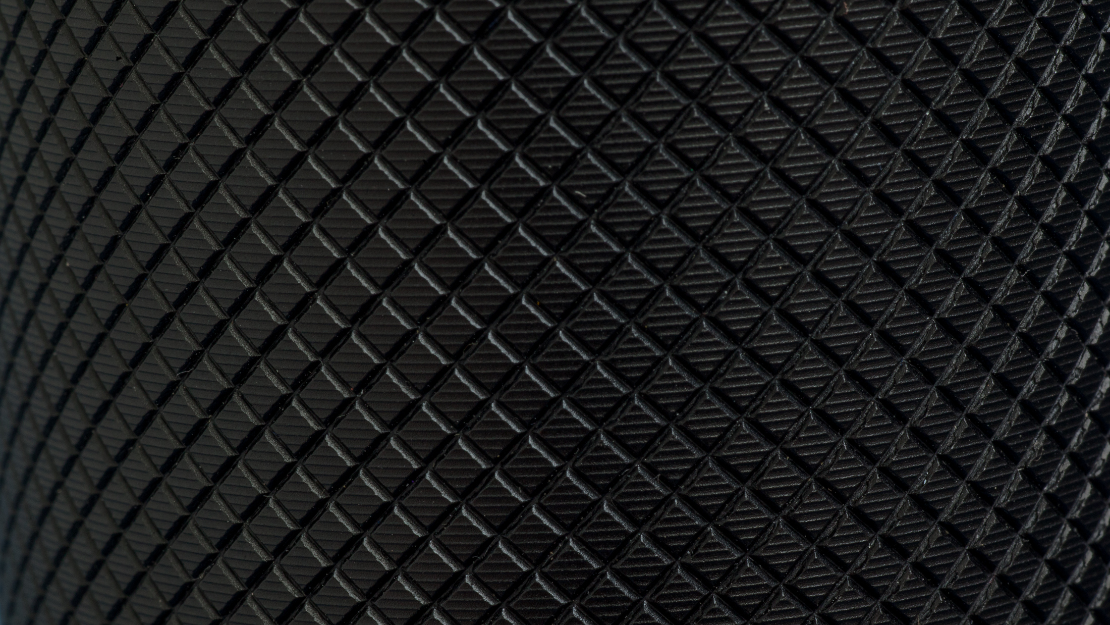

Knurling is fine.in general, the grip is comfortable and firm enough.

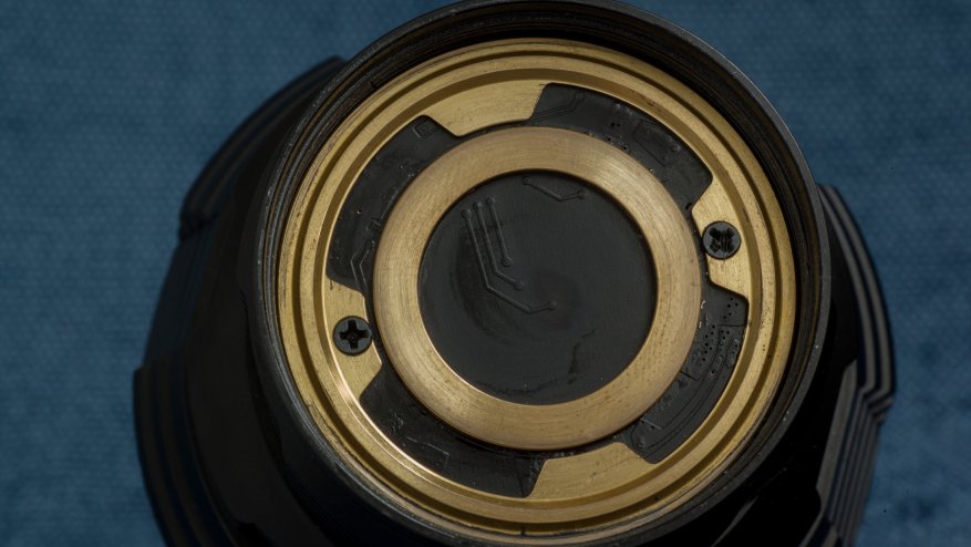

On the reverse side there is a contact plate for charging. And here, by the way, there is a difference between RT70 \ RT35. Connectors are symbolically different. In RT70 it is black, RT35 is gray. I did not remake the gif, and here it is from the RT70 review, the difference is only in color, so it is not significant. In general, I did not like the way the charge was implemented here. Usually magnetic blotch holds pretty tight. Here it sticks to conctact plate really weak and charging on the go will be virtually impossible. If I charge at home or in the car, I don’t see any problems.

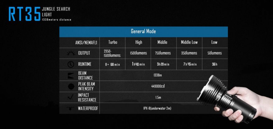

off-on on click, switch modes on hold
a turbo in 2kh click, (time) lock on 3 multiple. everything.
There are modes memory
In general, it is convenient, but I would add such an obvious addition as the entrance to Low on hold from OFF.

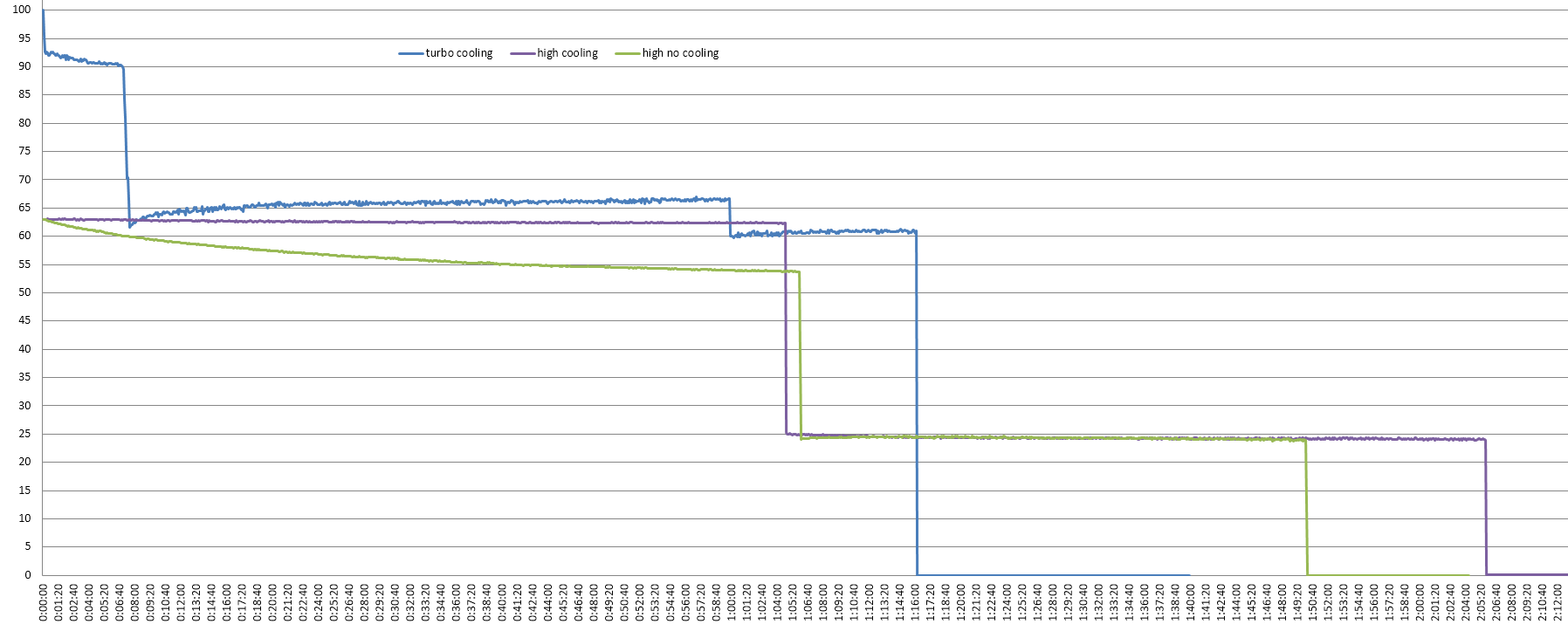

there is a strange situation with cooling. I just can not explain it. Without cooling in high mode , the flashlight works clearly less, while the brightness subsides. With cooling, it stays without stepdown, and at the same time it works longer, which contradicts any logic. I did measurements in each mode like 3-4 times, I did not see the difference. By the way, it is also normal and stabilized after dropping from turbo to high, the brightness stays on without any cooling. Which is not surprising, because 1500 liters for such a carcass is nothing in terms of heat dissipation.
And so , stabilization and runtime are good. I liked the Mid Low mode. It is more than enough for any domestic needs within a radius of 50m, while the runtime will be 6 hours (+ another 2 hours after falling by 50%.)
