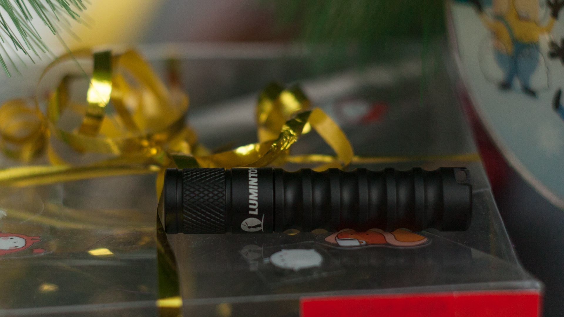

And here is the keylight itself. You can also evaluate its modest size. Due to the wavy shape, the grip of the flashlight is reliable and convenient.

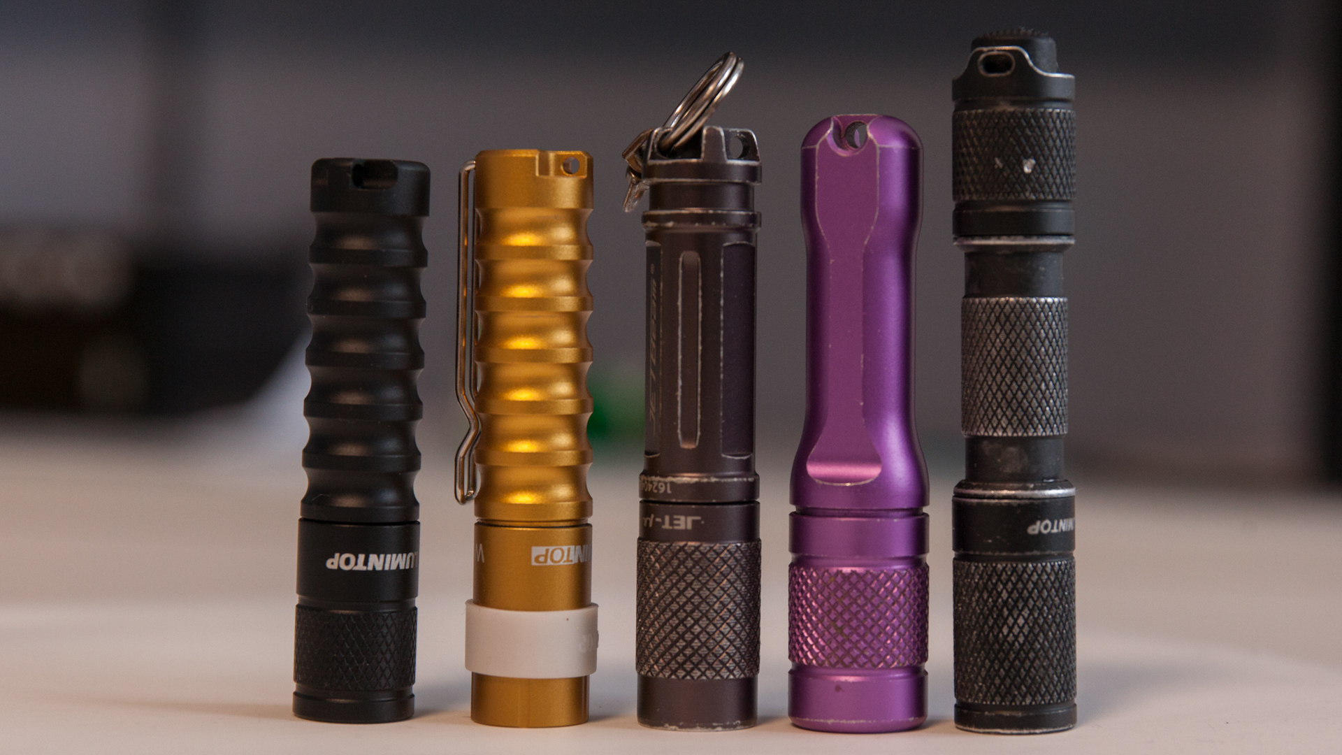

Well, here are fellows. As you can see, by and large, they are all the same in size. Immediately it is clear that the EDC01 is almost the same in appearance as the golden Worm and is much shorter than the one having the tail button.

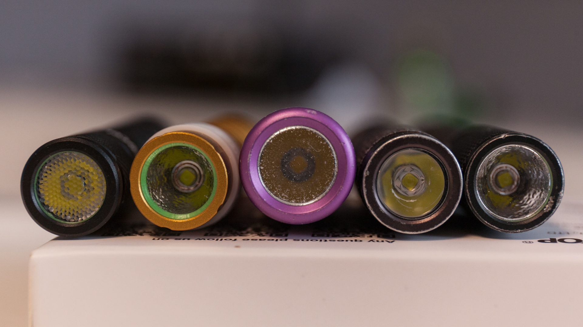

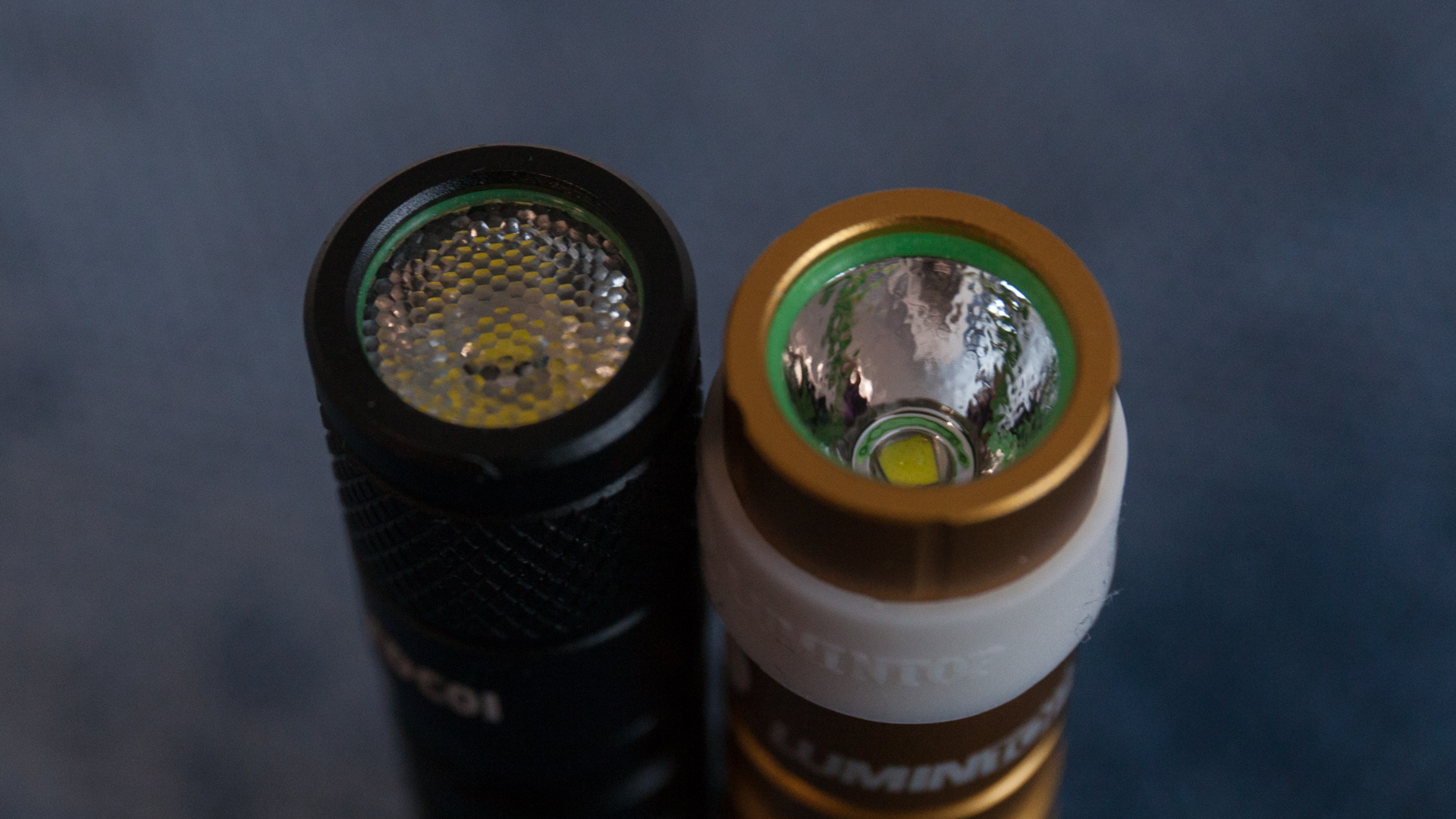

reflectors are different
From the side of the head, of course, the contact plate.

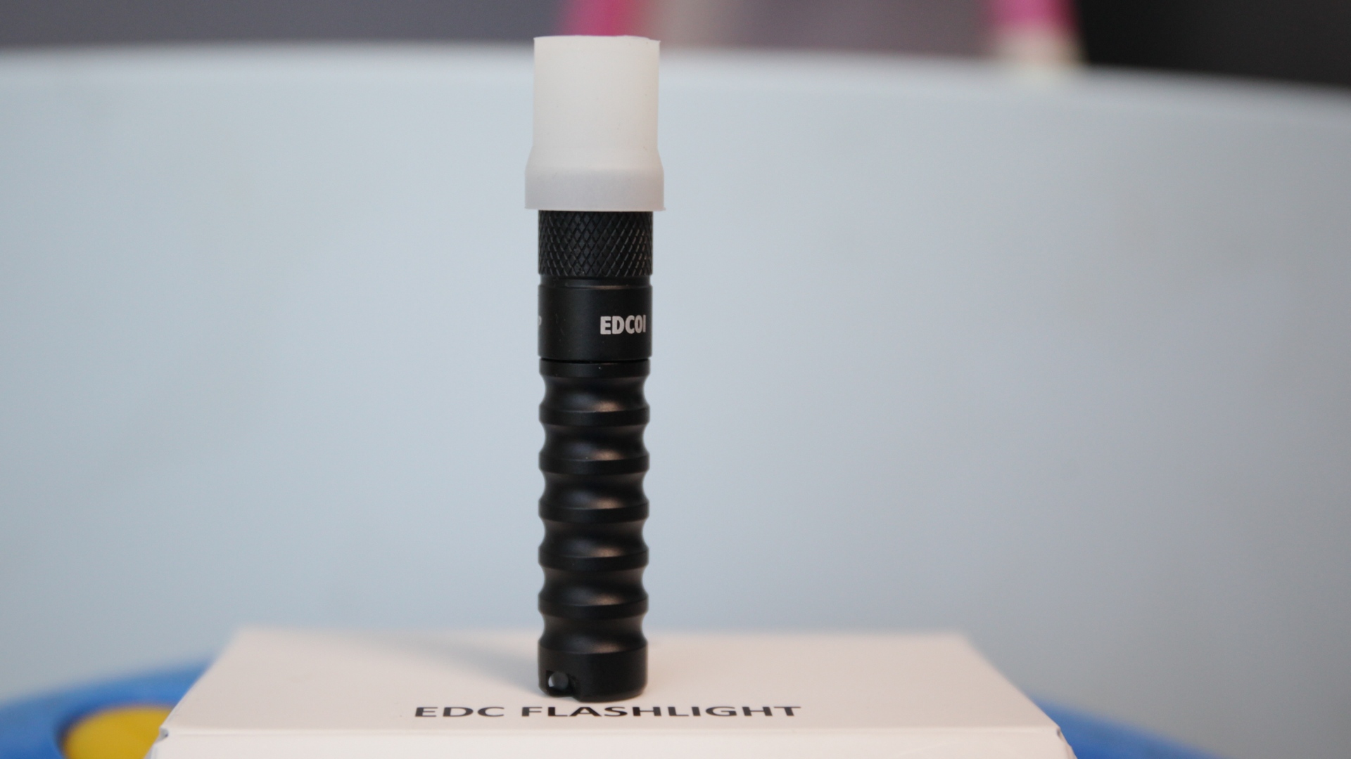

You can put diffusor on, if you need. I feel that is more decorative feature rahter than functional, but…well, there are different situations and it can be used as a night light in a tent.

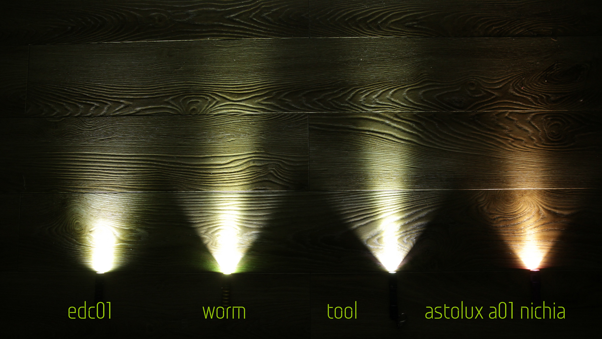

here you have comparison of the whole get-together. the difference is clear - due to TIR optics, EDC01rved flashlight gives a wide diffused light, which is very convenient near. It and the others are quite convenient, with such a shallow reflector, but everything is completely flooded.

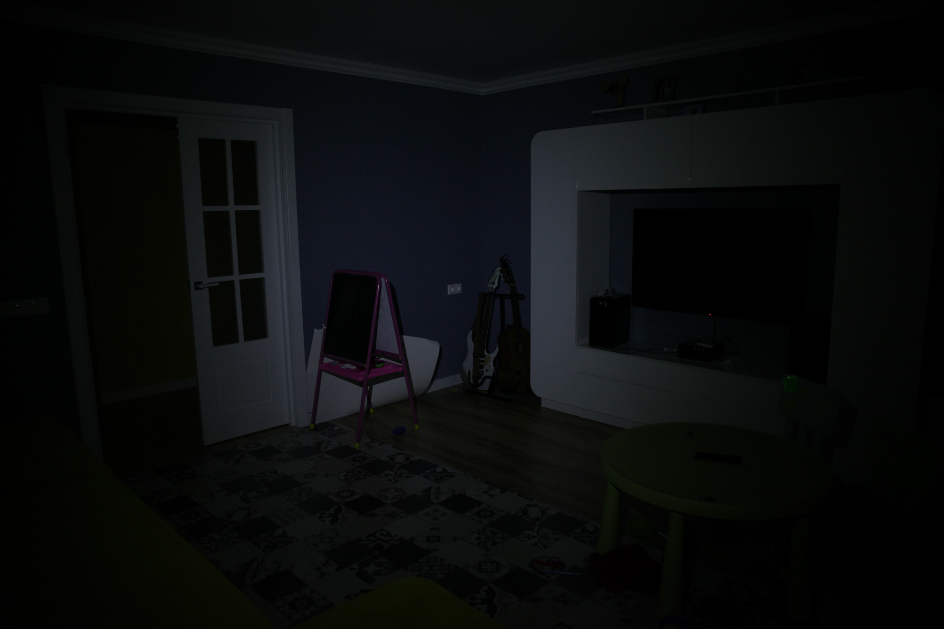

How does it shine? Well, not bad. In the room it is enough for the eyes, even here the Mid will be far from useless.
here’s for comparing high for all four keyboards presented.
Well, EDC01 itself in Low \ Mid \ high

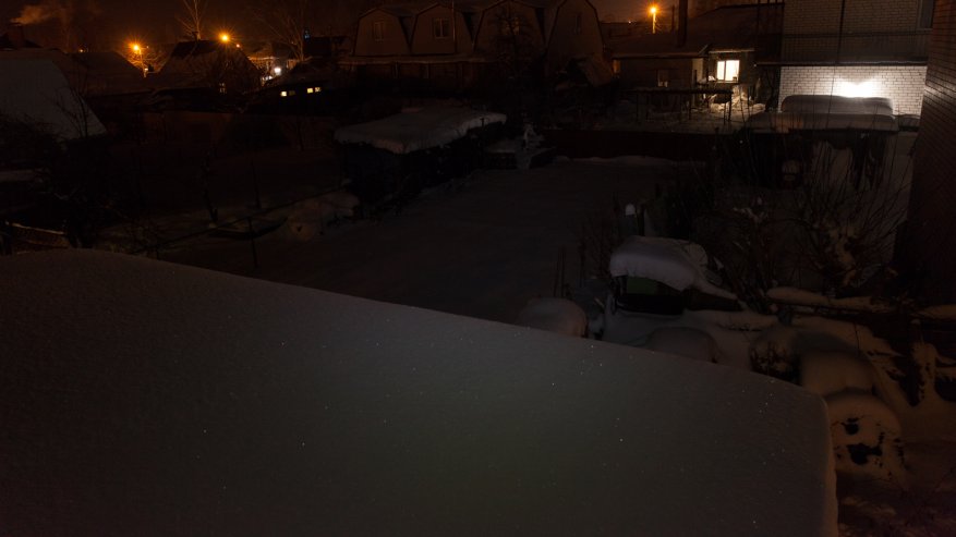

Lumintop EDC01 will give some light outdoor , but you need to understand that other models with a reflector will be preferable here, when you need to shine through the surrounding bushes. Here with EDC01 the light will be fundamentally different. And mid there will not be so impressive here. However, at maximum brightness, this baby will be quite consistent in the 15-20m range. See for yourself.

I have a copper Tool as well and pretty much agree with your review. I guess the pebbled TIR is to smooth out the XP-G3’s artifacts/tint shift so with a different emitter one could use a slightly throwier, clear TIR. I really like the way it feels in the hand, the ribbed design works well. I have the pink, purple and black versions and i think the pink is the best, i normally dislike pink lights but this one is just classy. Definitely a gifter.

I've been carrying the Astrolux A01 ever since it came out. I love the light produced by its NW, high-CRI Nichia LED. Your pic of the A01 beam shows off its excellent color rendering. Your pic also clearly show that the A01 has a tighter hot spot than the Lumintop EDC01. For me, that's a negative. I like the wide beam on the EDC01.
