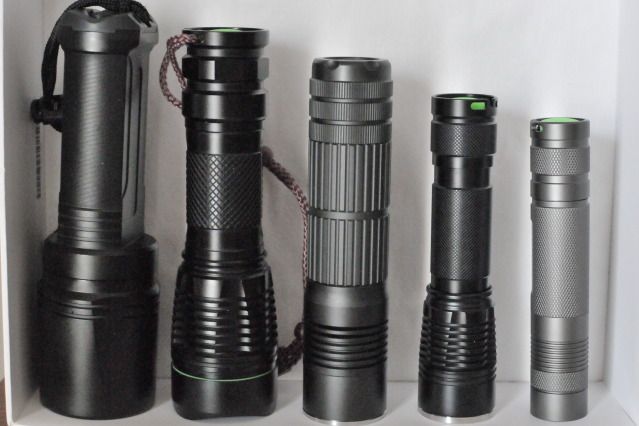

From L-R: Fenix TK35-clone, Keygos M10, Trustfire A8, LXP 18650, Marsfire A T6
Size Comparison: G&P T8, LXP, Surefire 6P

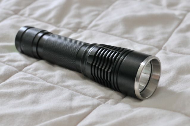

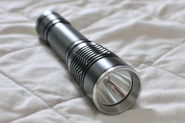

My light arrived flawless without any knicks or scratches (unlike some of my ebay lights) although that could be due to the HA3 anodizing. Threads were clean, smooth and quiet although I took the opportunity to use some of the lubricant that had arrived together. The knurling is shallow and not at all aggresive i.e. it is more decorative than functional. The fins are effective in transferring the heat generated as the head gets warm (but never too hot to hold) after being on high for several minutes.
Size-wise, it is almost equivalent in size to a typical P60 light like the Surefire 6P or Ultrafire 504B (see photo above). It’s not the smallest single-18650 around but the benefit of the slightly larger size is the larger reflector and better throw. Unlike turbo-head lights which tend to be top-heavy, this is very nicely-balanced and fits well in the hand. It is also easily pocketable because of the size and the lack of crenelations on the bezel.
The tail-cap has 2 holes to fit a lanyard while maintaining tail-standing capability. There are 2 o-rings each at the top and bottom of the battery tube. One of the o-rings at the bottom of the tube exhibits the tendency to get caught/pinched by the tail-cap hence a bit more care is needed in closing the cap.
One positive thing I would like to point out is the complete absence of any labeling on the light! Not even a “Caution: Hot Surface”! A refreshing change indeed. Also, because of this – the main body itself is a perfect cylinder without any flat surfaces for labels.
All in all, it is a rather handsome and understated light.

The beam is very close to that of my Trustfire A8 because the reflectors are nearly identical in size. There is a distinct hotspot with a large spill. Great for most general tasks. For a smooth reflector, there are very few rings and they are pretty spaced out at the peripheral and not distracting. All in, it strikes a great balance between complete flood and long-distance throw.
The NW tint is warmer than my other xml lights which are all CW. It’s a very pleasant tint and nearly as nice as my incandescent lights although it means it may not be as bright as the cooler tints. But this is more than offset by the more natural colour rendering – in fact, from now on, I like it so much, I am going to stick with NW wherever possible, at least for my smaller lights.
