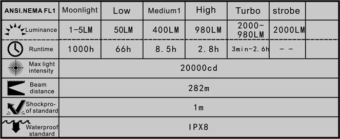

SPECS
  • Emitter: CREE XHP-50.2
    Maximum output: 2000 lumens
    Power by 1x 5000mAh 26650 battery (Batery included)
    Type-C USB Charging function
    Maximum beam intensity: 20000CD,
    Maximum beam distance: 282 meters.
    Working voltage: 2.8V-4.35V (Over discharge protection)
    Driver: Most efficiency constant current circuit
    Material: Aircraft-grade aluminum body
    Surface treatment: Premium Type III hard-anodized antiabrasive
    finish
    Lens: Toughened ultra-clear glass lens with anti-reflective
    coating
    Water proof: IPX-8 (2 meter under water)
    Tail stand
    Length: 128mm / Diameter: 46mm
    Weight: 189g (without battery)
    Accessories: O-ring * 1, Lanyard * 1, Type C USB cable * 1, Manker 5000mAh rechargeable 26650 battery * 1

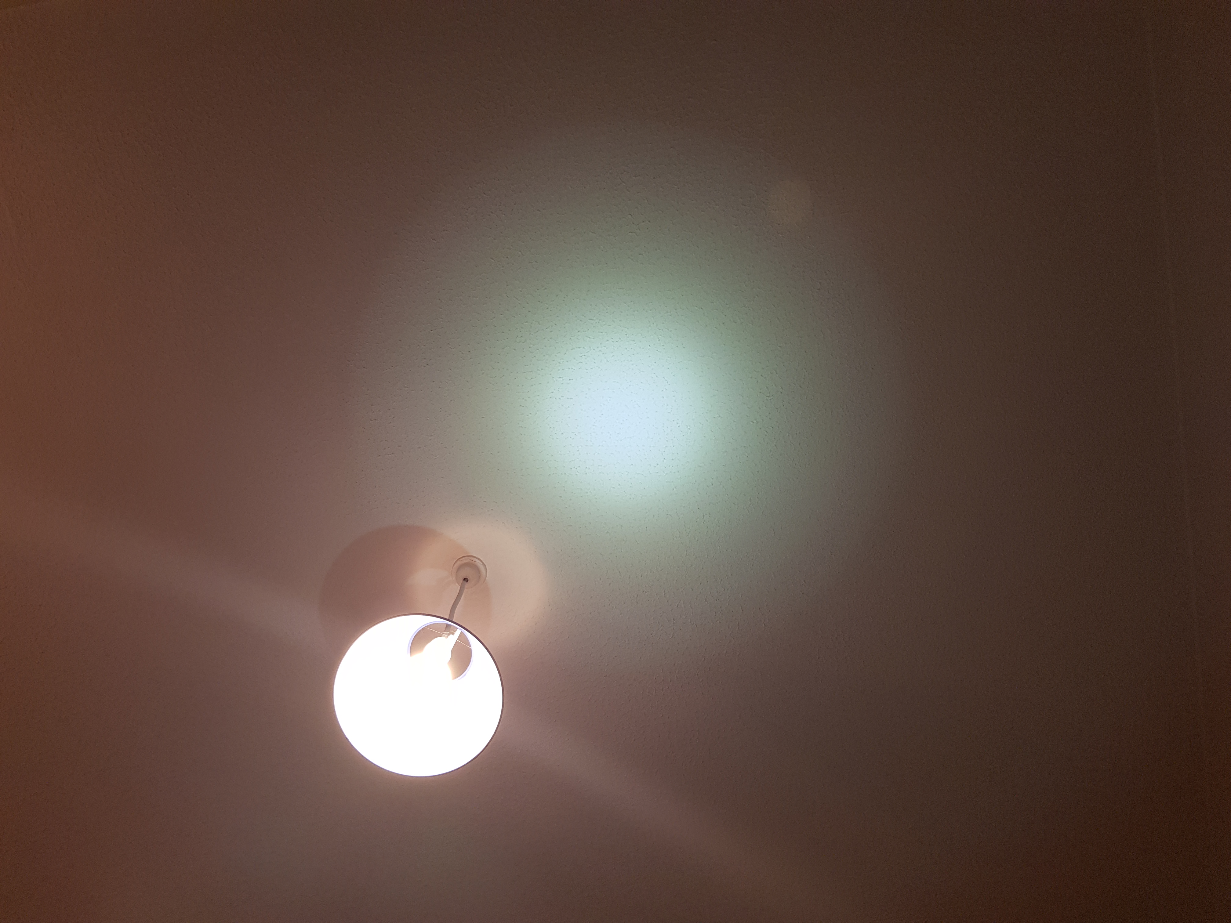

Really don't know how to use this phone's camera for some decent results if even possible, but this is the best I could do for now.. also, this time, the beam actually looks better in person and also no banding.
That's only the corona and the hotspot, the spill is not visible at this level (Low - 50LM) against the ceiling lamp (had to keep it near a similarly bright light source, because of my phone's camera narrow levels range.. )
Also there seems to be a heavy magenta tinge overall (judging by the ceiling, which it's quite white.. ) and the tint shift in the corona it's exaggerated towards a light teal, when in fact it's more like a creamy yellow and less pronounced.. The tint shift in the corona seems to be a bit washed out compared to the original, before sanding the dome, that must be just a side effect of the whole emitter surface area being better "blended", with no sharp contrast and defined shapes, basically, just your "average Gaussian blur" effect.

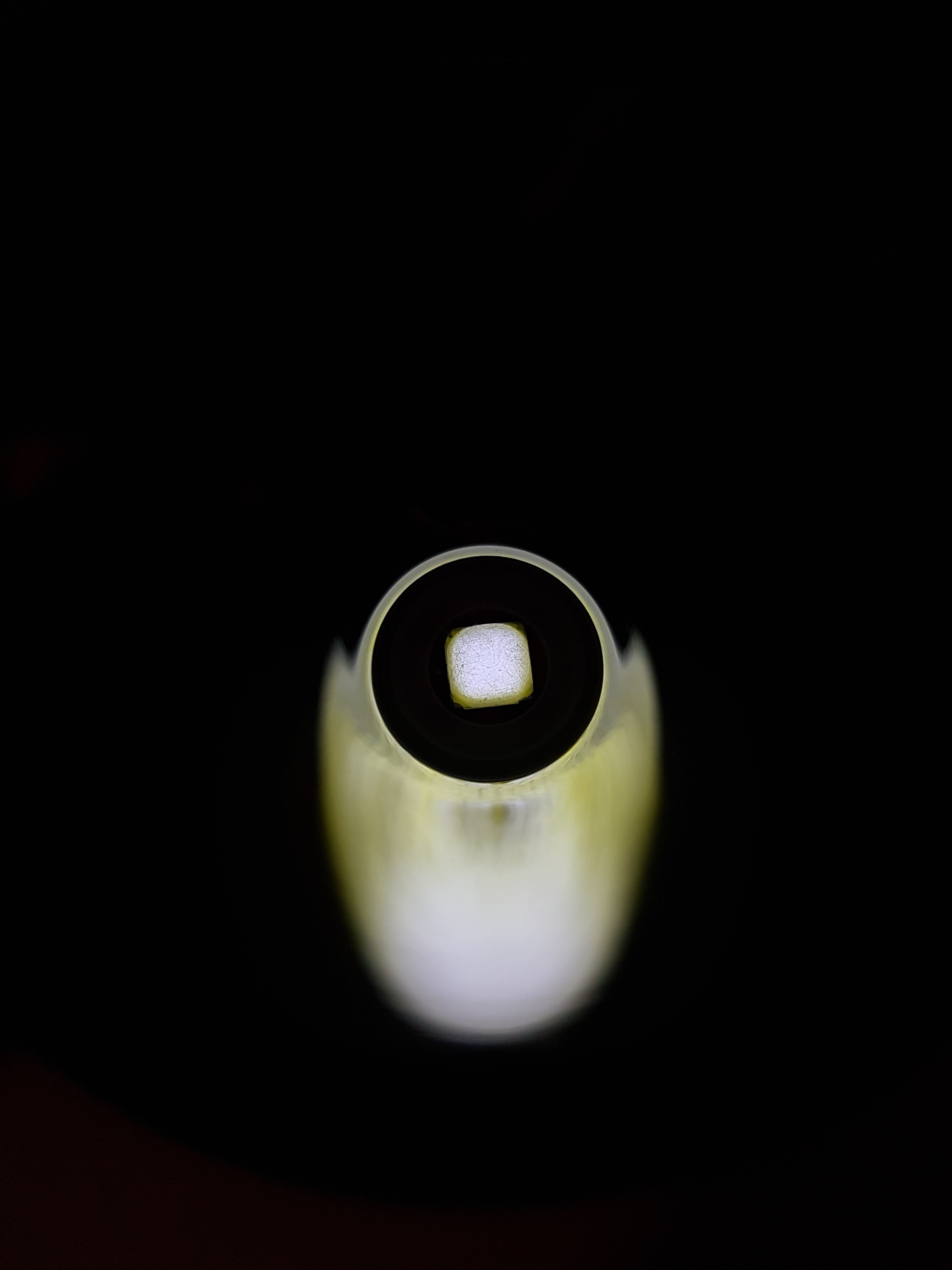

Tried my best to take some pics of the emitter at the lowest set ML mode (should be 1LM according to specs.. )
Wish I'd had a small fine sandblaster.. ^^ Or maybe is the dome getting foggy if wiped with Acetone.. ?? Like some plastics are.. ? I'd imagine not :|
